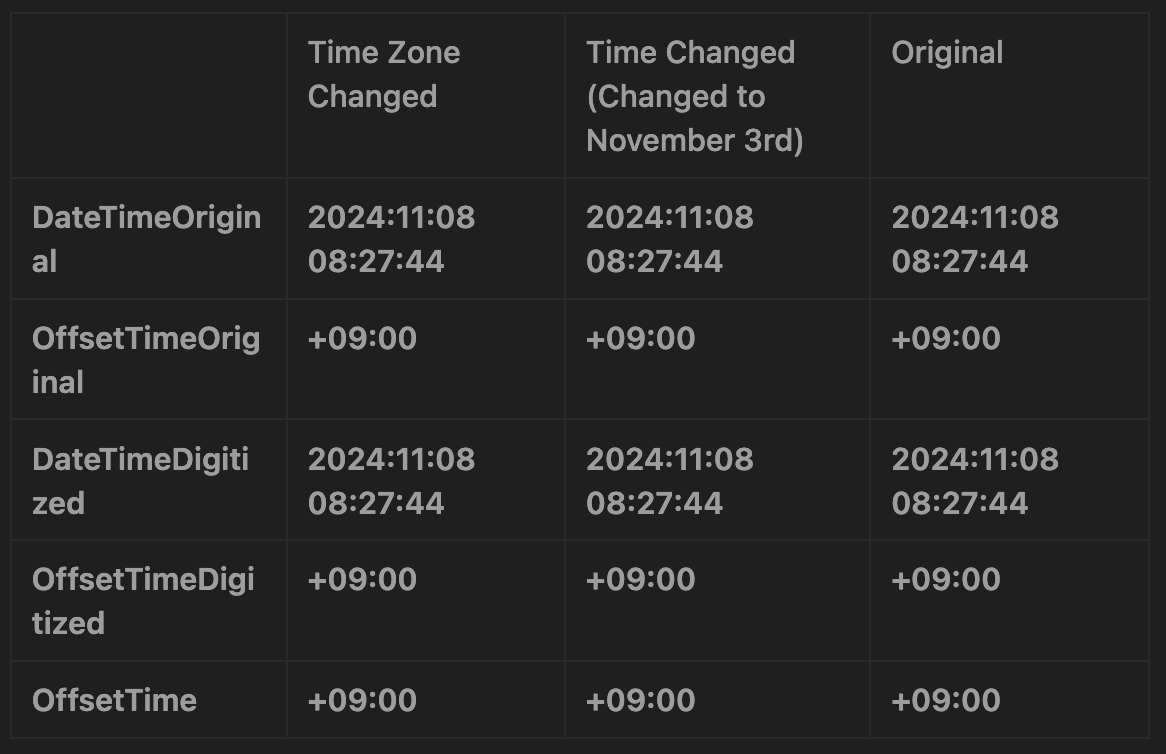

The time or time zone of an image is changed in the Photos app. Changing the time zone of an image with an actual capture date of 2024:11:08 08:27:44 → 2024:11:07 17:27:44
Image data is extracted from a PHAsset using PHImageManager. The metadata is obtained from this image data. The time zone information exposed in the Exif tag information does not reflect the time or time zone changed in the Photos app.
let asset: PHAsset = ...
let options = PHImageRequestOptions()
options.isSynchronous = true
options.version = .current
options.deliveryMode = .highQualityFormat
options.resizeMode = .none
options.normalizedCropRect = .zero
options.isNetworkAccessAllowed = true
options.progressHandler = { progress, error, _, _ in }
PHImageManager.default().requestImageDataAndOrientation(for: asset, options: options) { imageData, uti, orientation, info in
    let cgImageSource = CGImageSourceCreateWithData(imageData! as CFData, nil)
    let properties = CGImageSourceCopyPropertiesAtIndex(cgImageSource!, 0, nil) as? Dictionary<String, Any>
    let exif = properties!["{Exif}"]
    let dictionary = exif as? Dictionary<String, Any>
Metadata Check
In this case, it is reflected in the creationDate of PHAsset, so it can be somewhat compensated by forcibly replacing the metadata. However, because PHAsset does not include time zone information, when changing the time zone as well, it's impossible to calculate the correct time according to the time zone.

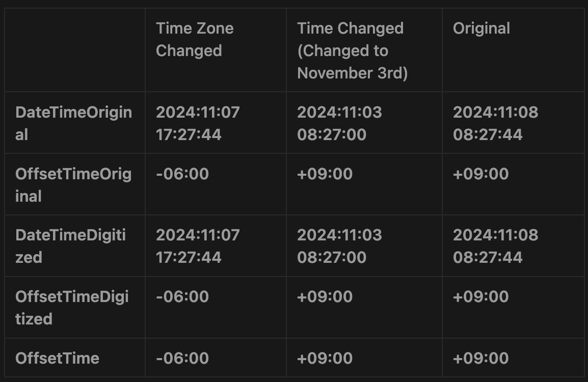

PHPicker
This issue is resolved when using the PHPickerResult provided by PHPicker.
extension PhotosPickerViewController: PHPickerViewControllerDelegate {
	  public func picker(_ picker: PHPickerViewController,
										  didFinishPicking results: [PHPickerResult]) {
		  for result in results {
				  let identifier = UTType.image.identifier
          if result.itemProvider.hasItemConformingToTypeIdentifier(identifier) {
              result.itemProvider.loadDataRepresentation(forTypeIdentifier: identifier) { data, error in
                  guard let data = data,
                        let cgImageSource = CGImageSourceCreateWithData(data as CFData, nil),
                        let properties = CGImageSourceCopyPropertiesAtIndex(cgImageSource, 0, nil) as? Dictionary<String, Any>,
                        let exif = properties["{Exif}"],
                  else {
                      return
Metadata Check
