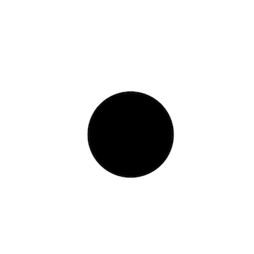

This is how the animation looks:

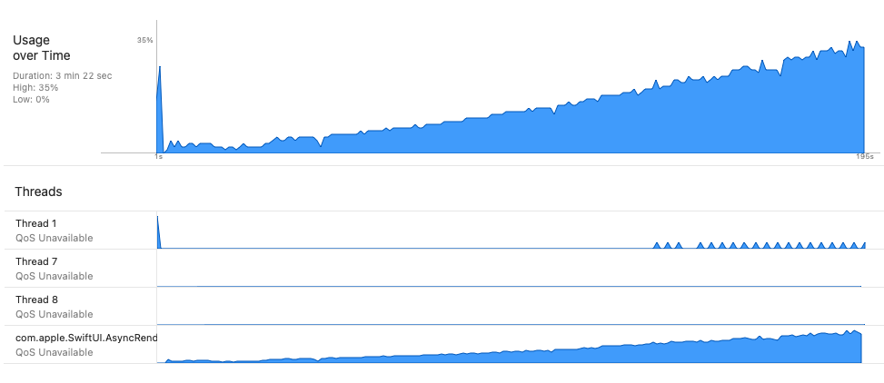

The animation is snappy until the CPU use reaches 95%, at which point there is visible stuttering. Here is how the CPU looks when the animation duration value is 0.5 seconds and the timer publishing interval is 3 seconds:

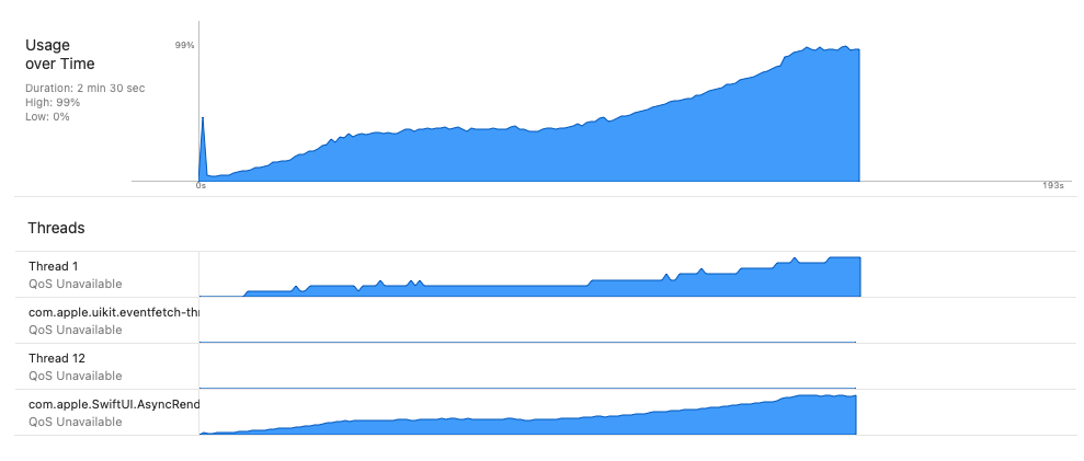

Changing the animation duration value to 0.25 seconds and the timer publishing interval to 0.5 seconds changes the CPU use as follows:

The problem is repeatForever. Please see my post and answer on Stack Overflow for more information.
