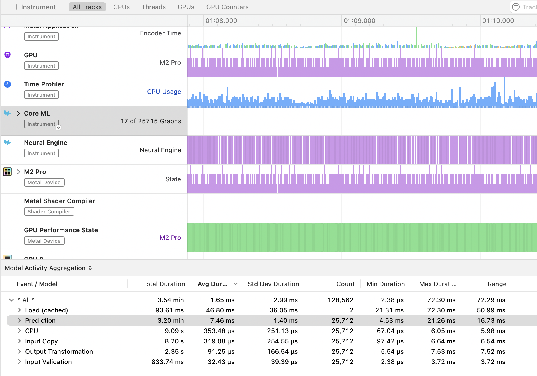

Hi, I found when continuously predicting with the same Core ML model in 120 FPS will be faster than in 60 FPS.
I use Macbook Pro M2 and turn on ProMotion to run Core ML model prediction with a 120 FPS video, the average prediction time is 7.46ms as below:

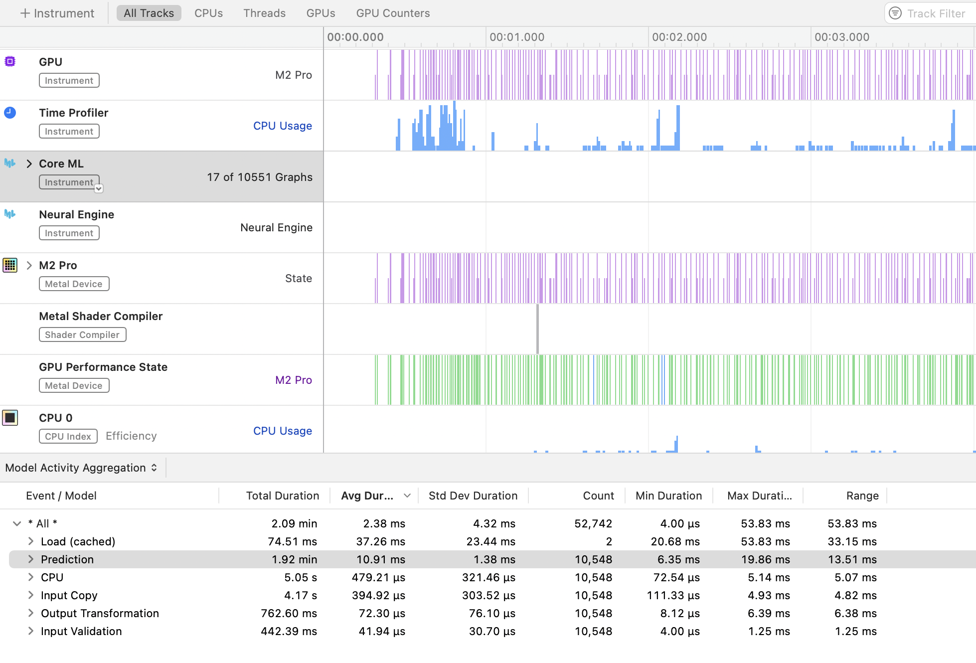

But when I turn off ProMotion, set 60 Hz refresh rate, and run Core ML model prediction with a 60 FPS video, the average prediction time is 10.91ms as below:
What could be the technical explanation for these results? Is there any documentation or technical literature that addresses this behavior?
