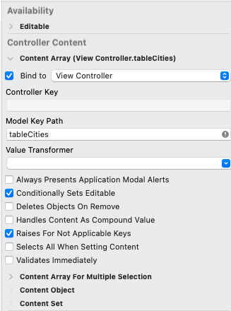

So in storyboard I created an NSArrayController and tried to set its "Model Key Path" to my NSMutableArray as shown below:

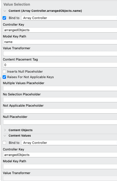

Then I tried to bind the NSPopUpButton to the NSArrayController as follows:
but it doesn't work either, a city is added but the NSPopUpButton isn't displaying anything, what gives?

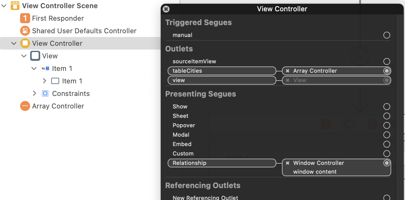

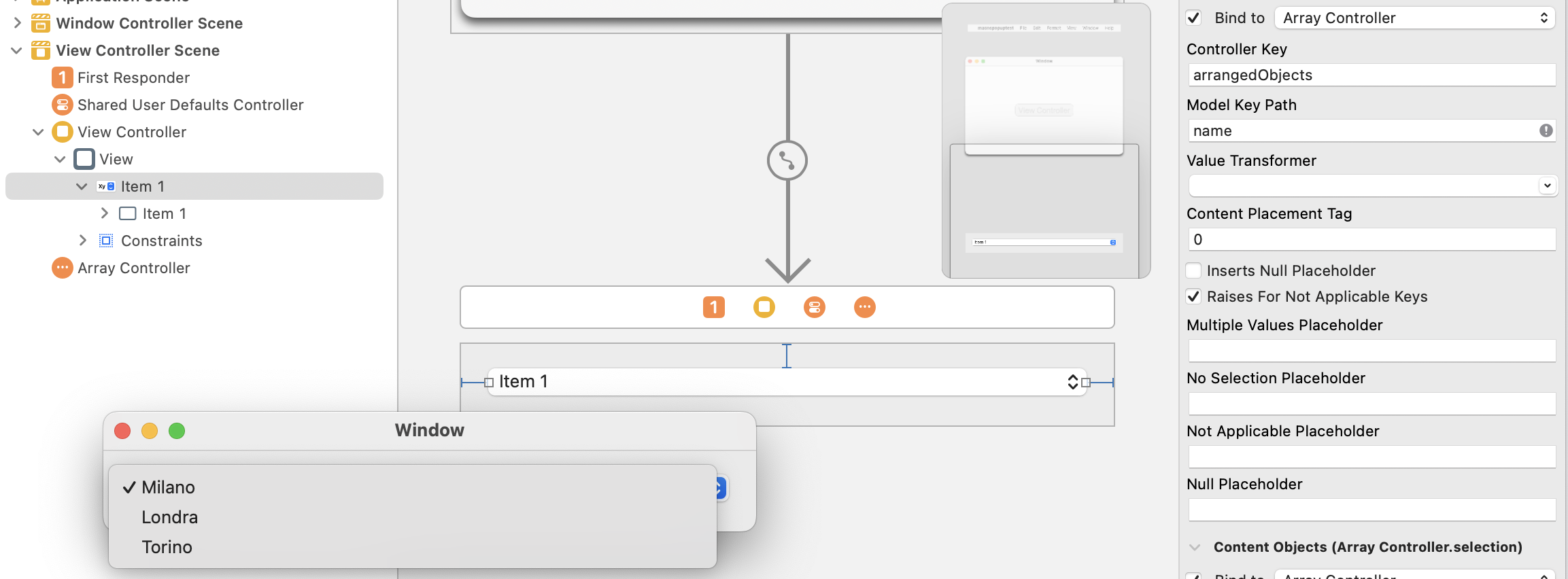

Hi @that_aint_it_chief , probably it's not clear to me your project, but if you want to use an nsarraycontroller, you should work directly on it, without other data model.
For example, you could use this arrangement:
@interface ViewController : NSViewController
@property IBOutlet ArrayController * tableCities;
@end
@implementation ViewController
- (void)viewDidLoad {
[super viewDidLoad];
NSString* filePath = @"/tmp/city_test.jpeg";
NSDictionary *obj = @{@"image": [[NSImage alloc] initByReferencingFile:filePath],
@"name": @"Milano",
@"filePath": filePath};
NSDictionary *obj2 = @{@"image": [[NSImage alloc] initByReferencingFile:filePath],
@"name": @"Londra",
NSDictionary *obj3 = @{@"image": [[NSImage alloc] initByReferencingFile:filePath],
@"name": @"Torino",
[_tableCities addObjects:@[obj, obj2, obj3]];
@end
create an NSArrayController inside the ViewController scene you are developing and link directly to arrangeObjects and model type on inspector tab, as attached screenshots.
Bye Rob

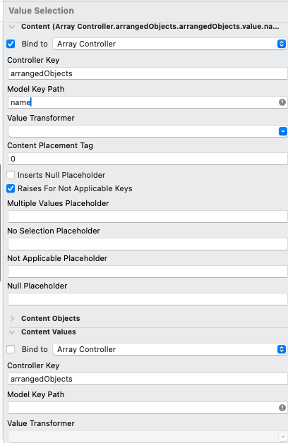

Please ignore the last image, here's the image showing the binding of the NSPopUpButton:
problem still persists tho

never mind, you were right, thanks
