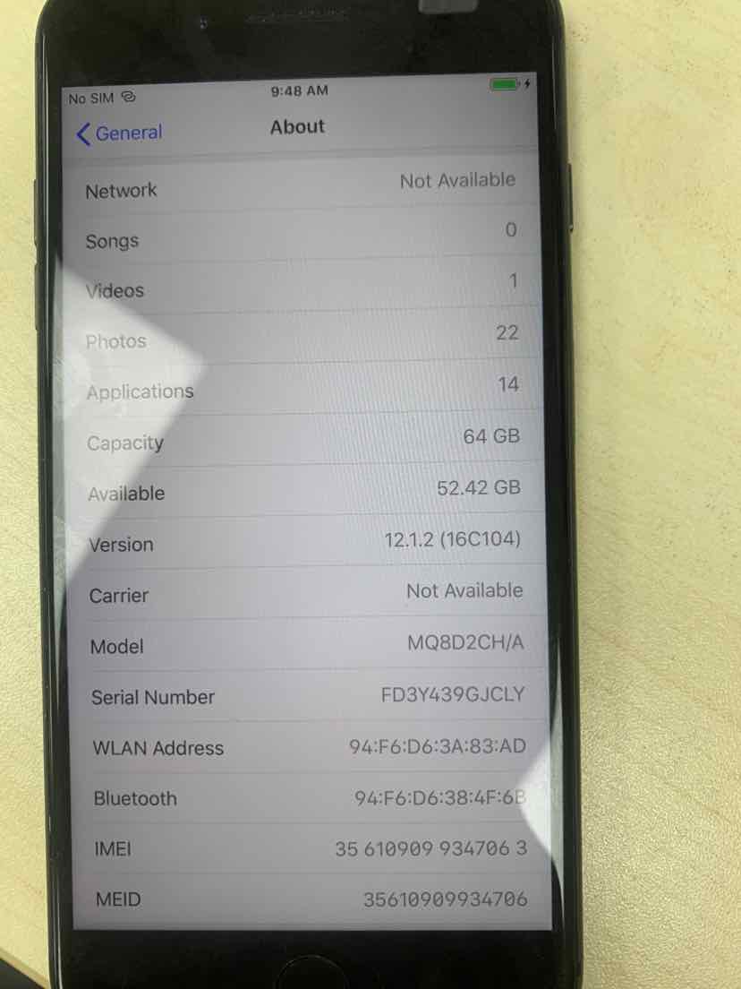

device information:

I tested many devices and the results are as follows:
Thanks for showing your test results. Can you provide more information about what kinds of tests you used? What kinds of error messages/diagnostic information were you able to find in the case where your tests failed?

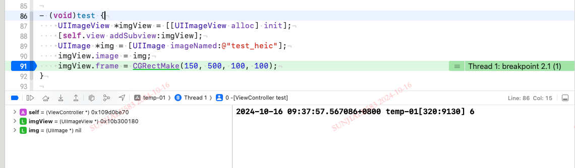

This is my test code:
UIImage *i = [UIImage imageNamed:@"temp"];
NSLog(@"%@", i);
UIImageView *v = [[UIImageView alloc] initWithImage:[UIImage imageNamed:@"temp"]];
[self.view addSubview:v];
v.frame = CGRectMake(50, 150, 300, 200);
iPhone 8 plus, iOS 12.1.1 output:
2024-10-21 11:05:36.699573+0800 temp-02[1226:204265] (null)
other devices outputs:
<UIImage:0x600003014120 named(main: temp) {132.66666666666666, 122} renderingMode=automatic(original)>
In the Xcode project, first decode PNG images and then re encode them into heic images, which can be successfully displayed on iPhone 8 plus and iOS 12.1.2;
Is it a problem with the Mac conversion tool or other issues? Is there a better conversion compatibility solution for PNG to heic? thank you.
