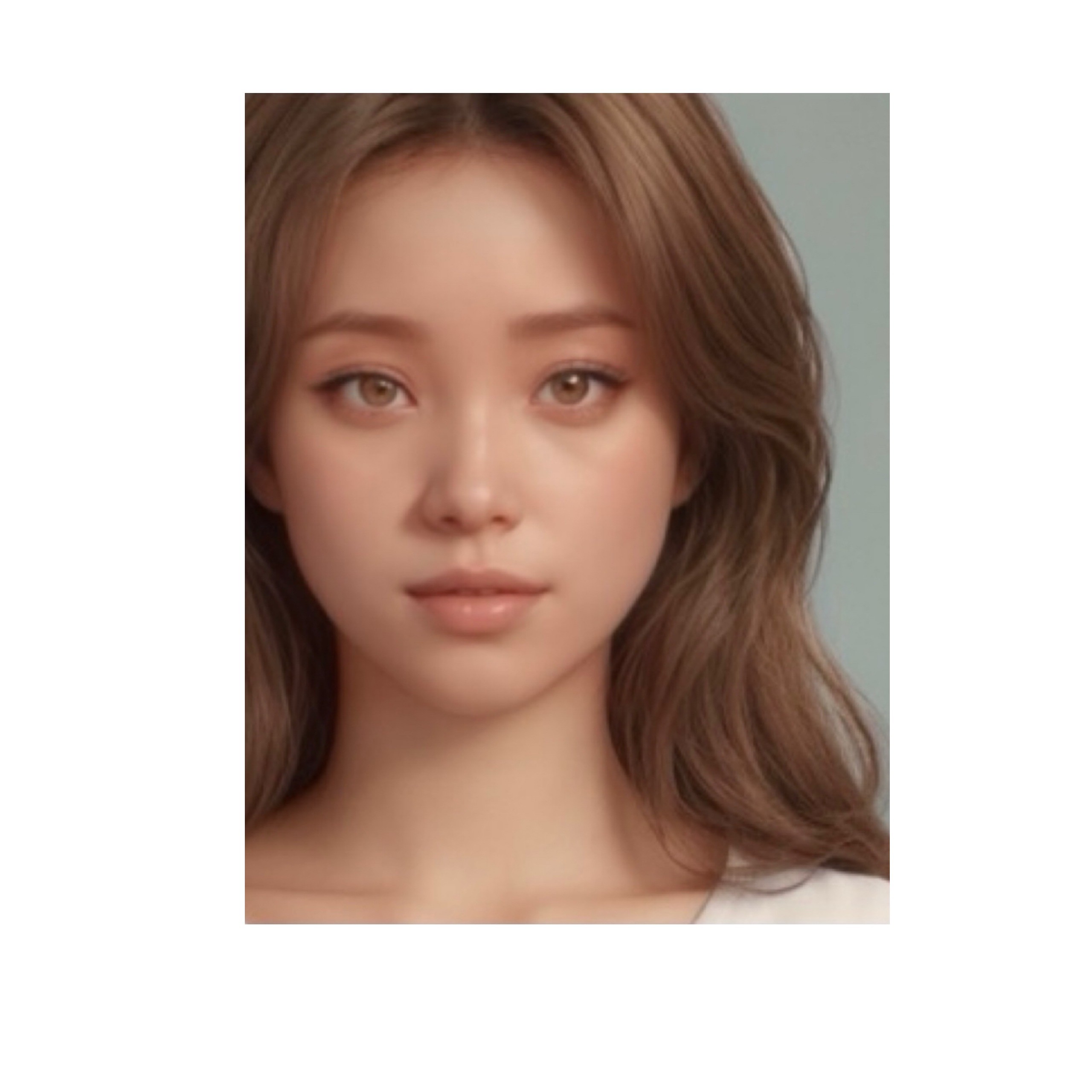

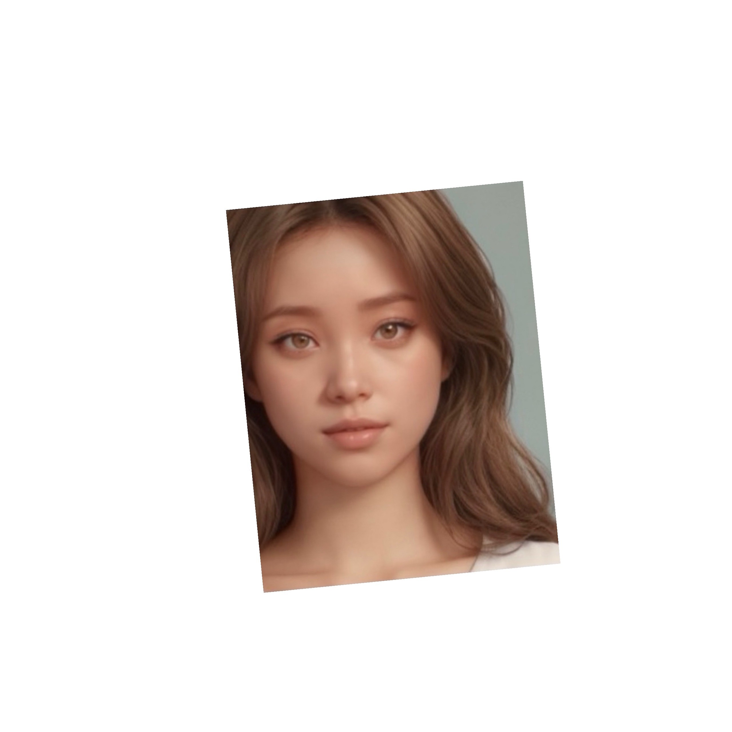

I’ve encountered an issue where a green line appears only in the thumbnail view of an image in the iPhone photo gallery. The green line is not present in the actual image itself.
Here are some additional details:
• The issue occurs only when saving the image as a JPEG. When saved as PNG, the green line does not appear.
The green line also shows up when using the PHAsset method requestImage(for:targetSize:). Depending on the targetSize, the resulting image may contain the green line.
• Interestingly, this issue does not appear on iPhone Xs Max running iOS 15.2.1. However, the green line does appear on iPhone 15 Pro Max running iOS 18.0.1 when viewing the same image.
I have attached the problematic image for your reference.

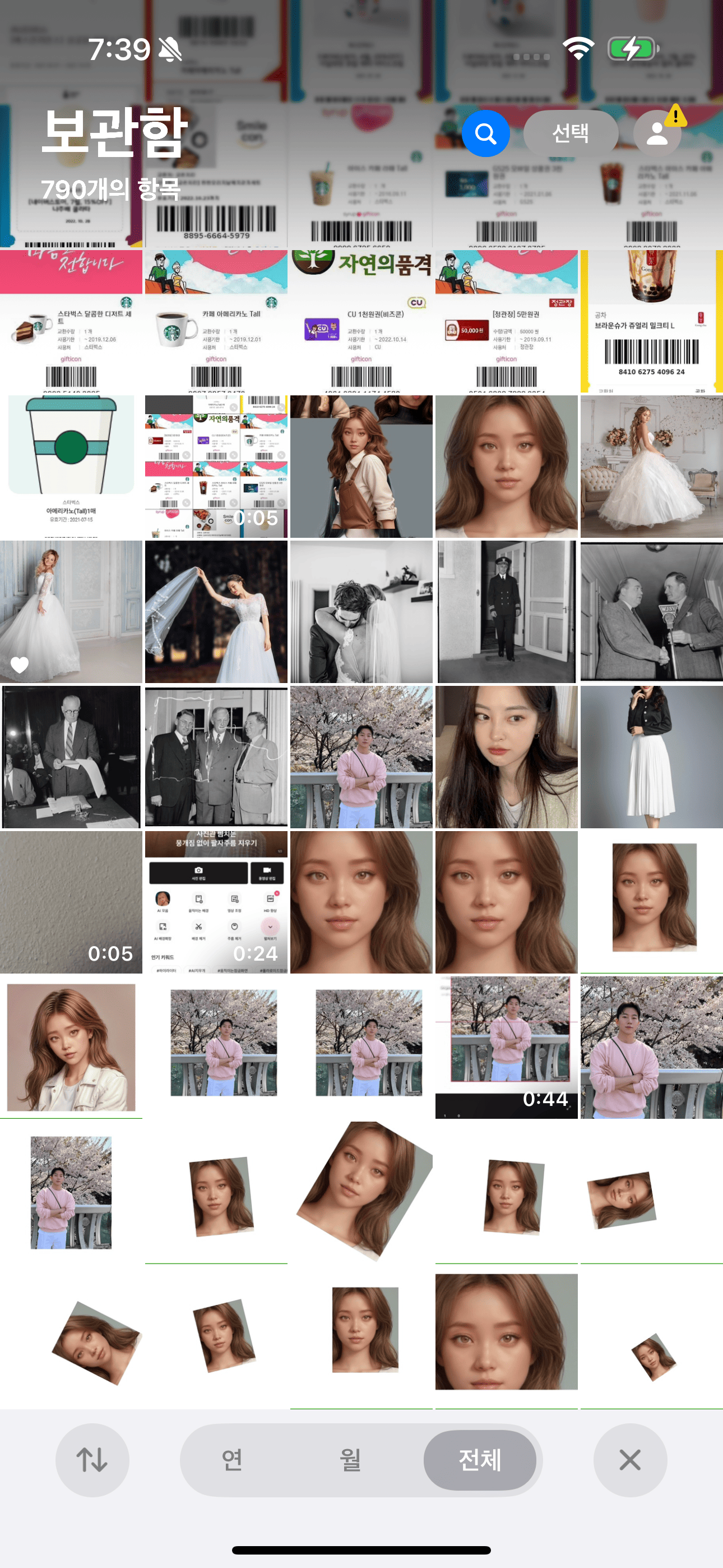

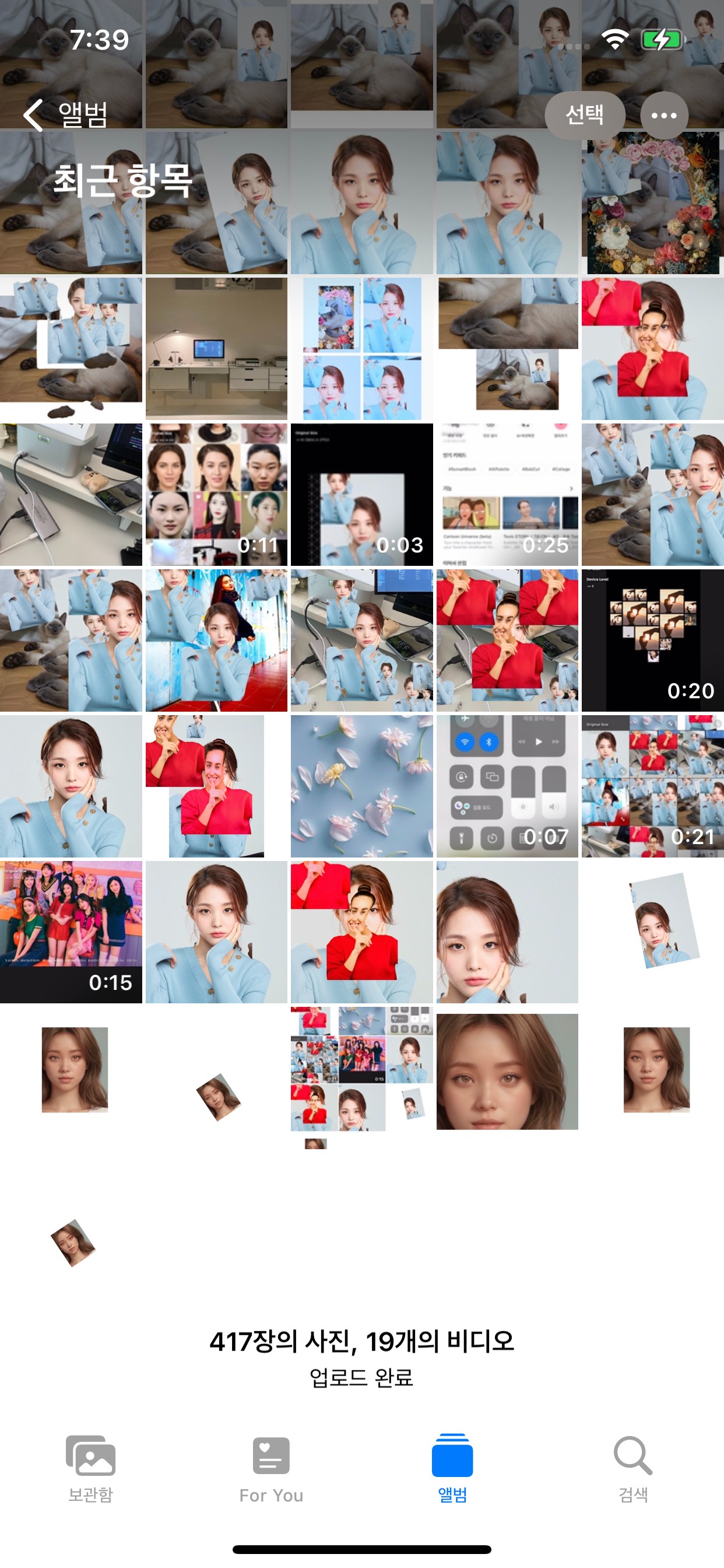

Following images are the screen captures that shows the issue occurring on my iPhone.
iPhone 15 pro max (iOS 18.0.1)
iPhone Xs Max (iOS 15.2.1 )
Could this be related to a display or gallery app issue on iOS? Any advice or solutions would be greatly appreciated.
