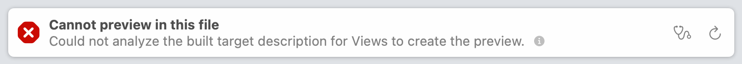

FailedToAnalyzeBuiltTargetDescription: Could not analyze the built target description for Views to create the preview.
Xcode Preview is not working. Successed to build Preview but error message displays like below:
I think it's maybe related with loader path followed by error details below. I created xcproj file using tuist 4.19.0. How can I fix this issue?

I am experiencing the same issue on Xcode 16.1 (16B40), when merged binary is enabled, erroring (redacted my library name with <<X>>):
    |  |  CouldNotParseInput
    |  |  |  FailedParsingMachObjectFile
    |  |  |  MachO data could not be parsed for: <<X>>
    |  |  |  Reason: Underlying failure reading data
    |  |  |  Data header bytes: []
    |  |  |  Data header ASCII: "<nil>"
    |  |  |  |  NSError.NSCocoaErrorDomain.260: The file “<<X>>” couldn’t be opened because there is no such file.
    |  |  |  |  NSCocoaErrorDomain (260):
    |  |  |  |  ==NSURL: <<X>> -- file:///
    |  |  |  |  ==NSFilePath: /<<X>>
    |  |  |  |  |  NSError
    |  |  |  |  |  NSError: Error Domain=NSPOSIXErrorDomain Code=2 "No such file or directory"

Having the same problem in Xcode 16.3, but I'm pretty sure I've figured out the problem.
If there are any relative paths in your linker flags, make sure they start with $(SRCROOT)/ I'm betting that the linker, as being run in Preview, does not have the same current directory as when running for building. Any relative paths will be rooted from that other spot and files will not be found.
So if you've got any of these: "/..", be sure to prefix them with "$(SRCROOT)/"
