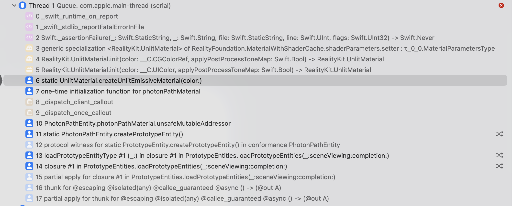

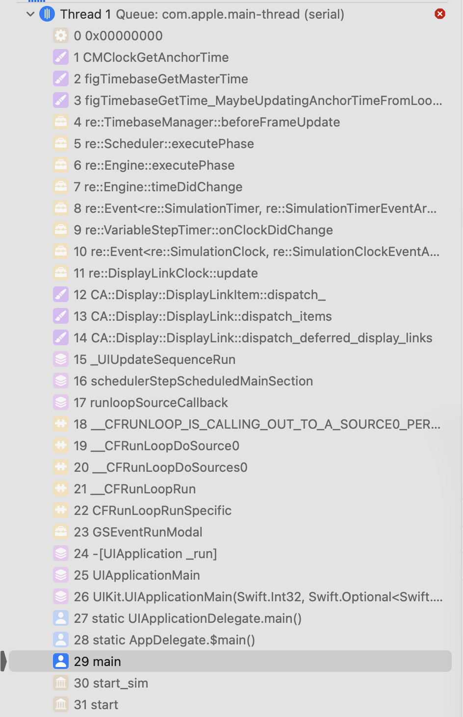

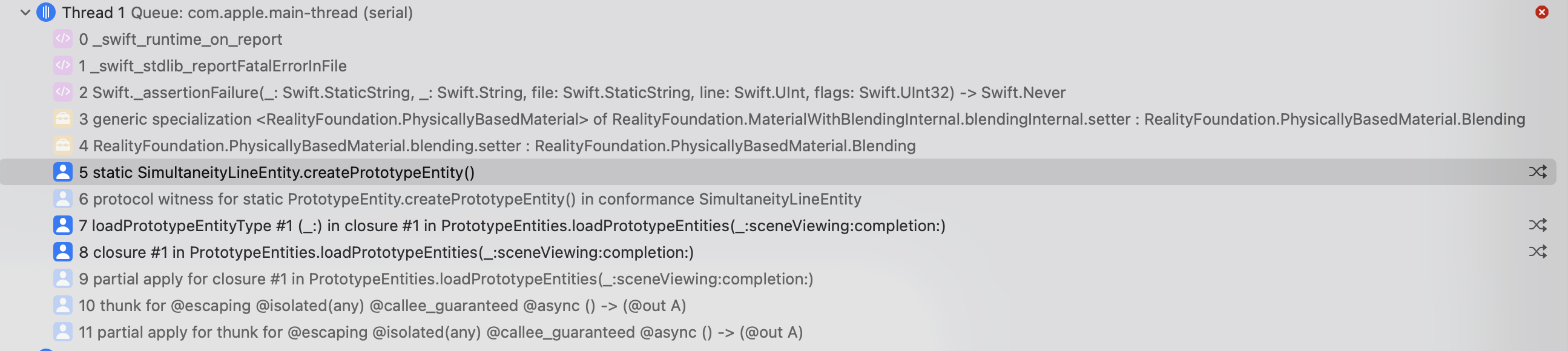

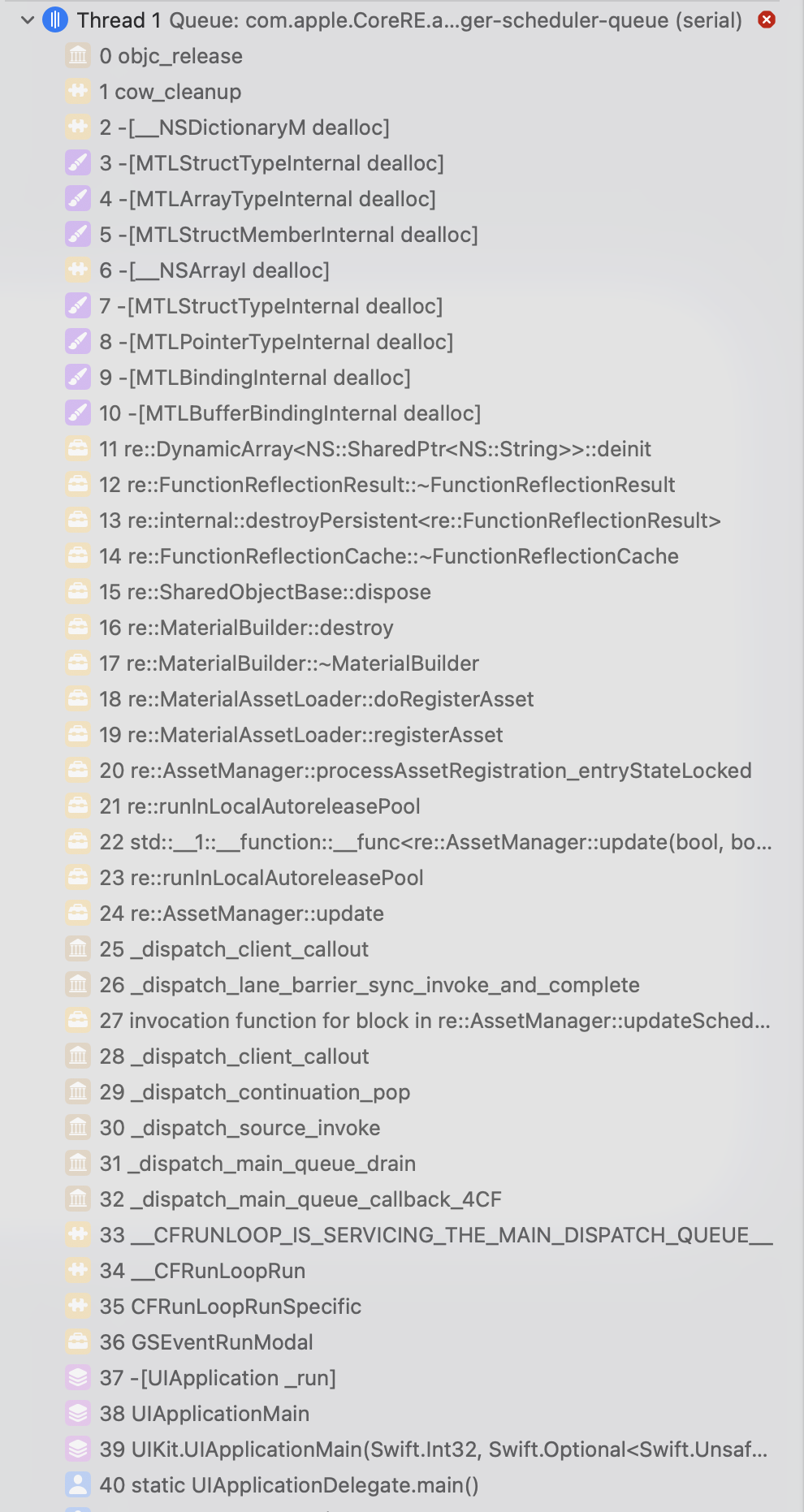

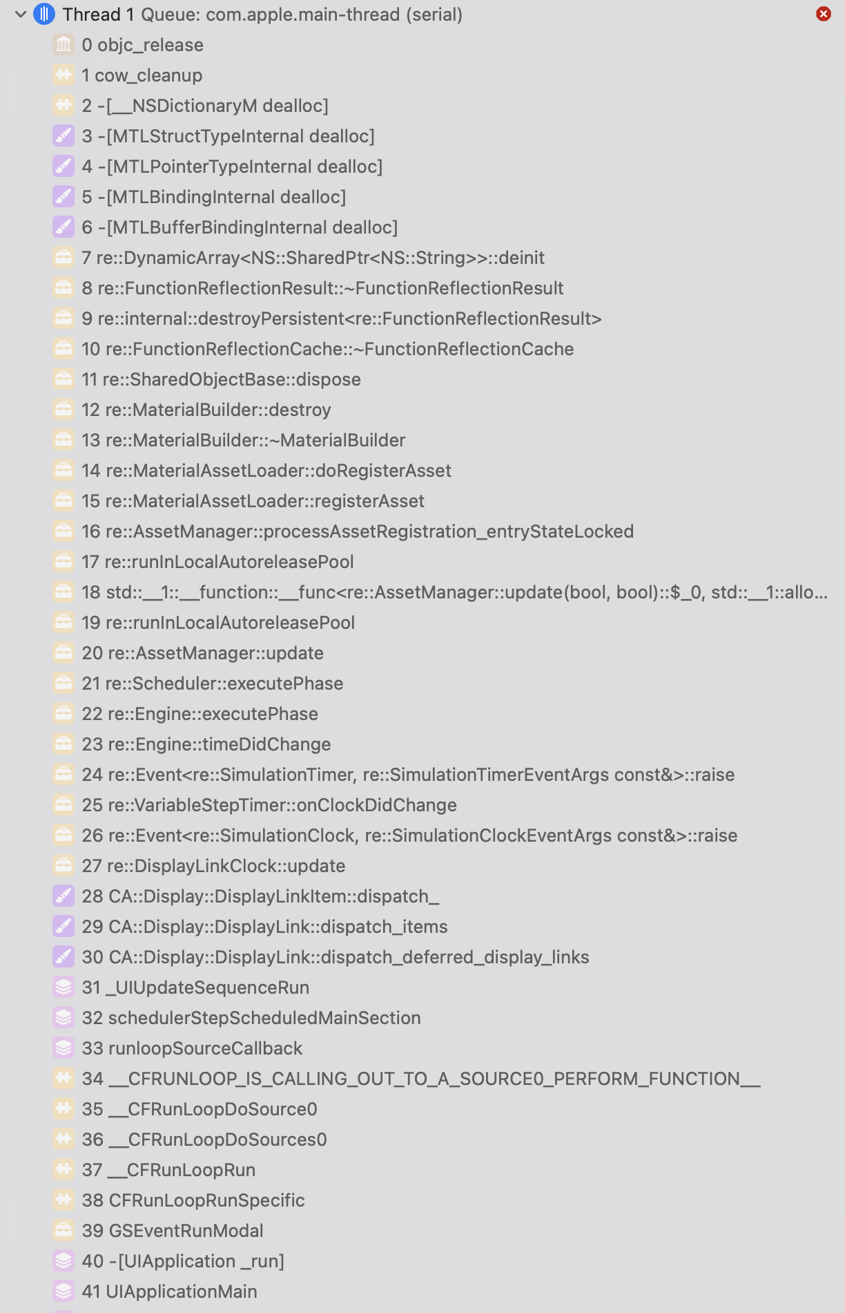

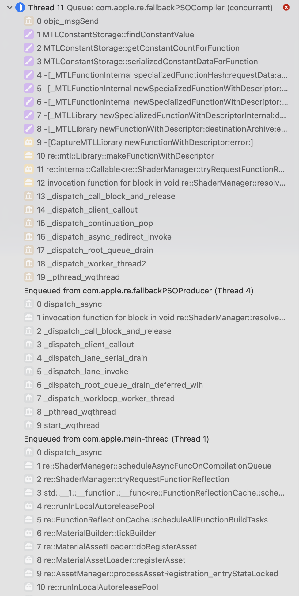

I'm writing a RealityKit/ARKit app that runs on iOS.
Starting with Xcode 16.0 beta 1, at least through Xcode 16.1 beta 2 (16B5014f), in the iOS 18 simulator, my app randomly crashes in about 20% of app sessions the first time it attempts to present an ARView.
The crashes seem to occur at multiple points within RealityKit and Metal.
Below, I've included screenshots of the call stacks of the crashes, which occur as a result of both EXC_BAD_ACCESS and assertion failures within RealityKit.

Most of those crashes have the appearance of zombies, take a look at Investigating crashes for zombie objects.
One of those crash logs does not match the signature of the others (the one with the assertionFailure). In this case, it appears that you set the blending property of a PhysicallyBasedMaterial, and this resulted in an internal assertionFailure. Please file a bug report for this one using Feedback Assistant.
