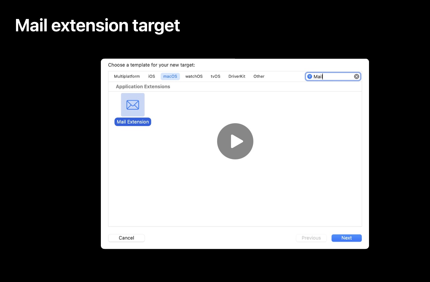

How do I get the MailExtension project template for Xcode?
I am on Xcode Version 16.0 (16A242d) and I am trying to follow the MailKit video.
I don't have the MailExtension template available as shown in the video:
Where do I get it from?
Answered by Engineer in 808207022
That is correct, please let us know if you have additional questions.
OK, never mind. I figured it out. I really want to create an application first and then add a new target to it. The target is a Mail Extension. Hope this helps anyone else just starting out like me.
