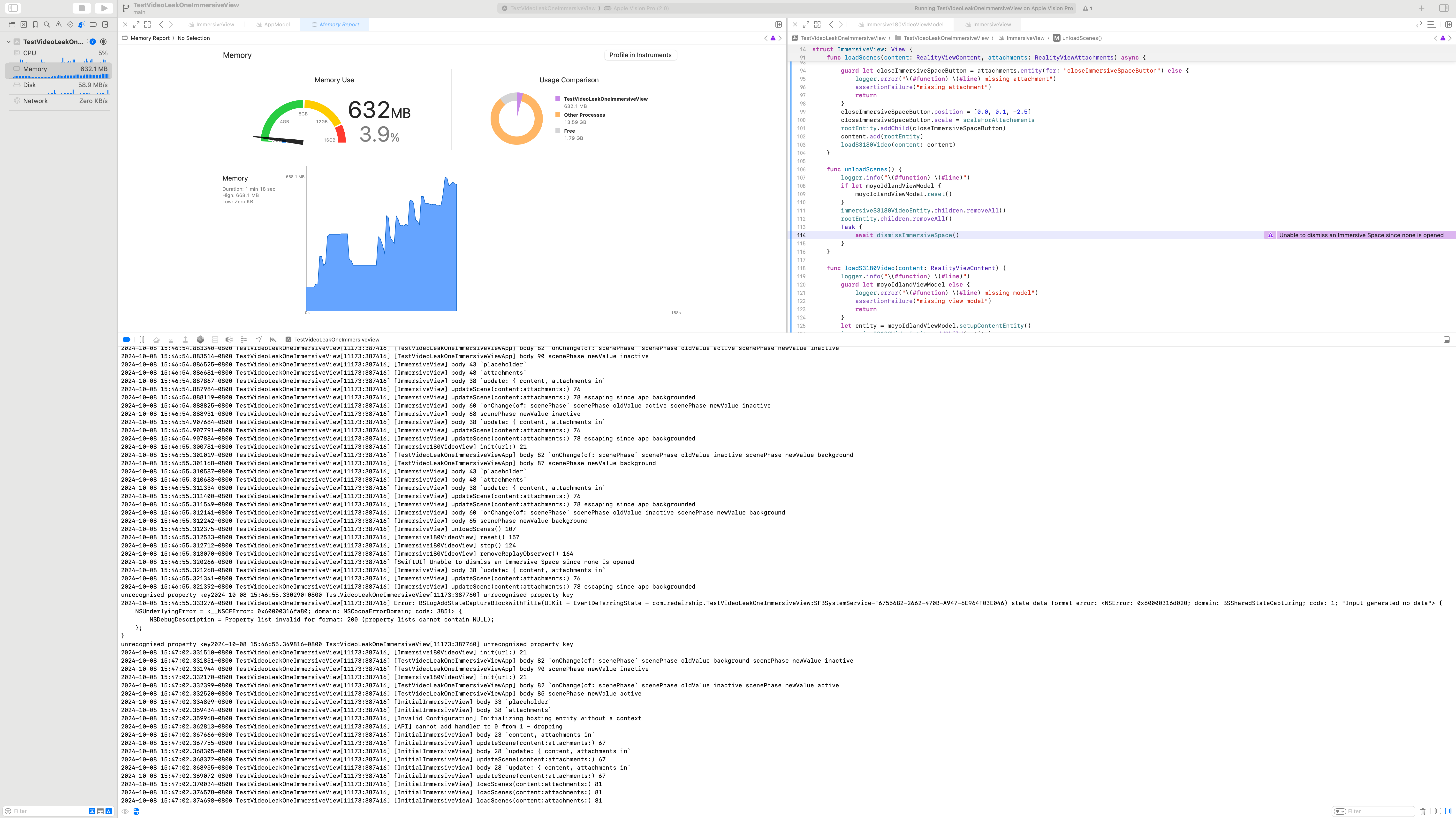

While trying to control the following two scenes in 1 ImmersiveSpace, we found the following memory leak when we background the app while a stereoscopic video is playing.
ImmersiveView's two scenes:
  • Scene 1 has 1 toggle button
  • Scene 2 has same toggle button with a 180 degree skysphere playing a stereoscopic video
Attached are the files and images of the memory leak as captured in Xcode.

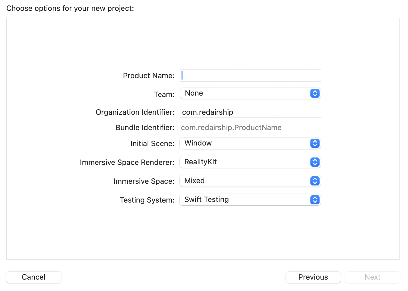

  1. Create a new visionOS app using Xcode template as illustrated below.

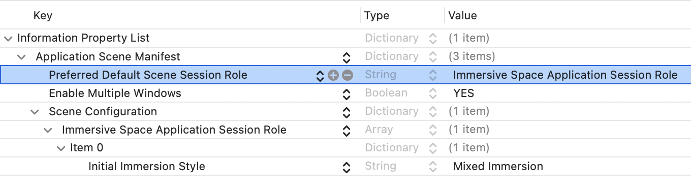

  2. Configure the project to launch directly into an immersive space (set Preferred Default Scene Session Role to Immersive Space Application Session Role in Info.plist.

  6. Display the memory use by pressing on keys command+7 and selecting Memory in order to view the live memory graph

  13. Observe the memory use going up, the graph should look similar to the below illustration.
In ImmersiveView, upon backgrounding the app, I do:
  • a reset method to clear the video's memory
  • dismiss of the Immersive Space containing the video (even though upon execution, visionOS raises the purple warning "Unable to dismiss an Immersive Space since none is opened". It appears visionOS dismisses any ImmersiveSpace upon backgrounding, which makes sense..)
Am I not releasing the memory correctly? Or, is there really a memory leak issue in either SwiftUI's ImmersiveSpace or in AVFoundation's AVPlayer upon background of an app?
