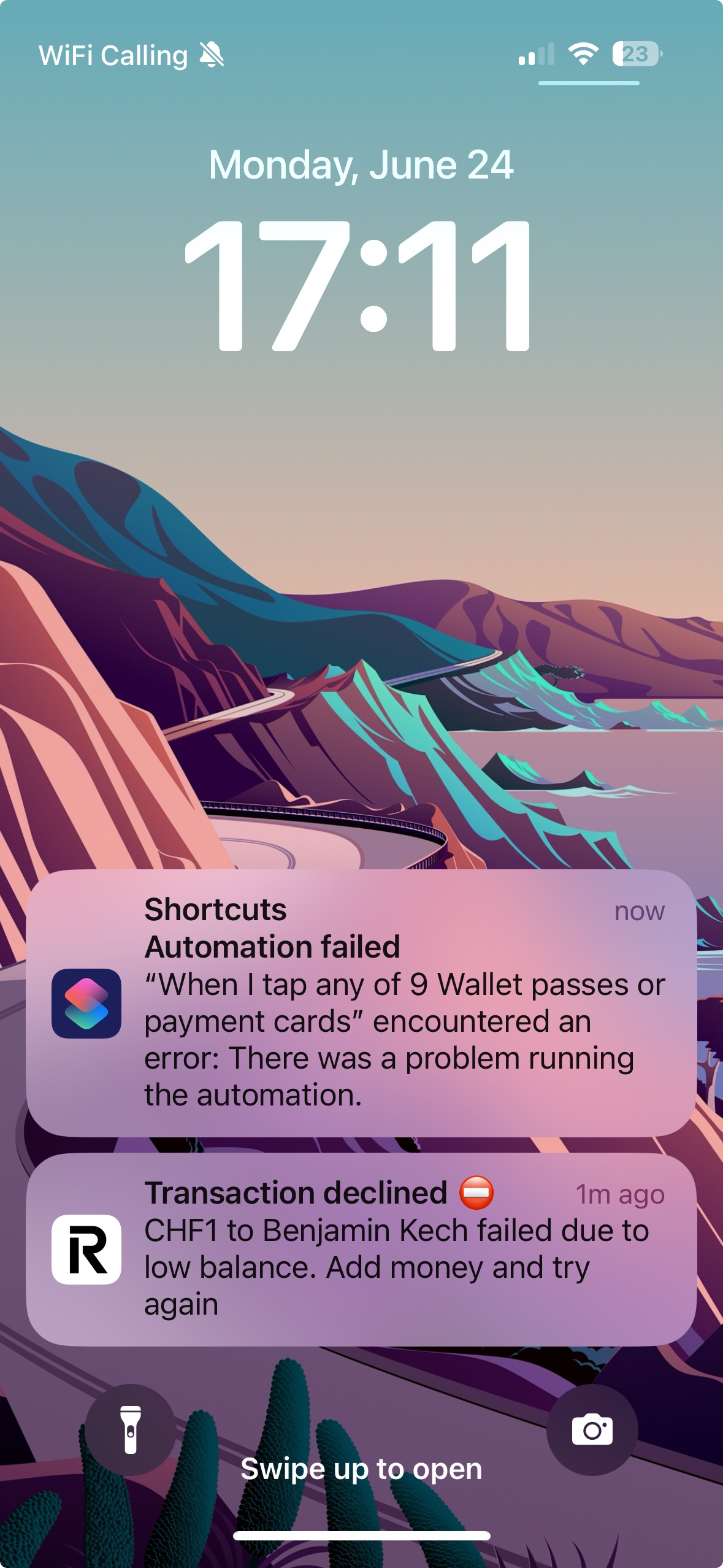

Additionally, the Trigger is activated even when the Transaction is declined.

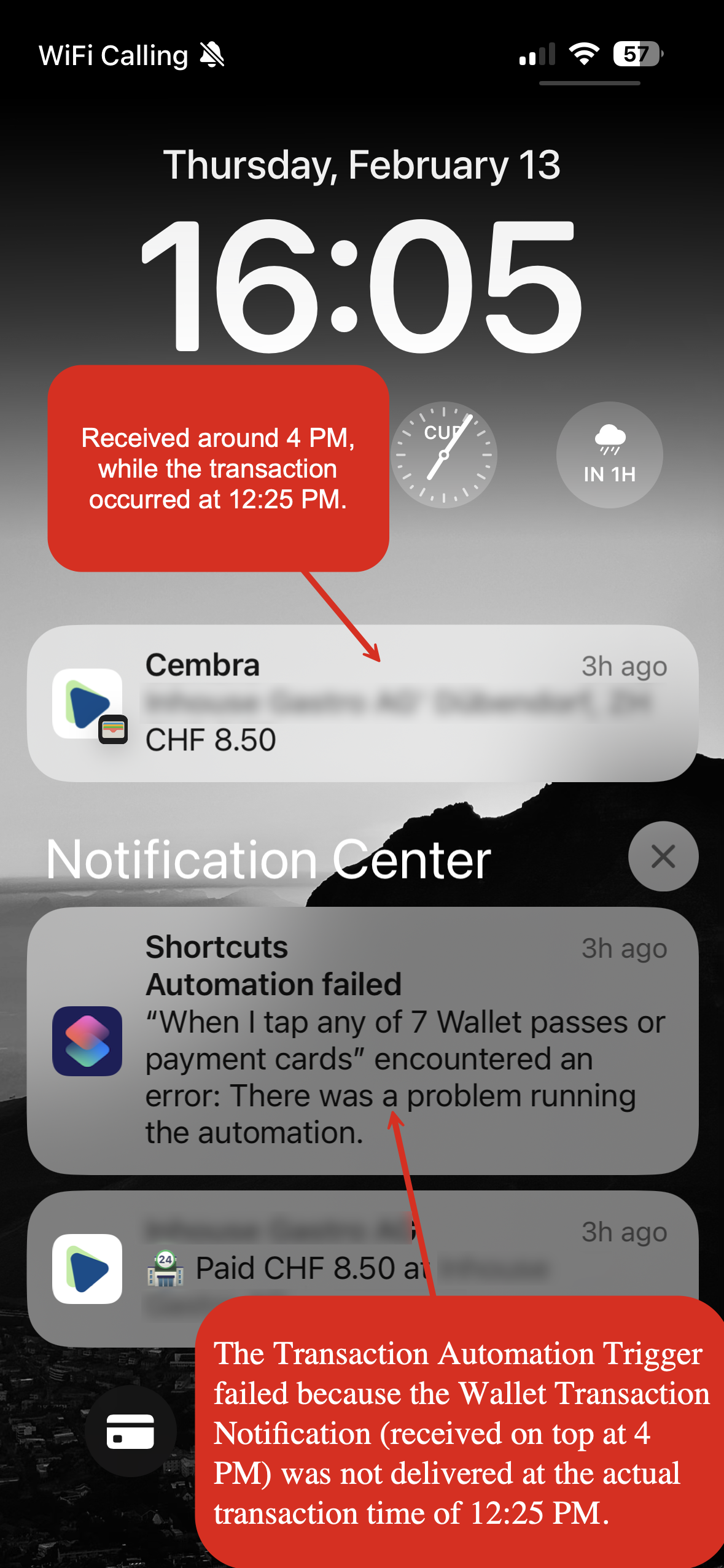

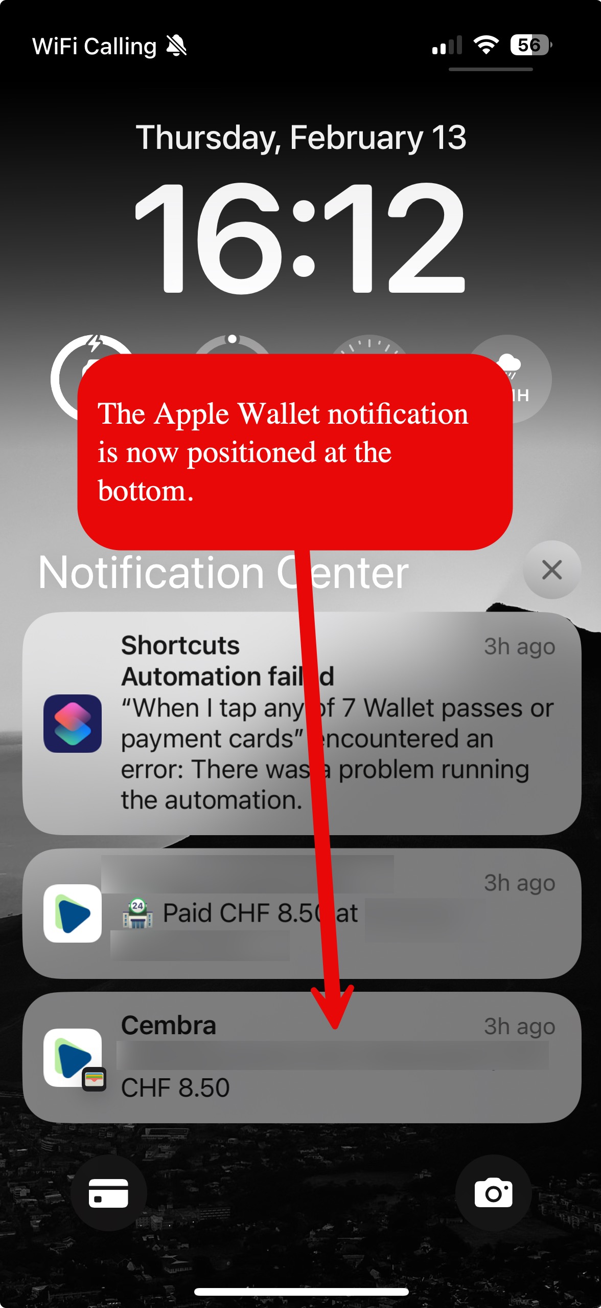

This image visually illustrates the issue: The transaction of CHF 8.50 was executed at 12:25 PM, and the card provider, Cembra, sent a notification. However, the shortcut failed because no Apple Wallet notification for the transaction was received (it timed out while waiting for it).
Around 4 PM, the Apple Wallet transaction notification finally appeared on top.
After some time, the order of notifications was adjusted, even though the Apple Wallet notification arrived three hours late.
