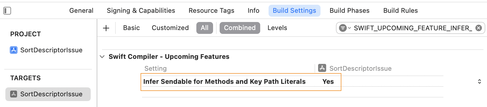

Or, with today’s XCode (16.2), you can turn on the SWIFT_UPCOMING_FEATURE_INFER_SENDABLE_FROM_CAPTURES building setting to calm down the warning, as shown in the attached screenshot, if you are still on Swift 5.
Best,
Ziqiao Chen
Best,
Ziqiao Chen
