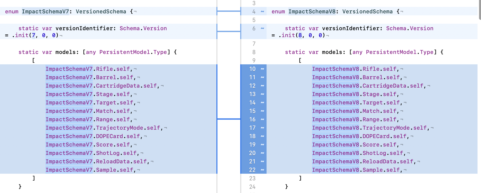

The images below are displaying the only difference between the two schemas:
This is the migration plan:
