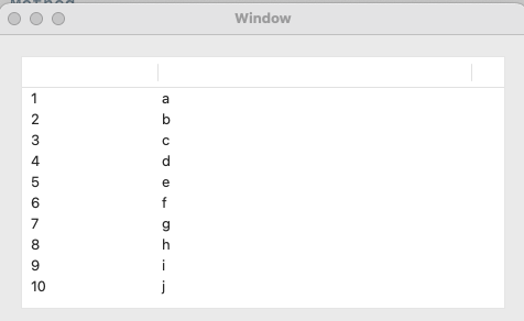

In the storyboard I created a NSTableView and set up the connection, after running it I get what I expected:
okay, cool, but I have a question:
why is this working even though I haven't created a NSTableView as a property for my ViewController or for my TableViewController?
Also, there's another problem, now I want to add a button to this window such that, every time I click it, a new item should be added to this table(for now it can be anything)
So I created a button and a method for this and linked the action to the story board:
-(IBAction) addNewNumber:(id)sender
    [_numbers addObject:@"1234"];
    [_letters addObject:@"testing"];
Now, every time I click this button I can see that this method is indeed being called and that indeed IT IS adding a new member to these arrays, the thing is, the table is not being updated, what gives? Any advice on how I can fix this behavior?
