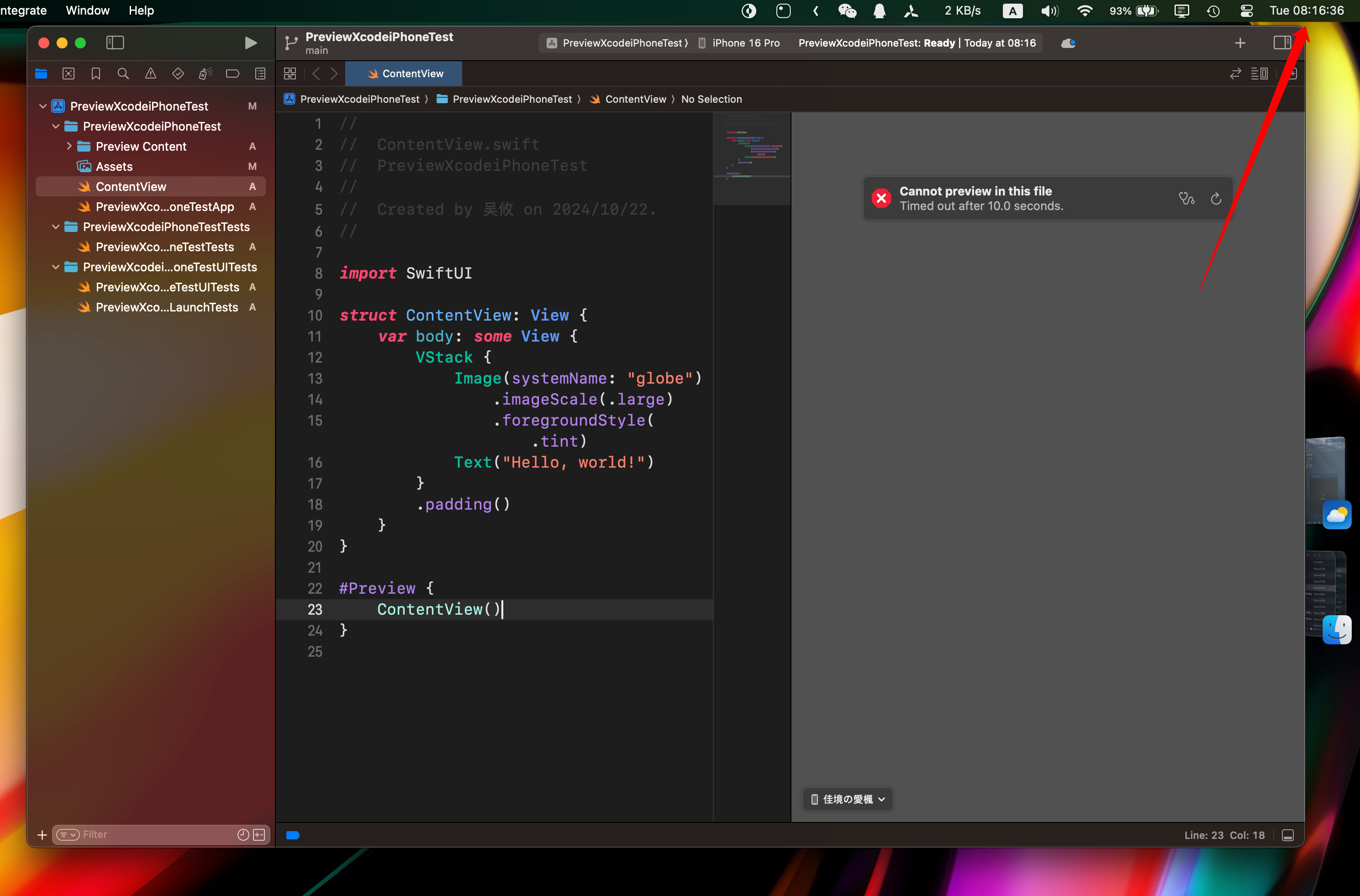

Xcode Canvas preview connected to iPhone error
"Can not preview in this file"
Xcode 16.0 iPhone 14 Pro , iOS 18.0

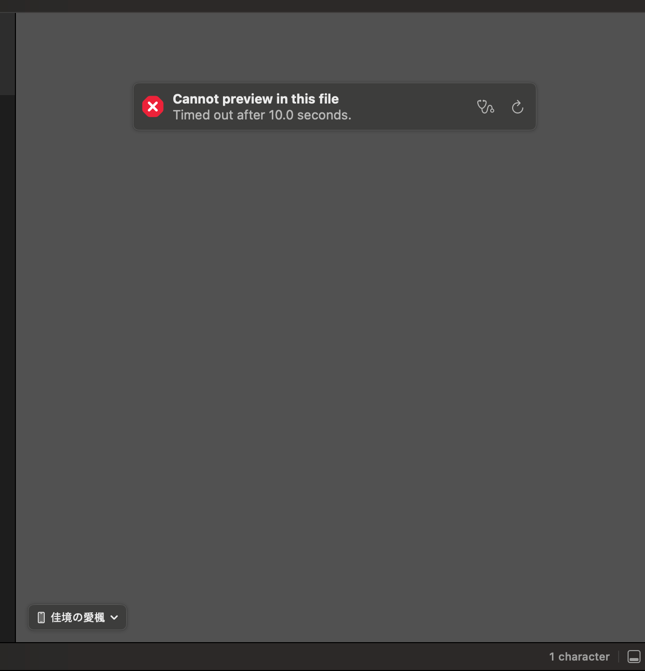

When I choose to start Preview on my iPhone, the canvas screen keeps showing loading circle animation. The iPhone enters the Xcode Previews App but only displays the default screen (Xcode icon& 'Preview from Xcode')
I uploaded the some of diagnostics files

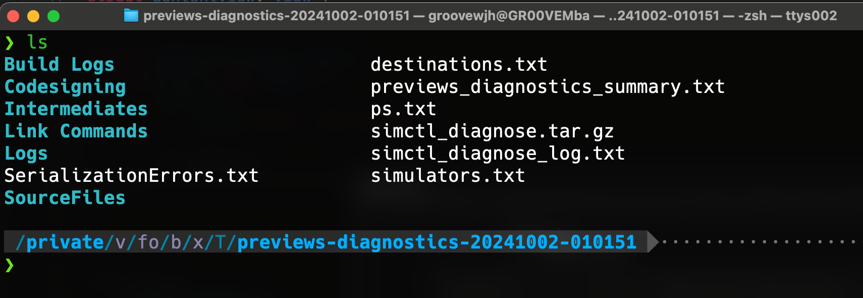

  1. Either (a) an error banner will appear, click the "Diagnostics" button in that banner. Or (b) if you're not seeing an error but you still want to provide diagnostics, you can get the same diagnostics window by going under the Editor menu in the menu bar, then selecting the Canvas submenu, then selecting "Diagnostics".
  2. In the sheet that appears, click "Generate Report" in the bottom left of the sheet
  3. Attach (or make from the folder) the resulting zip file to the bug (will be named something like previews-diagnostics-0123456789.zip)
  4. Generate the sysdiagnose(s) and attach those too

According to your instructions, I recreated the scene: using canvas preview in Xcode 16.0, set to display on my iPhone.

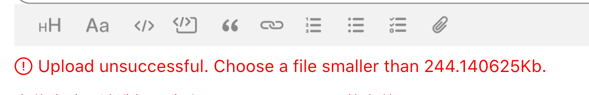

At the same time, I also received two diagnostic files, but due to some strange restrictions on file uploads here, I had to share them with you via OneDrive: https://1drv.ms/f/s!ArbhaqRDUr_1hzoX4ieFho2GFy3F?e=Ws5h38
Thanks for those. I am seeing signs that the simulators on your system are having issues.

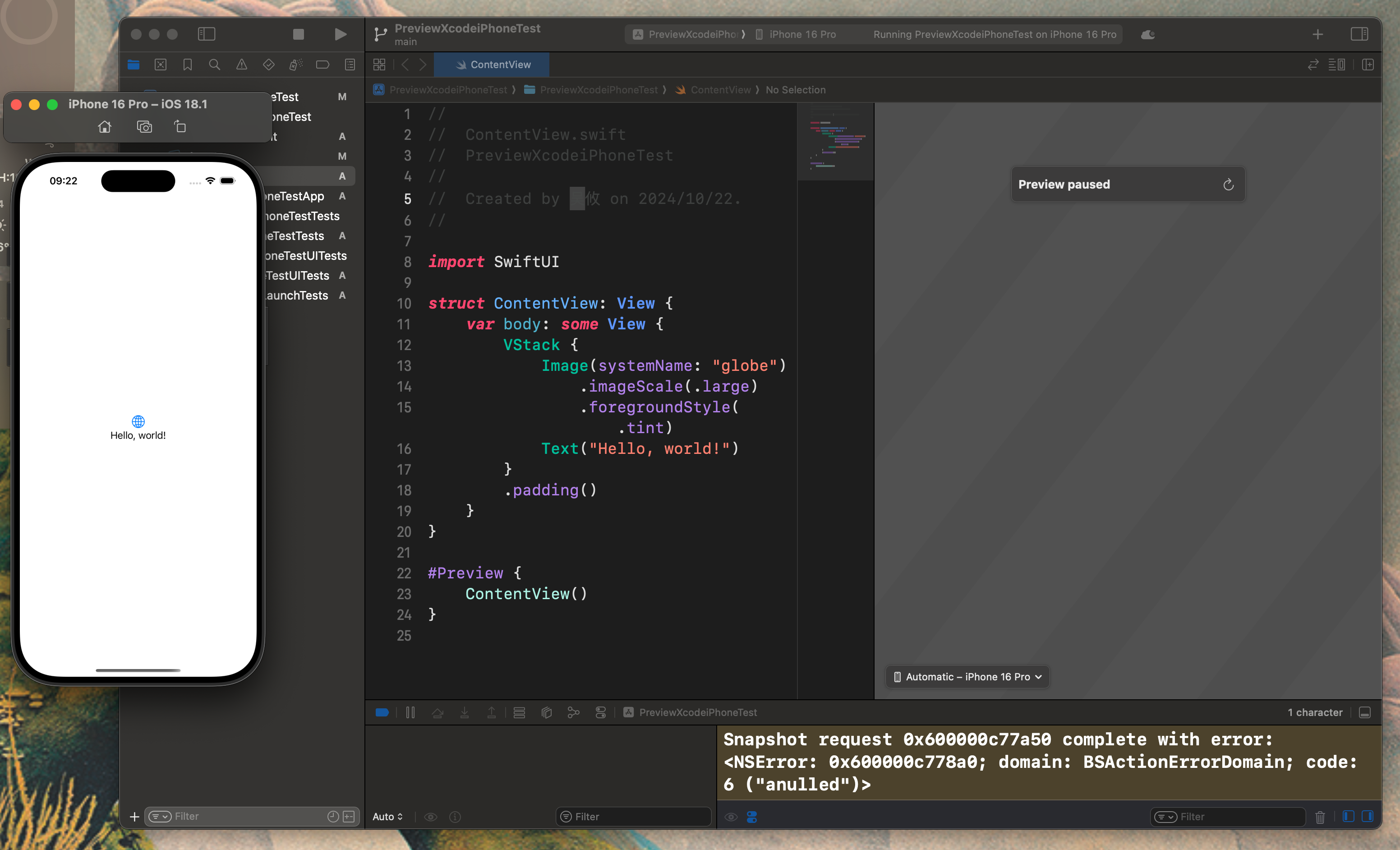

In the project if you select an iPhone Simulator as your run destination and you choose "build+run" (the play button in the app's title/tool bar) does the simulator launch and successfully run your app?
Could you also attempt running this command in Terminal.app xcrun simctl --set previews delete all. This will delete all your current preview's focused sims and allow your xcode to start with a clean slate, which may help in case something has gotten corrupted or in a bad state.

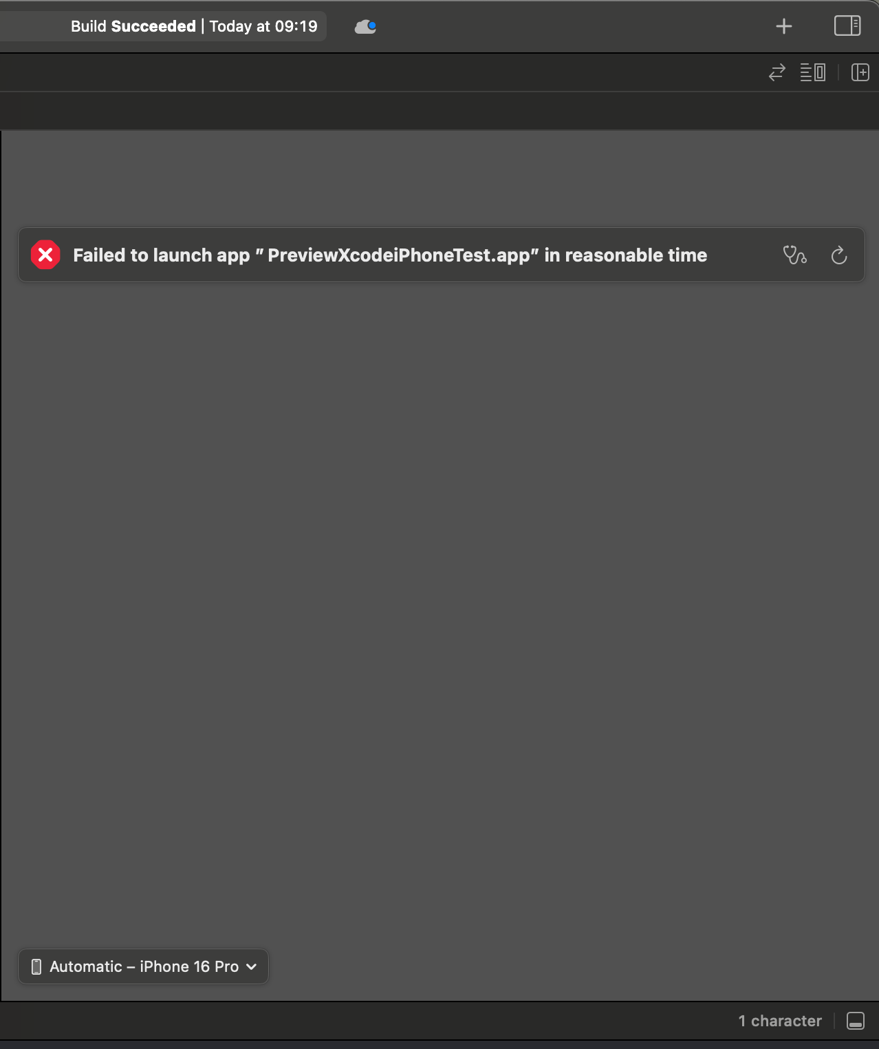

Thank you for your reply After testing, I was able to successfully run the built program in the simulator.
But after I successfully executed xcrun simctl --set previews delete all, the preview interface (simulate iPhone 16) kept spinning icon. Although there were no ongoing tasks in the status bar of the Xcode window (I mean, there were no signs or icons indicating something was being loaded), it still failed.
And when I selected my own phone as the Preview, the original issue still occurred.
Meanwhile, it seems that something crashed, followed by Xcode crashing about 2 minutes later. I received two error messages:

Ah, your project may be hitting a known issue trying to launch the app under preview in certain configurations. We made progress on this in the Xcode 16.1 beta. Are you able to test that out to see if this makes progress?
