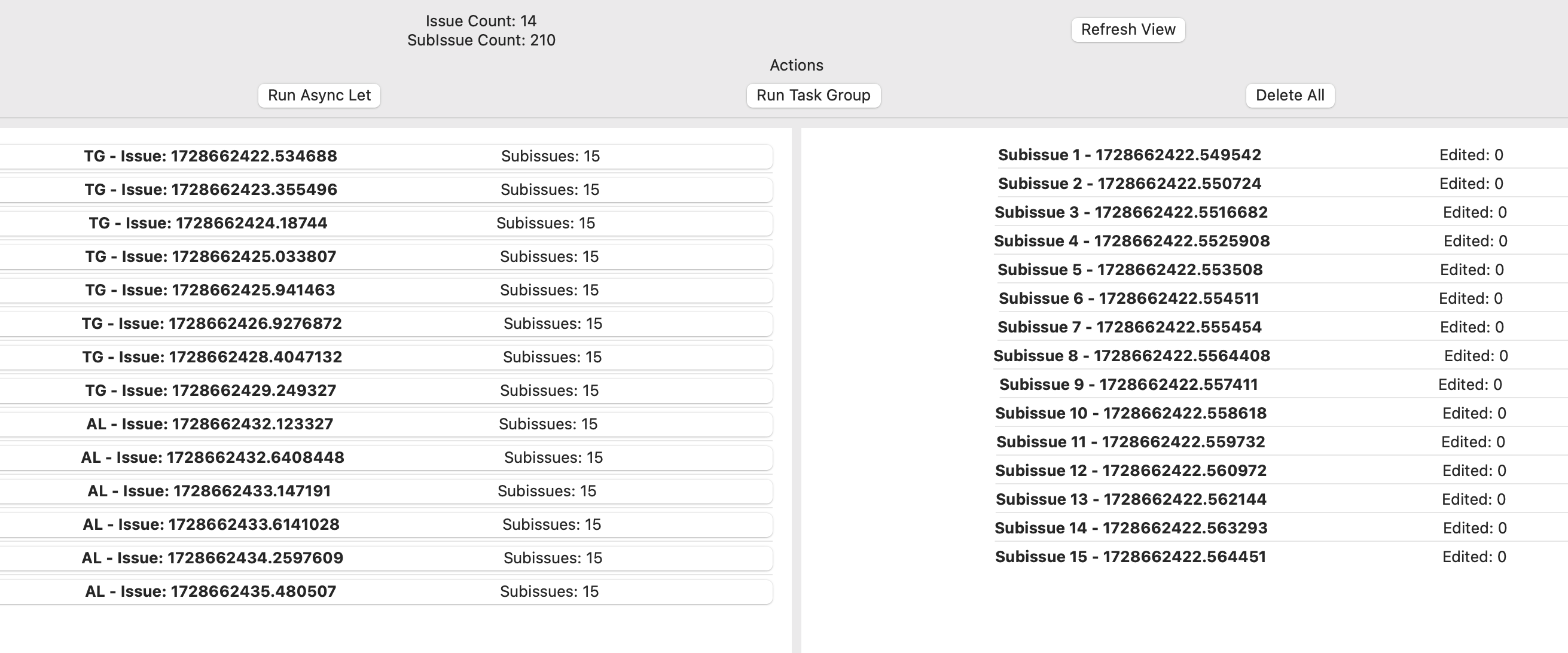

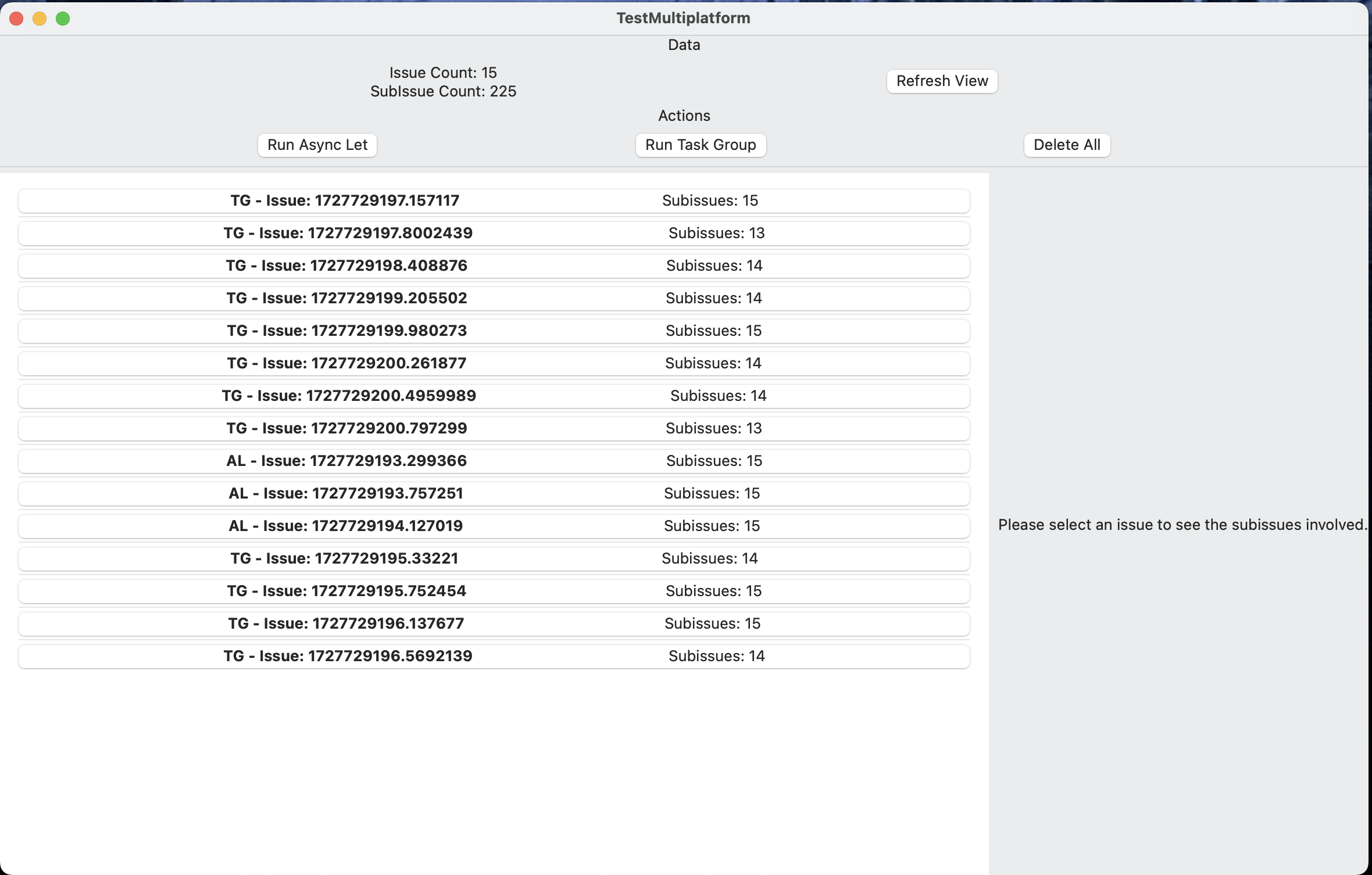

In my minimal viable sample I simplified it way down so you can't run it twice and it's limited it creating 15 subitems. That said, I've hooked it up with both an async let _ = await methodCall(...) dubbed AL and a TaskGroup dubbed TG. With both types my second process (incrementing the number associated with the subissue/subitem) isn't run as it doesn't see the subitem as having been created and, when run with TaskGroup, only 12 to 15 items are created rather that the always 15 of async let.
Code shared here: https://gist.github.com/SimplyKyra/aeee2d43689d907d7a66805ce4bbf072
And this gives a macOS view of showing each time the button is pressed the sub issues created never increment to 1 while, when using TaskGroup, 15 isn't guaranteed to be created and remembered.
