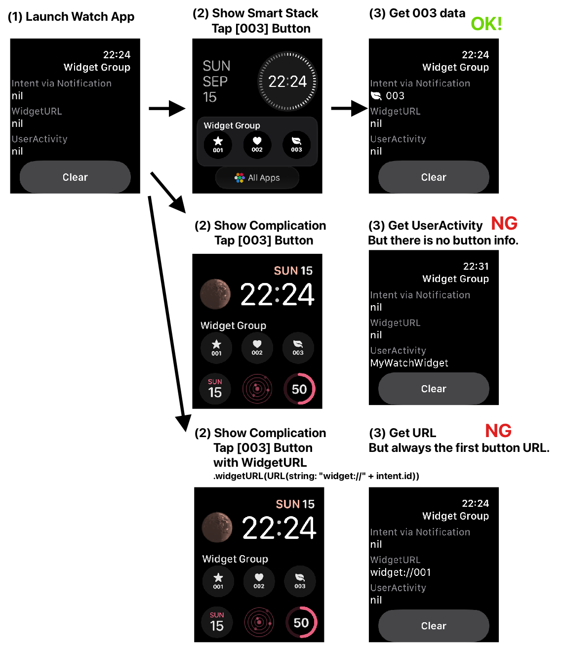

Complication Widget using AccessoryWidgetGroup
I want to get which button in AccessoryWidgetGroup was pressed in the Watch App, but I can't.
When I use Button(_:intent:), it works in Smart Stack, but it doesn't work in Complication Widget.
Using widgetURL(_:) always gets the URL of the first button.
Below is a snippet of the code I tried. All codes can be found here.

Does anyone know how to do this?
Thank you.

Thanks for your reply!
I tried using Button instead of Button(intent:...) and the widget URL wasn't passed correctly. It always returns the URL of the first button.
