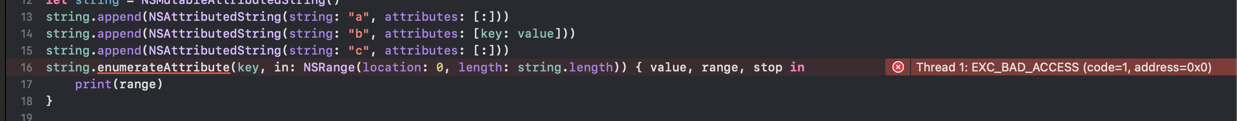

The following code crashes on macOS 15 Sequoia:
import Foundation
let key = NSAttributedString.Key("org.example.key")
let value = Value()
let string = NSMutableAttributedString()
string.append(NSAttributedString(string: "a", attributes: [:]))
string.append(NSAttributedString(string: "b", attributes: [key: value]))
string.append(NSAttributedString(string: "c", attributes: [:]))
string.enumerateAttribute(key, in: NSRange(location: 0, length: string.length)) { value, range, stop in
print(range)
class Value: Equatable, Hashable {
static func == (lhs: Value, rhs: Value) -> Bool {
return lhs === rhs
func hash(into hasher: inout Hasher) {
hasher.combine(ObjectIdentifier(self))
The error is
EXC_BAD_ACCESS (code=1, address=0x0)
I wanted to run it on my external macOS 14 partition to confirm that it didn't crash before updating to macOS 15, but for some reason macOS will just restart and boot again into macOS 15. So I tried with macOS 13, which I was allowed to start for some reason, and I was able to confirm that the code doesn't crash.
Is this a known issue, and is there a workaround? Removing the two lines that add the letters a and c, or just declaring class Value without conformance to Equatable, Hashable, interestingly, solves the issue.
