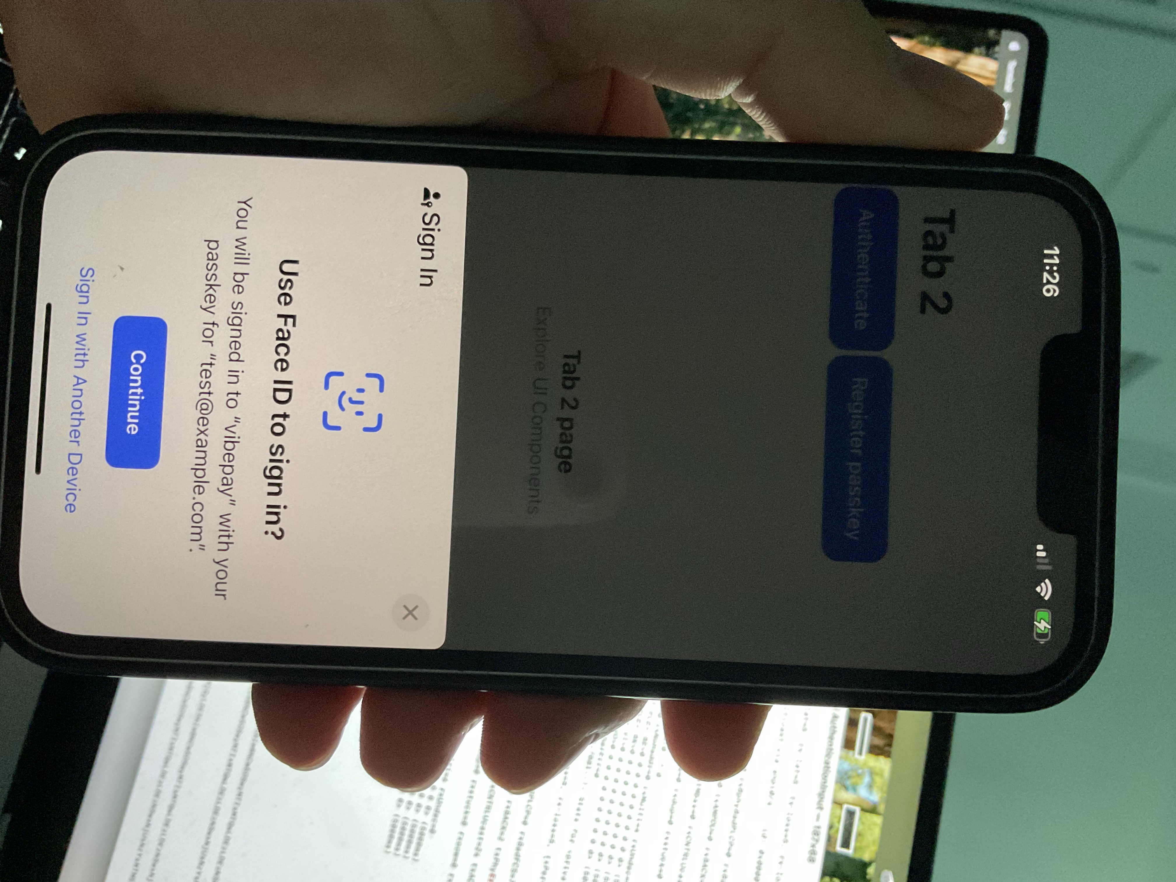

Consider the following scenario. I am logging in using the platform authenticator as shown in img below
The following function was used to authenticate:

Logs:
Feb  5 11:26:27 App(Foundation)[32685] <Notice>: [AuthenticationInput] Starting authentication with parameters
Feb  5 11:26:27 App(Foundation)[32685] <Notice>: [AuthenticationInput] Challenge: randomChallenge123
Feb  5 11:26:27 App(Foundation)[32685] <Notice>: [AuthenticationInput] Relying Party ID: umbrellasoftware.ro
Feb  5 11:26:27 App(Foundation)[32685] <Notice>: [AuthenticationInput] PRF Extension: Optional(["eval": ["first": "MTI1LDMxLDUwLDYsMjQyLDE5Niw0NCw5OSwyMTIsMTQwLDEzLDEzNSwxNjUsNzYsMTM5LDIzNCwxMzAsMjM1LDE4OSwyNDYsMTMxLDM4LDIxNywyMzYsMTcyLDE3NCw2Nyw4MiwxODAsNzksMTM3LDE1MA=="]])
Feb  5 11:26:27 App(Foundation)[32685] <Notice>: [AuthenticationInput] PRF Eval Data: Optional(["first": **"MTI1LDMxLDUwLDYsMjQyLDE5Niw0NCw5OSwyMTIsMTQwLDEzLDEzNSwxNjUsNzYsMTM5LDIzNCwxMzAsMjM1LDE4OSwyNDYsMTMxLDM4LDIxNywyMzYsMTcyLDE3NCw2Nyw4MiwxODAsNzksMTM3LDE1MA=="])**

Logs:
Feb  5 11:38:13 App(AuthenticationServices)[32793] <Notice>: Successfully completed authorization: <ASAuthorizationPlatformPublicKeyCredentialAssertion: 0x3002f80e0>
Feb  5 11:38:13 App(Foundation)[32793] <Notice>: [CredentialAssertion] Starting to process credential assertion
Feb  5 11:38:13 App(Foundation)[32793] <Notice>: [CredentialAssertion] Credential ID: NxlQaXK64UAY0EsehesfFy9rt-0
Feb  5 11:38:13 App(Foundation)[32793] <Notice>: [CredentialAssertion] Raw Client Data JSON: eyJ0eXBlIjoid2ViYXV0aG4uZ2V0IiwiY2hhbGxlbmdlIjoicmFuZG9tQ2hhbGxlbmdlMTJ3Iiwib3JpZ2luIjoiaHR0cHM6Ly91bWJyZWxsYXNvZnR3YXJlLnJvIn0
Feb  5 11:38:13 App(Foundation)[32793] <Notice>: [CredentialAssertion] Raw Authenticator Data: vldv6g0NnZfh2nEqmP9eXTqSD1qTiN4v-J9WG1xlVsYdAAAAAA
Feb  5 11:38:13 App(Foundation)[32793] <Notice>: [CredentialAssertion] Signature: MEQCH0XTR7IyewTV8J3Iv3pZII4ohTKdKRtreRhagUZjG8cCIQDhFCuPJJumOjLJaWbvw0ppuxh1EIjL_QMFIKuh-73M6Q
Feb  5 11:38:13 App(Foundation)[32793] <Notice>: [CredentialAssertion] User ID: dXNlcjEyMw
Feb  5 11:38:13 App(Foundation)[32793] <Notice>: [CredentialAssertion] PRF Result: **nmKfLMSLd0vuV8xgAMQQ40rajzkSdHM_f3V4mq5UUqo**

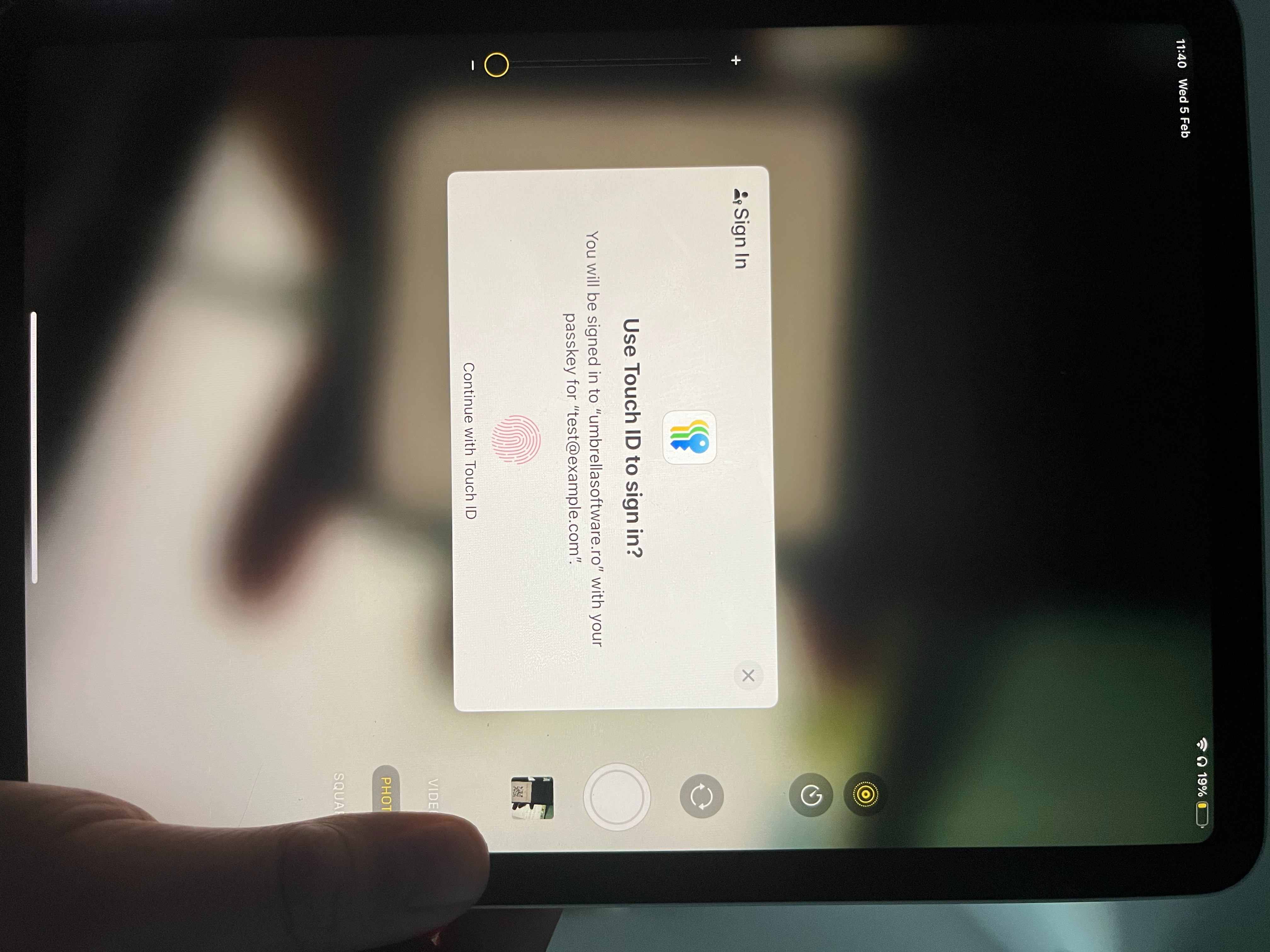

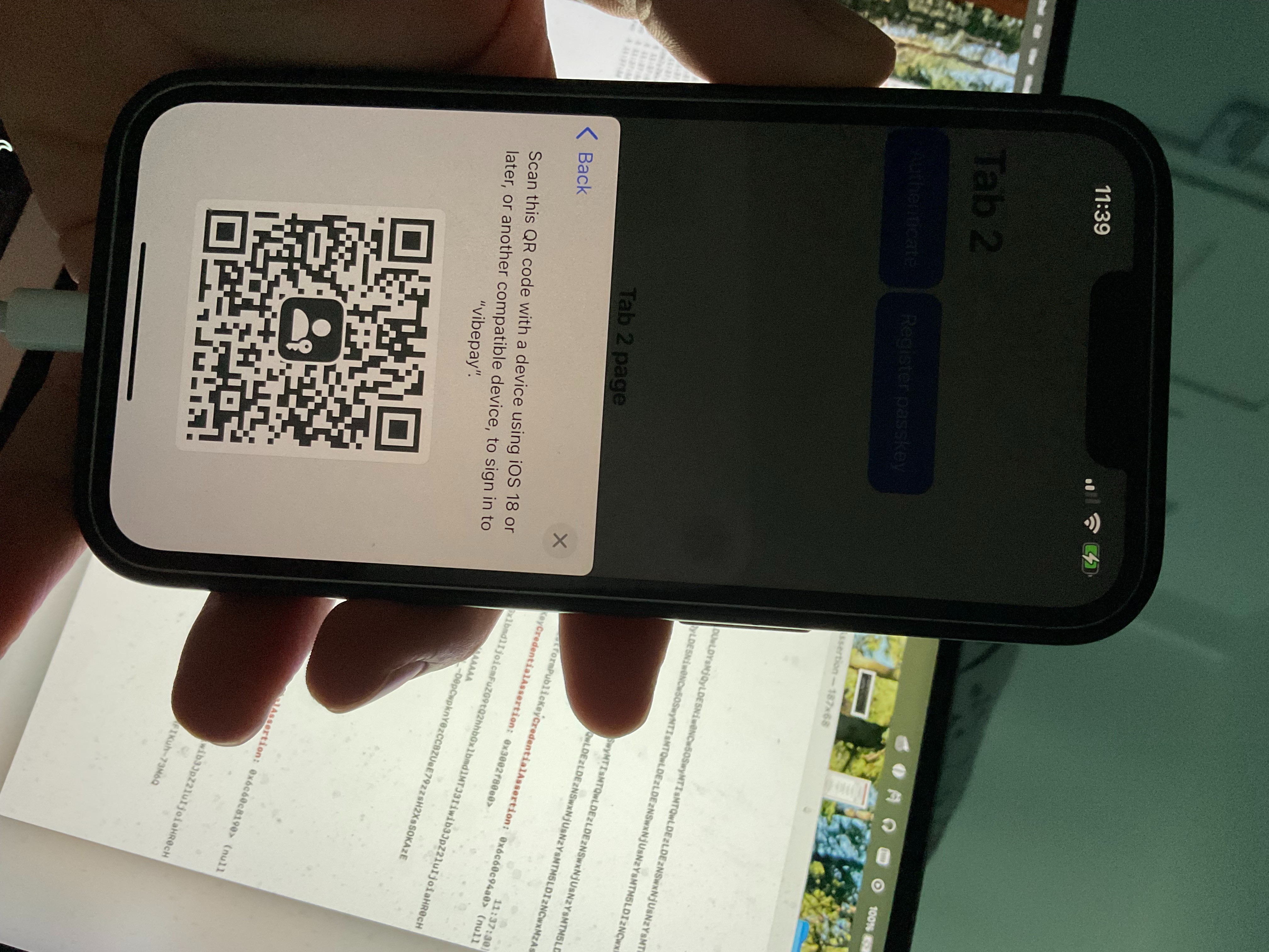

When using cross platform as in the images below, i get the following logs:
Feb  5 11:40:29 App(Foundation)[32793] <Notice>: [AuthenticationInput] Starting authentication with parameters
Feb  5 11:40:29 App(Foundation)[32793] <Notice>: [AuthenticationInput] Challenge: randomChallenge123
Feb  5 11:40:29 App(Foundation)[32793] <Notice>: [AuthenticationInput] Relying Party ID: umbrellasoftware.ro
Feb  5 11:40:29 App(Foundation)[32793] <Notice>: [AuthenticationInput] PRF Extension: Optional(["eval": ["first": "MTI1LDMxLDUwLDYsMjQyLDE5Niw0NCw5OSwyMTIsMTQwLDEzLDEzNSwxNjUsNzYsMTM5LDIzNCwxMzAsMjM1LDE4OSwyNDYsMTMxLDM4LDIxNywyMzYsMTcyLDE3NCw2Nyw4MiwxODAsNzksMTM3LDE1MA=="]])
Feb  5 11:40:29 App(Foundation)[32793] <Notice>: [AuthenticationInput] PRF Eval Data: Optional(["first": "MTI1LDMxLDUwLDYsMjQyLDE5Niw0NCw5OSwyMTIsMTQwLDEzLDEzNSwxNjUsNzYsMTM5LDIzNCwxMzAsMjM1LDE4OSwyNDYsMTMxLDM4LDIxNywyMzYsMTcyLDE3NCw2Nyw4MiwxODAsNzksMTM3LDE1MA=="])
Feb  5 11:41:00 App(Foundation)[32793] <Notice>: [CredentialAssertion] Starting to process credential assertion
Feb  5 11:41:00 App(Foundation)[32793] <Notice>: [CredentialAssertion] Credential ID: NxlQaXK64UAY0EsehesfFy9rt-0
Feb  5 11:41:00 App(Foundation)[32793] <Notice>: [CredentialAssertion] Raw Client Data JSON: eyJ0eXBlIjoid2ViYXV0aG4uZ2V0IiwiY2hhbGxlbmdlIjoicmFuZG9tQ2hhbGxlbmdlMTJ3Iiwib3JpZ2luIjoiaHR0cHM6Ly91bWJyZWxsYXNvZnR3YXJlLnJvIn0
Feb  5 11:41:00 App(Foundation)[32793] <Notice>: [CredentialAssertion] Raw Authenticator Data: vldv6g0NnZfh2nEqmP9eXTqSD1qTiN4v-J9WG1xlVsYdAAAAAA
Feb  5 11:41:00 App(Foundation)[32793] <Notice>: [CredentialAssertion] Signature: MEYCIQDbC5w5qwZ8shQbSQOTQ08n1WaYrQsYBvNrtc8IyvzXEgIhAJHydA8N0eoTLCwNyPV846sCtkzF0tGpzI2sRaOrd1Pv
Feb  5 11:41:00 App(Foundation)[32793] <Notice>: [CredentialAssertion] User ID: dXNlcjEyMw
Feb  5 11:41:00 App(Foundation)[32793] <Notice>: [CredentialAssertion] PRF Result: **HztucMbG6UQ5QOVhM17gwi3C7S1kxC7isCYfaS8zbNw**
as you can see, the PRF output is different
