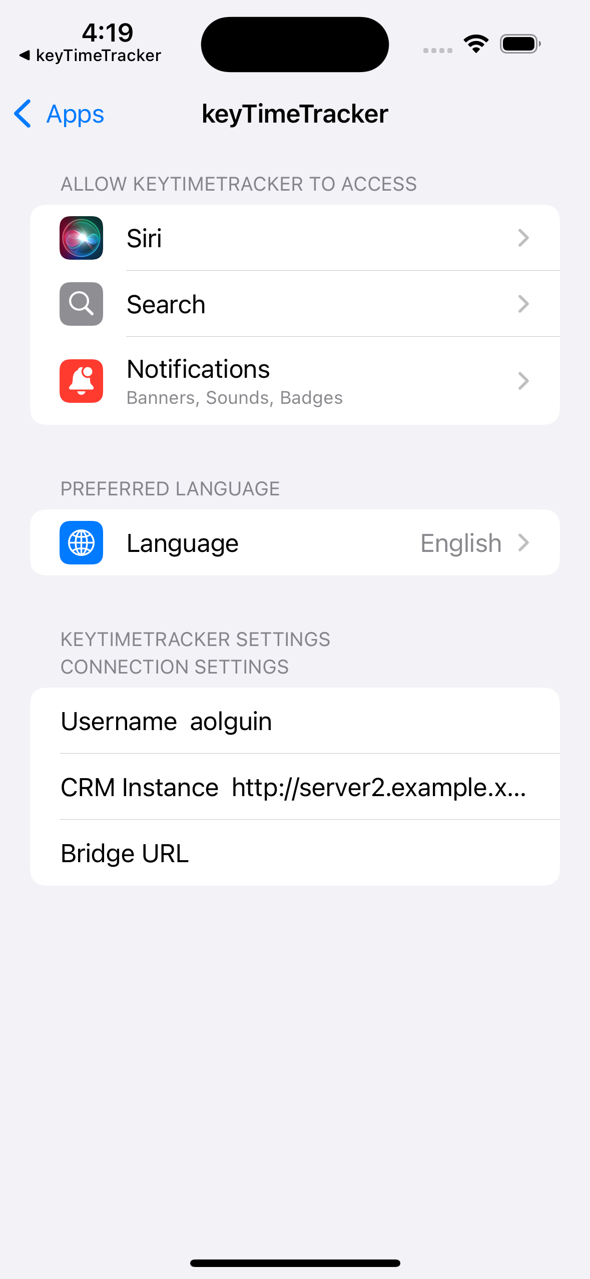

I'm currently working on an app made originally for iOS 15. On it, I add an observer on viewDidLoad function of my ViewController to listen for changes on the UserDefault values for connection settings.
NotificationCenter.default.addObserver(self, selector: #selector(settingsChanged), name: UserDefaults.didChangeNotification, object: nil)
Said values can only be modified on the app's section from System Settings.
Thing is, up to iOS 17, the notification fired as expected, but starting from iOS 18, the notification doesn't seem to be sent by the OS.
Is there anything I should change in my observer, or any other technique to listen for the describe event?
