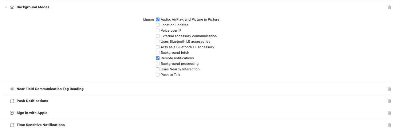

The application itself has not requested background permissions, as shown in the attachment. I am puzzled about what could cause the application to restart in the background several seconds after being forcibly closed.

I don't know what you mean the application has not requested background execution. As seen there you have obviously declared Remote Notifications background capability.
If you are sending push notifications with the content-available:1 entry in the payload, this will have the ability to launch the app if it is not running at the time (except for if user has terminated it, then it will never launch).
That is one possible explanation. Whatever it is, it is likely something you are doing in the app, and not prewarming or some other system function.
I also see you are using NFC functionality. Is your app supporting background tag reading? If so, and the app is not running, then didFinishLaunchingWithOptions() will be called before application(_:continue:restorationHandler:) is called
