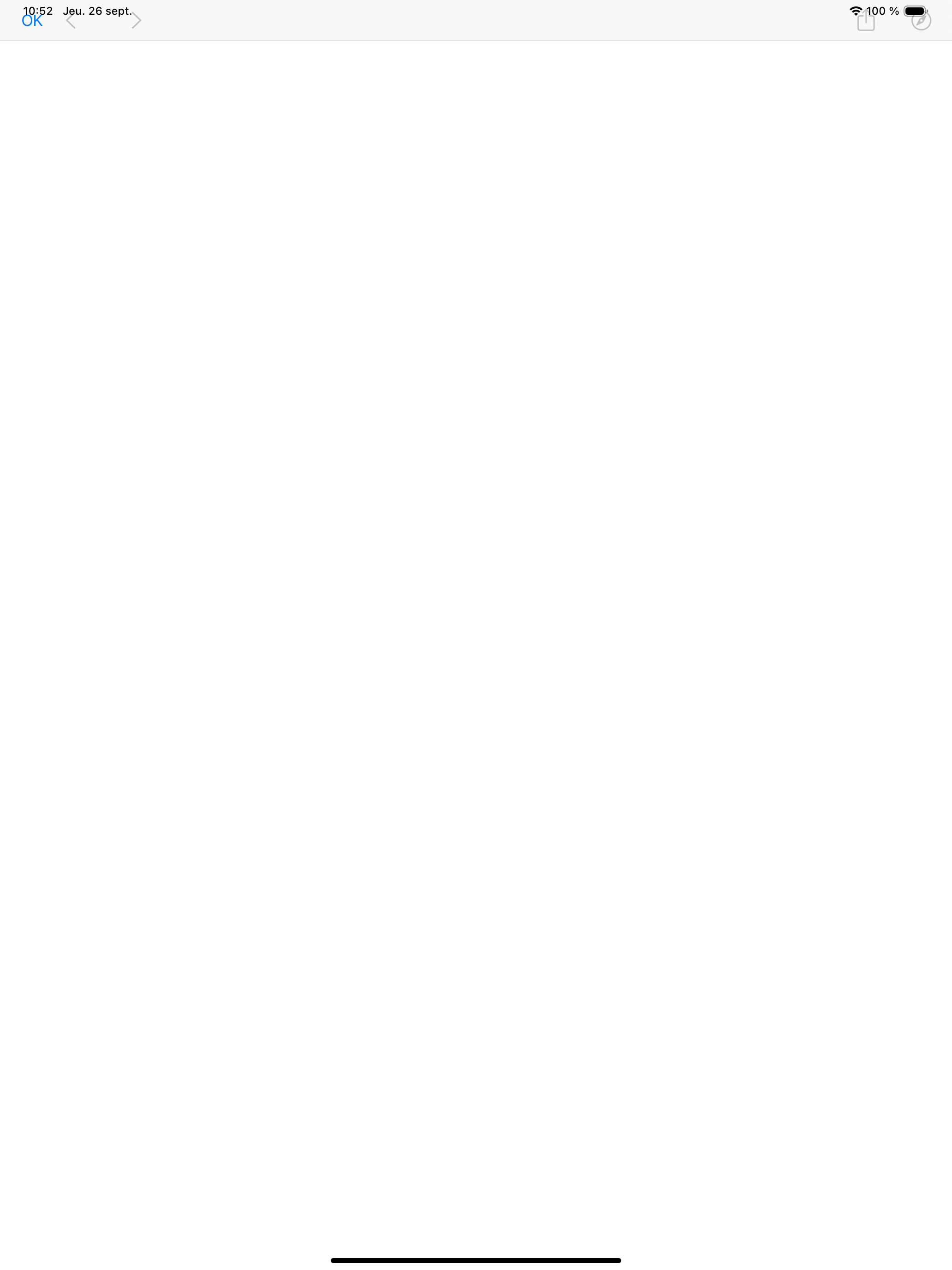

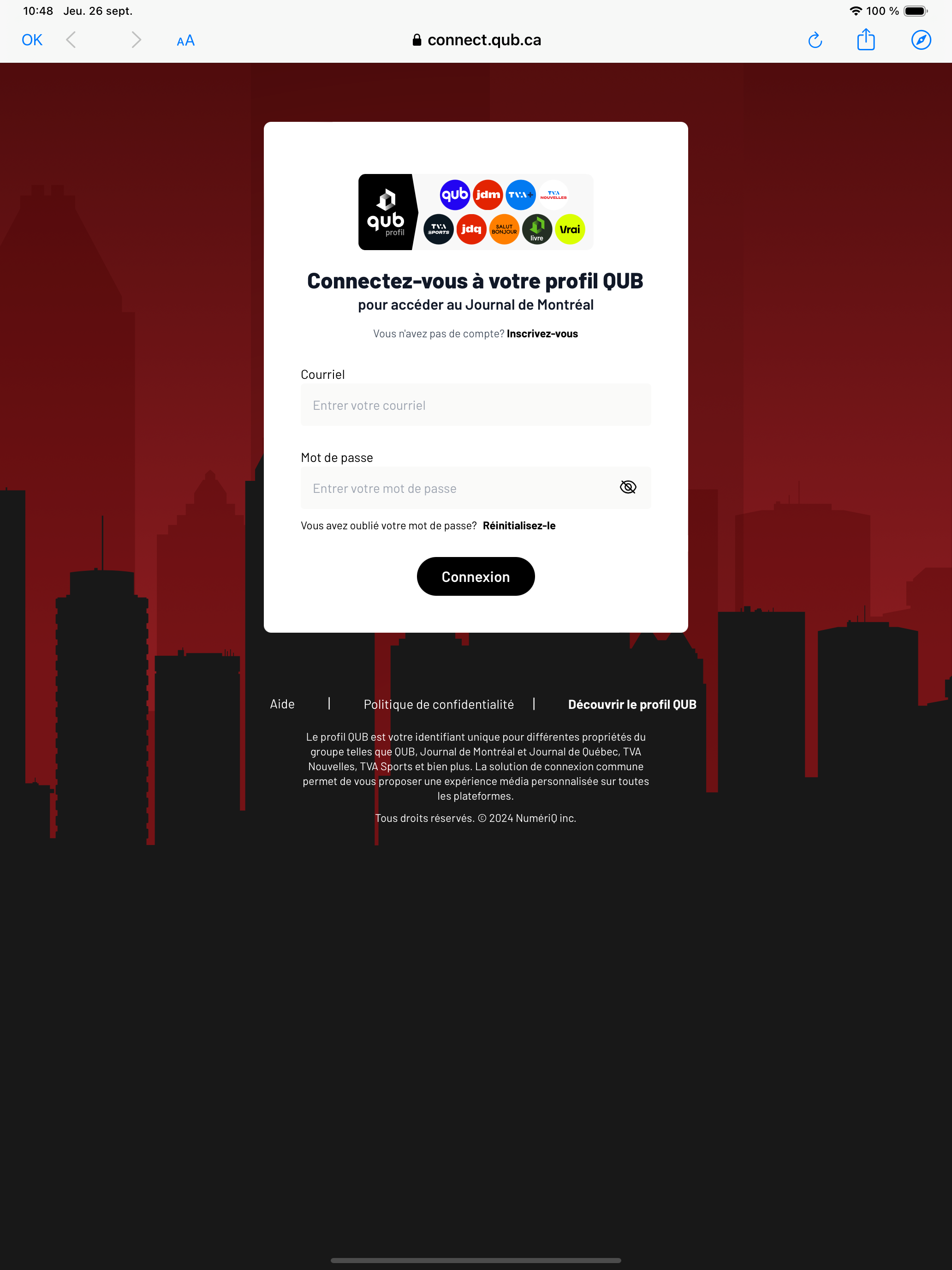

I too am struggling with this issue.
  • Xcode 16.0 + iOS 17.0 Simulator => No issue
  • Xcode 16.0 + iOS 18.0 Simulator => SafariViewController freezes
  • Xcode 16.0 + iOS 18.0 Real device => No issue
As additional information, this did not occur when I created a minimally configured project with Xcode 16.0.

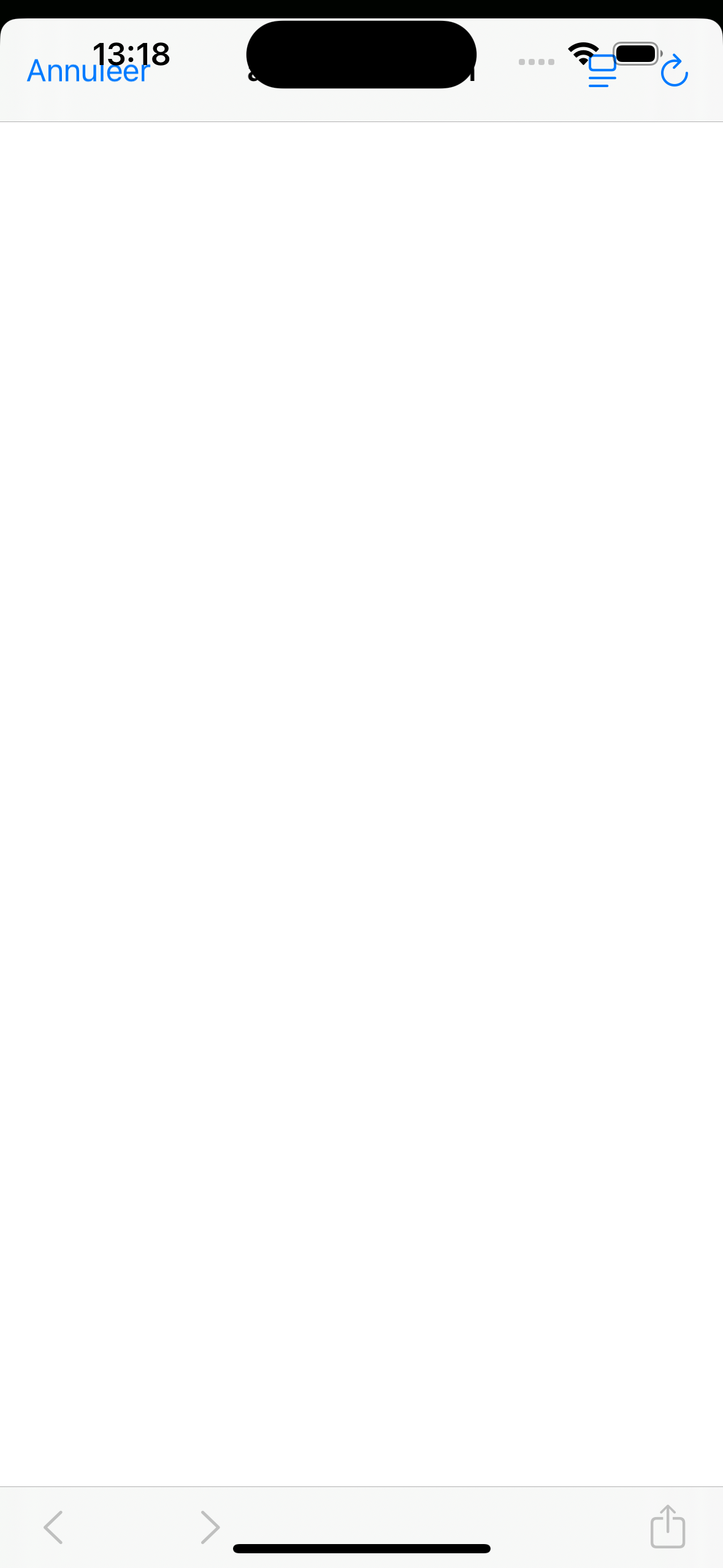

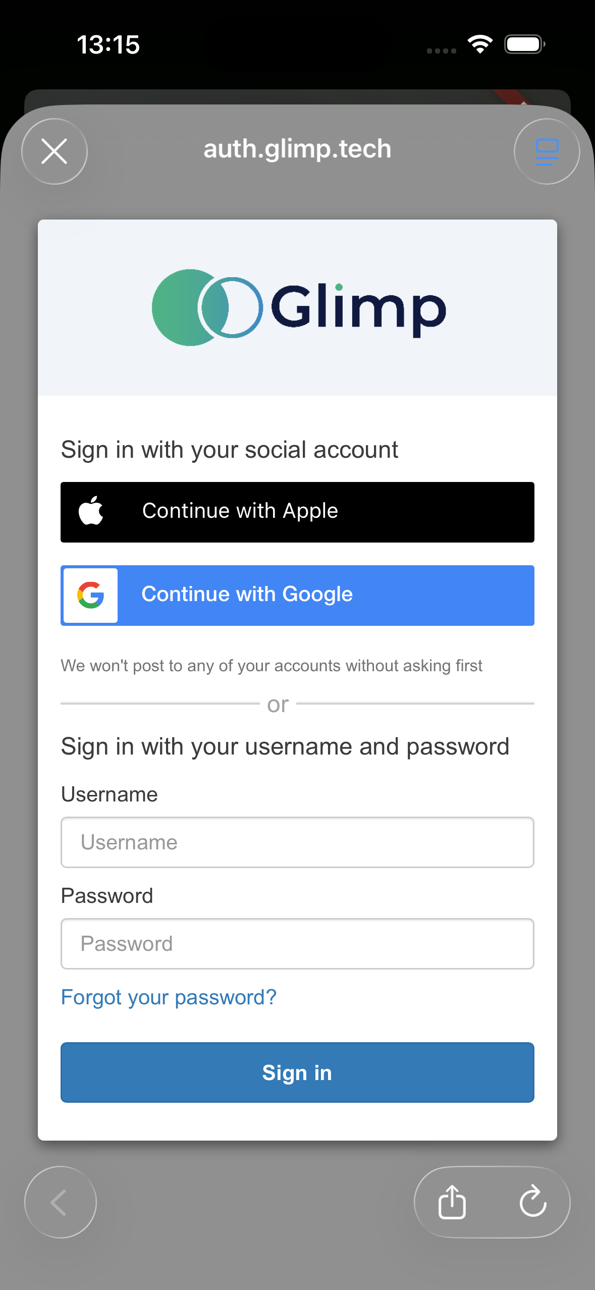

We are also facing the same issue. The App freezes, and it seems like the navbar is stuck behind the status bar. Done button is not clickable. I attached some images so you can see the difference with iOS 17.5
