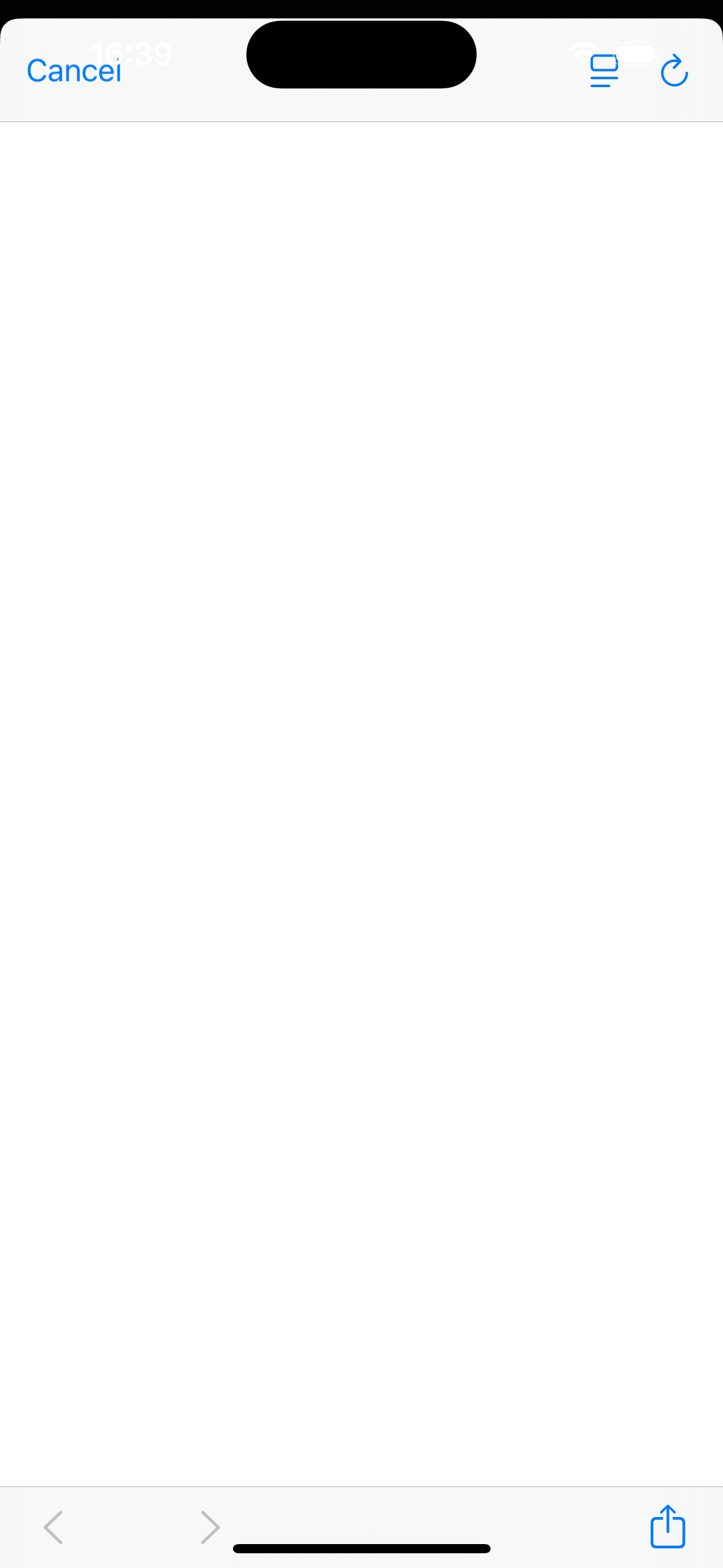

We have some third-party SDKs do not support arm64 simulator, so we excluded arm64 for Any iOS Simulator SDK in Excluded Architectures. But in this case, ASWebAuthenticationSession will display abnormally.
We submitted FB14853757 during the beta period, but have not received any response. This issue still exists in the official version. I hope it can be resolved. Thank you!

Not really, there are tons of 3rd parties out there that require to exclude arm64 simulator support. I have the exact same issue for a few days now and the problem occurs with ASWebAuthenticationSession and also with SFAuthenticationSession. It wasn't an issue in XCode 15.4, but it's an issue in XCode 16.
I dug in the code of one such framework and as soon as you call "start" on those sessions, they get stuck like in the image above.
