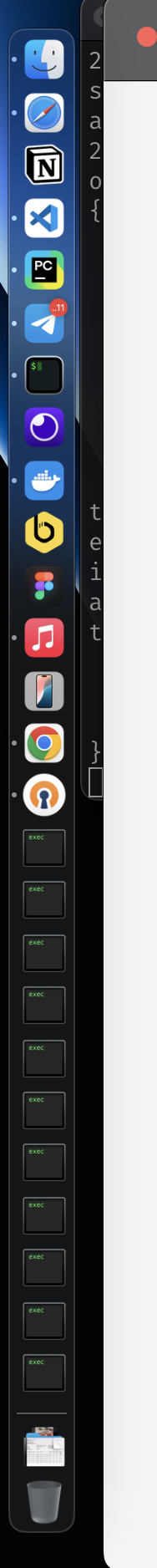

After upgrading to MacOS Seqouia all python process show in dock
Hi! After upgrading my Macbook Pro M1 Pro to MacOS Sequoia 15.0 when I run my python backend code i show in dock all python process as Exec Icon. Now work with backend so hard, because all my dock in this icons( How I can fix this? Support dont help me, because resinstall and e t c dont work for me.

I have the same issue here. It happens with all the terminal python process and also those started by pycharm. In the Terminal I'm running saltstack master, minion and api process that spawn other python process so for those I'm getting around 14 process in my dock. Just upgrade yesterday Sept 22 and before the upgrade wasn't an issue

Sorry but this answer doesn't solve any problem at all It's just a way to diminish what it's really happening with the dock that right now it's not usable at all
This it's not something that we as users are doing new now. It's something that started to happen with the upgrade to Sequoia. In my case with completely server process that uses no GUI at all and also aren't been running as a service, I manually run it in my terminal. Hope for a new MacOs update that fix this issue

I was having the same issue. Basically I followed the instructions here: https://leancrew.com/all-this/2014/01/stopping-the-python-rocketship-icon/ and that fixed it!
Here's a quick guide:
  • On the terminal, navigate to where the python installation files are: In my case, I installed python via homebrew. So the path to the Info.plist file is: /opt/homebrew/Frameworks/Python.framework/Versions/3.9/Resources/Python.app/Contents . On the link provided, it is using the Python that is backed in macOs. But I use this version for development.
  • We need to modify the Info.plist file. But first, chmod it: sudo chmod 666 Info.plist
  • I just used vscode to edit the file. In the post I provided, it is using a software to convert the file. But in my case I didn't need it.
  • Add the following lines just before the final </dict> near the end of the file:
<key>LSUIElement</key>
<true/>
  • Not needed, but you can change the permissions back to what they were: sudo chmod 644 Info.plist
  • Done! re-execute your app and no more python process on the dock.
