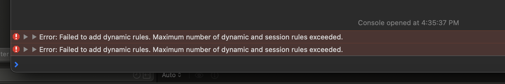

We have more than 22,000 rules in the ruleset_1 json file.
We are getting the below error with 22342 rule sets. We are trying this for Safari iOS. As per the documentation, we see that dynamic rules have a limit of 30,000 - https://developer.mozilla.org/en-US/docs/Mozilla/Add-ons/WebExtensions/API/declarativeNetRequest/MAX_NUMBER_OF_DYNAMIC_AND_SESSION_RULES
