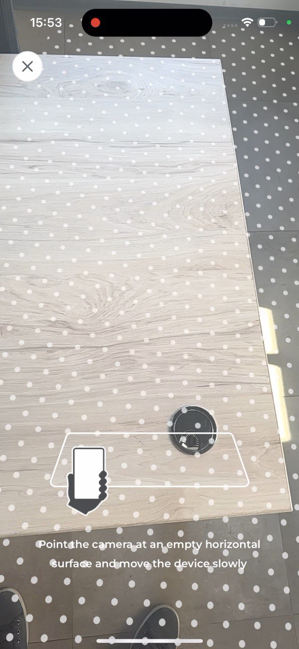

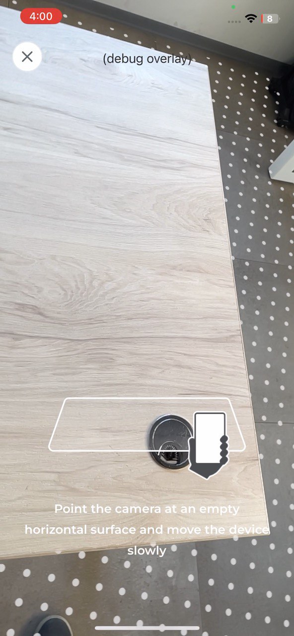

I will try to explain more clearly. The first image shows the correct behavior (iOS 17), while the second shows the incorrect behavior (iOS 18). As you can see, the occlusion is not working.
I will also attach two videos of the same build so that you can see the strange behavior on iOS 18. https://youtube.com/shorts/VPCMBiASxLc?feature=share https://youtube.com/shorts/Q8LL4lU2cZE?feature=share
You can also try this model in Quick Look on iOS 17 and 18 to see the difference: https://vizbl-2.s3.us-west-1.amazonaws.com/native/cc60dd92-58c2-4867-82a1-55afae8caf9f.usdz
