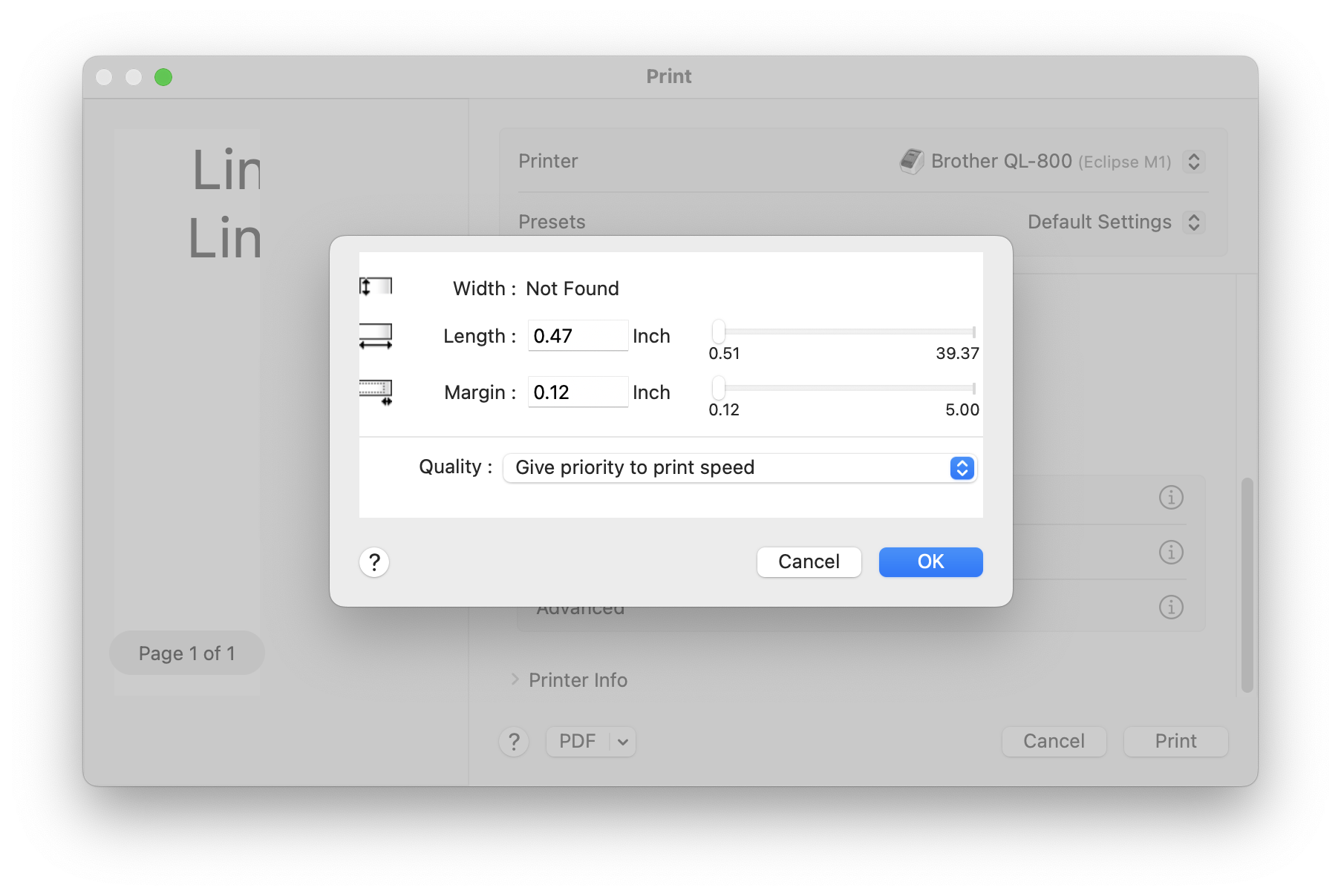

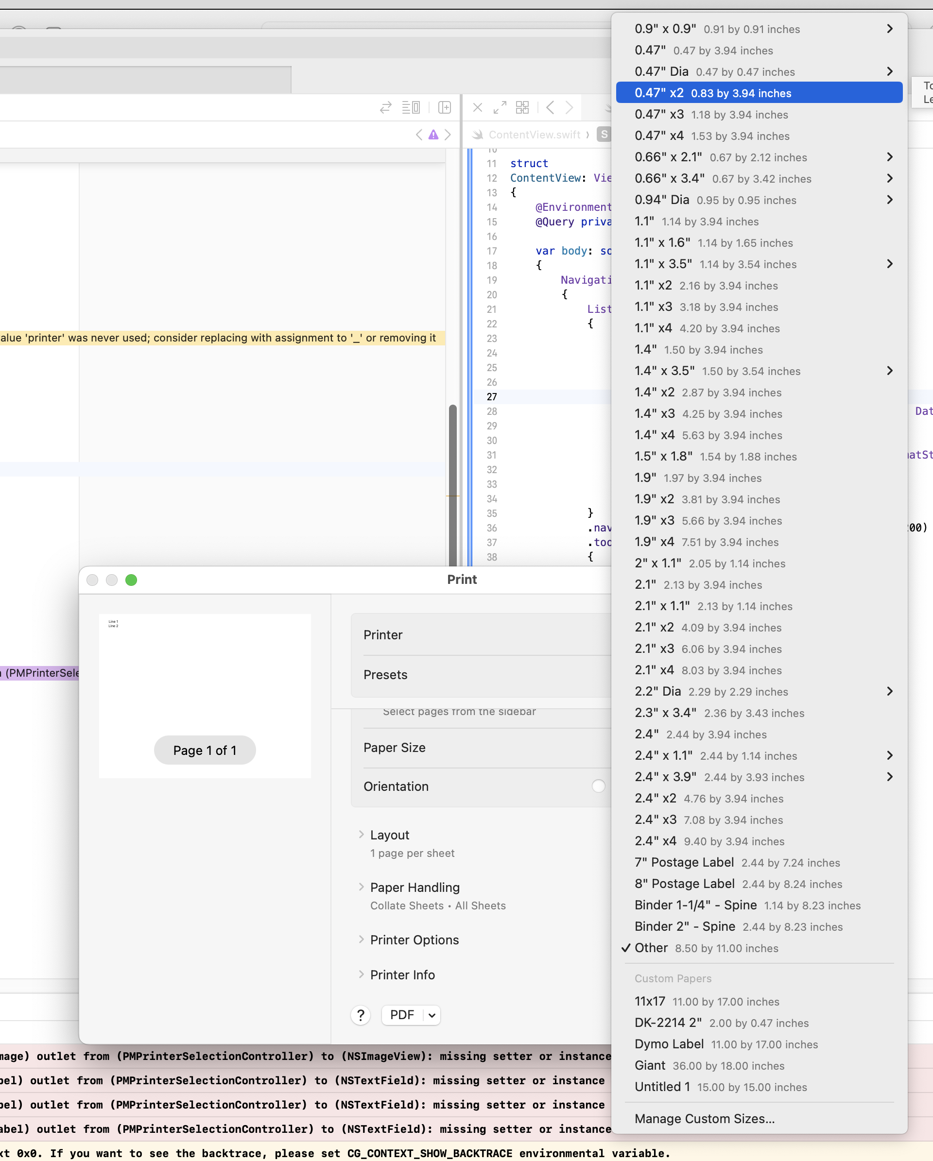

If I set the pageSize explicitly (uncommenting the line above),
The printer offers a long list of available sizes (although none I've found corresponds to the 0.47"/12 mm x continuous spool). By the way, it never remembers the size I selected, and always reverts to 8.5 x 11, which it will then refuse to print, hanging in Print Center with an error about mismatched page sizes.
I don’t know why the available page sizes have multiple sizes that don’t seem to match. E.g. 0.47" In the printer’s “Basic Options,” it shows the notion of a Width that's "not found," if I use a custom size:
I don't really understand where those printer options can be found and set.
