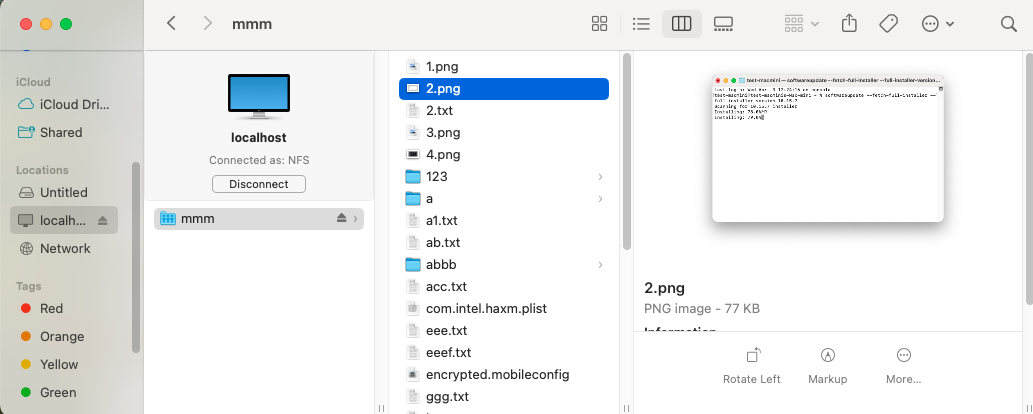

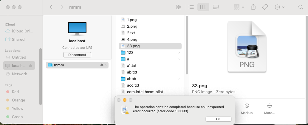

  • Dragging and dropping or copying any file to the NFS mount directory via Finder only creates the file, but it's empty and shows a 100093 error.
  • Using the cp command to copy the same file to the NFS mount directory works fine in terms of writing the file content, but still shows an error about failing to write extended attributes. (just renamed the 33.png to 2.png)

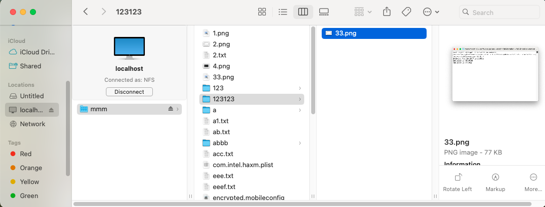

  • However, if I put the files into a folder and then copy that folder via Finder or terminal to the NFS mount directory, everything works normally.
