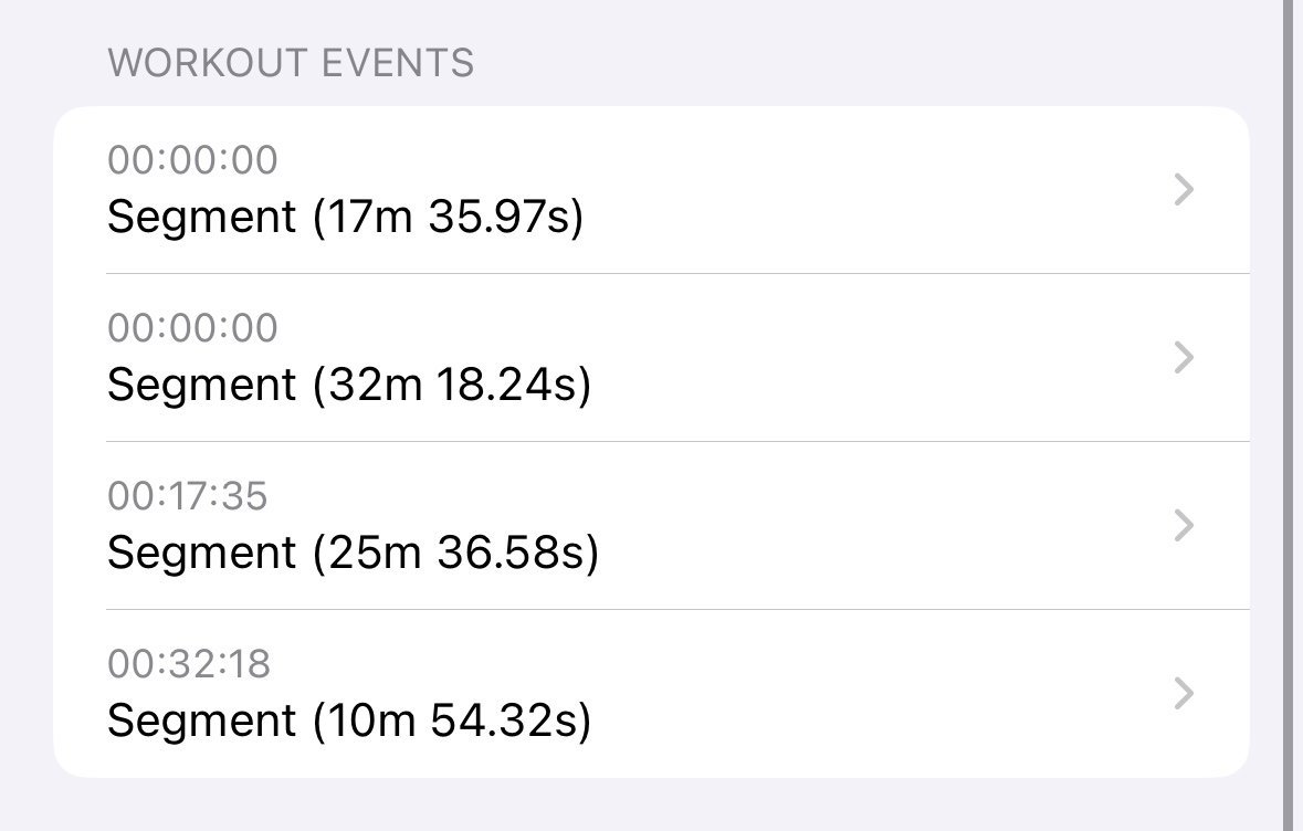

@sgonser which application is the source of the workout?
Some apps save segments for both kilometer and miles so that it is quick and easy to fetch later based on the users preference and locale. To your earlier comments and question, this might be why you are seeing segments overlap of segments.
Namely the Apple Activity app on watchOS does this. I recorded a walk on a beach in Ireland earlier this year. You can see my pace wasn't very high...there were many interesting shells, rocks, and sealife.
So from the image above, the first segment is the first 1 KM, the second is the first 1 MI, third is 2nd KM (remainder), and the fourth is the 2nd MI (remainder).
The HKStatisticsQuery API is very powerful. Another approach you could take, given another workout apps segments, compute the sum distance of that segment interval. If it is near 1-mi, you know the segment is a mile, otherwise if it is near 1-km, you know it is kilometers. In terms of determining that last segment, look at the segment before which has an end date that matches or roughly matches the start date of the last segment. Don't do math that looks exactly for 1-KM or 1-MI because the odds of the sample data generating exactly a round number are slim at best.
