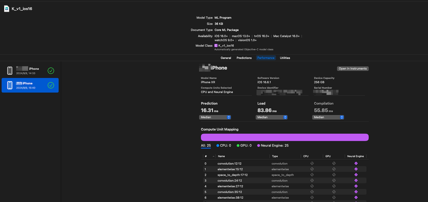

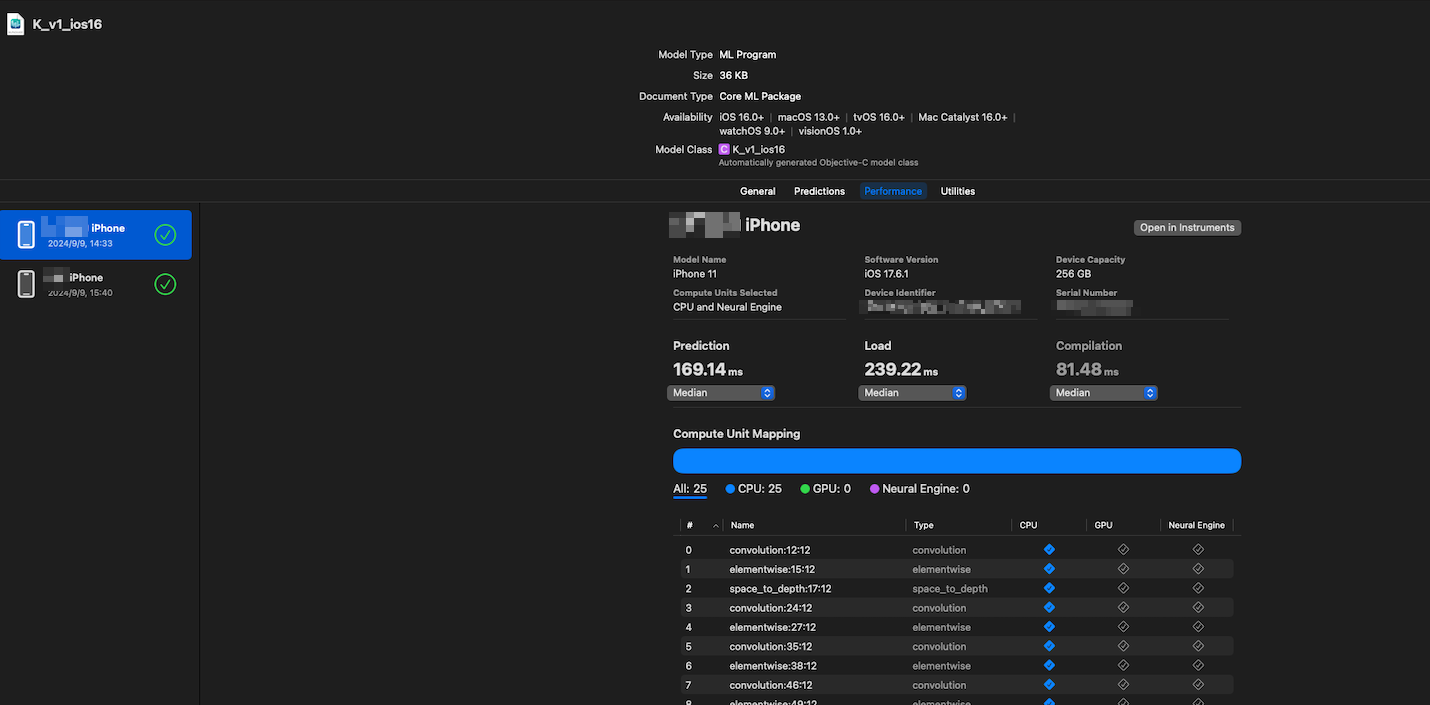

I tested this on iPhone XR, iPhone 11, iPhone 12, iPhone 13, and iPhone 14. On all devices except the iPhone 11, the model runs correctly on the NPU. However, on the iPhone 11, the model runs on the CPU instead.

The test results of the same model on iPhone 11 and iPhone XR. iPhone XR runs correctly on ANE, while iPhone 11 runs on CPU
The test results show that the issue occurs on all devices equipped with the Apple A13 Bionic chip.
