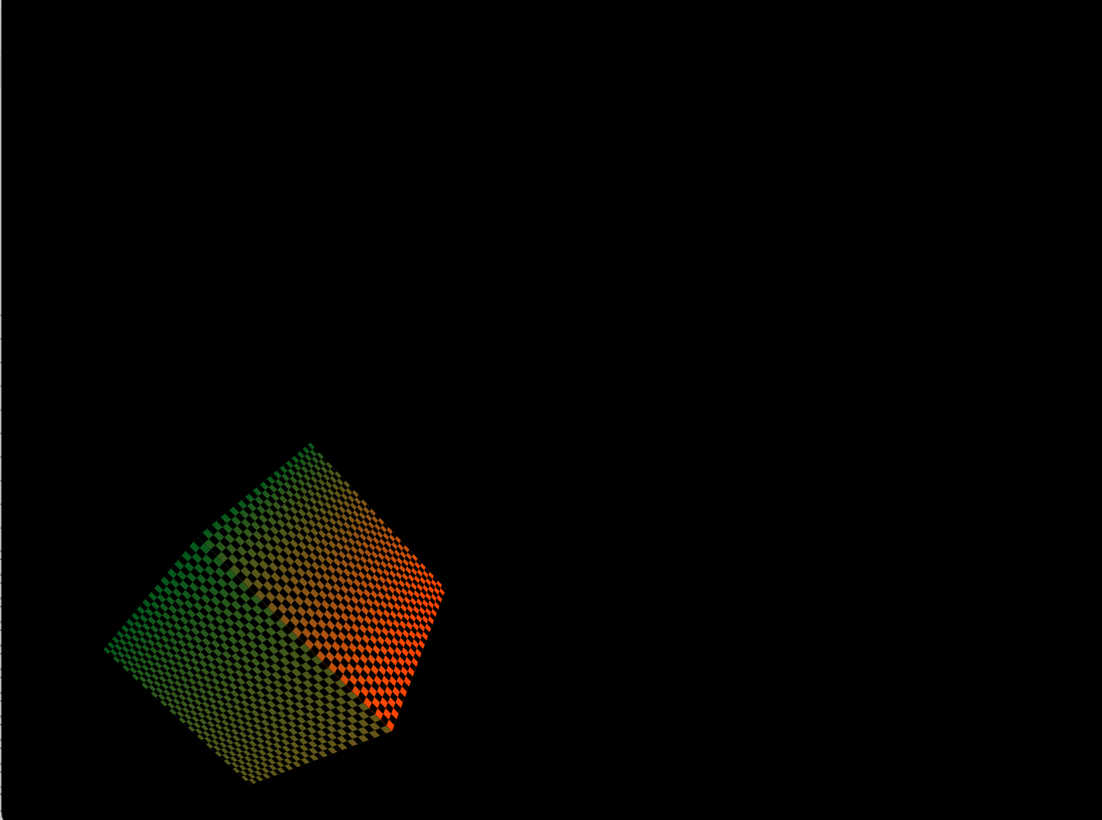

Here is the "normal" case: the spotlight is to the right:

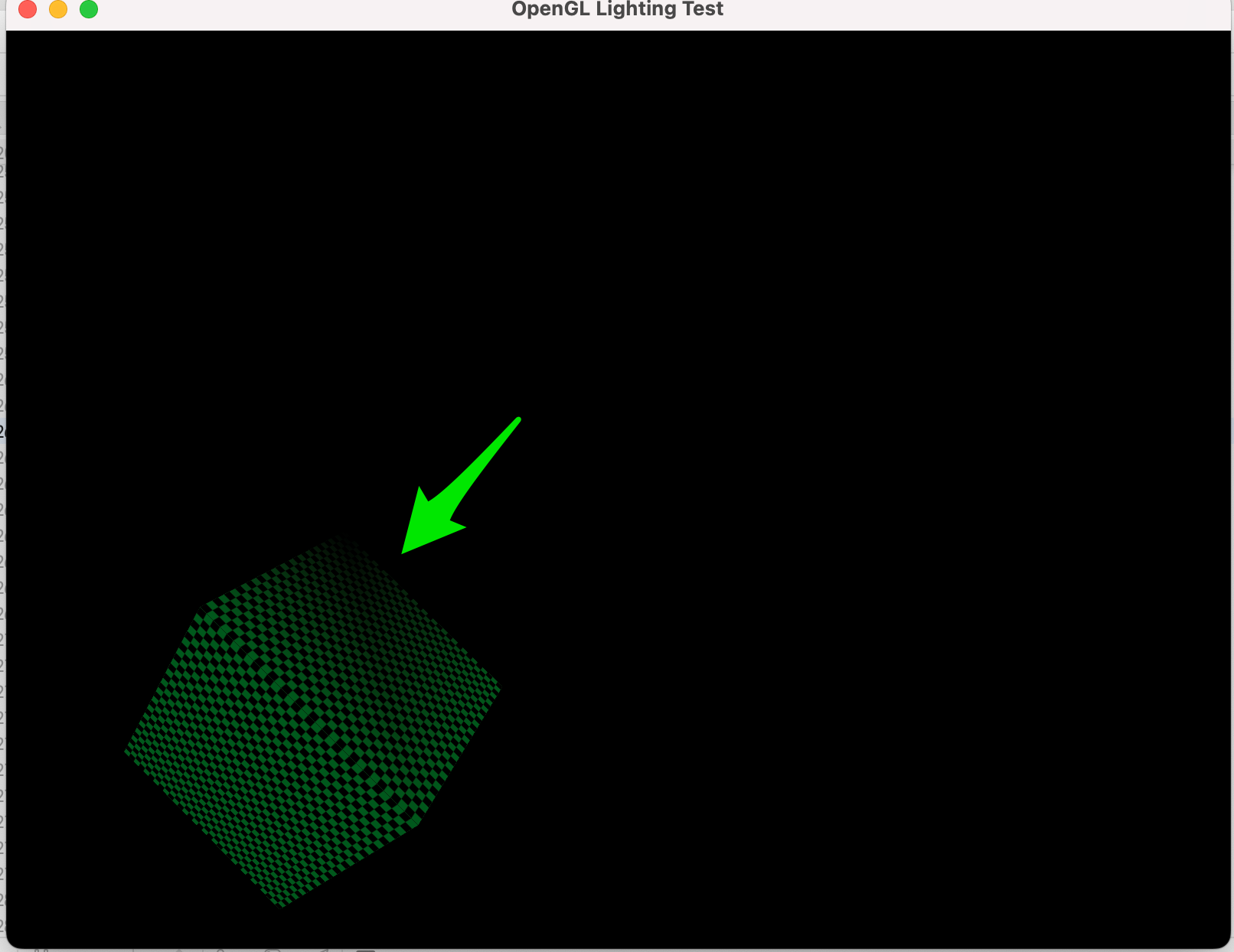

Here, I have moved the spotlight down (Y = 1). Notice the black areas on the cube. That's incorrect.
