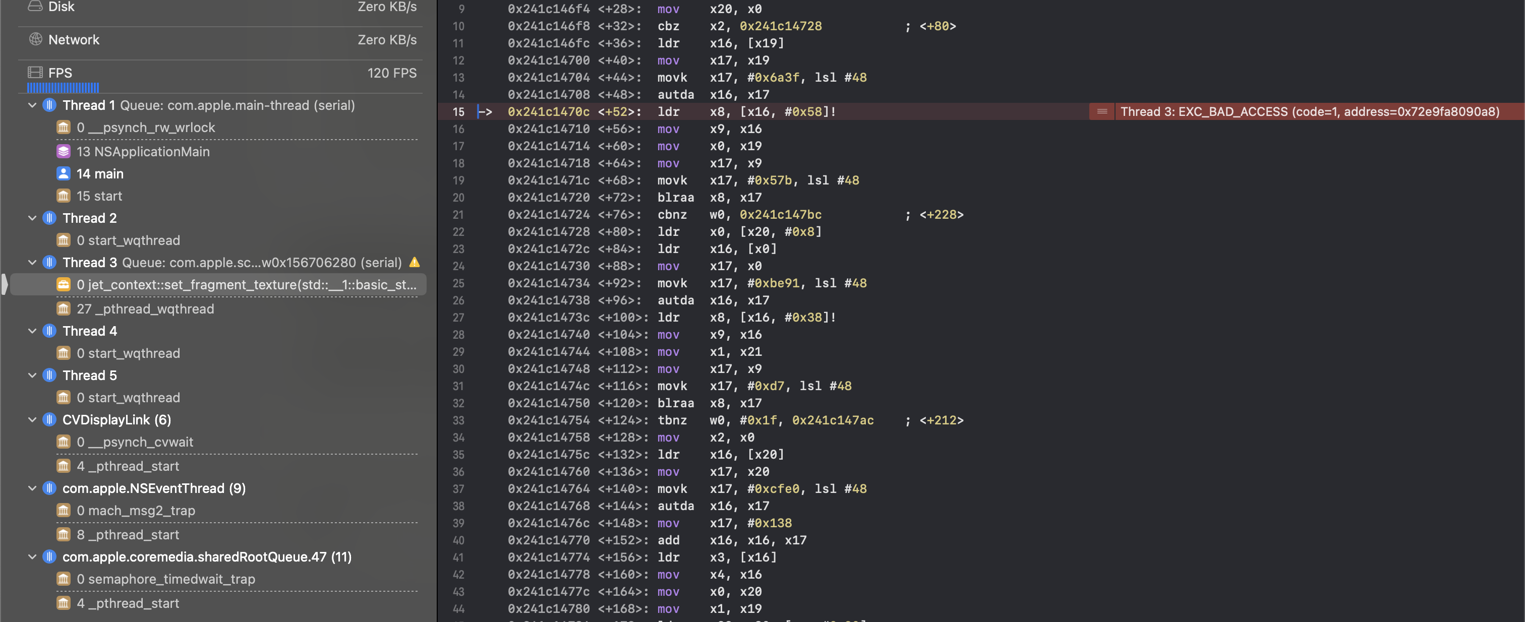

Where can I find the full (symbolicated) crash log? I don't have any relevant crash reports in the Console app. The crash is happening while debugging the app in Xcode. Here's a screenshot of all the expanded threads:
random crashes, imo, often mean threading issues, and indeed what you shared shows a crash in thread 2 with several other threads running as well. FWIW, early in my SceneKit days, I experienced similar crashes, and solved it by refactoring my code to add and remove SCNNodes only in main thread. fwiw.

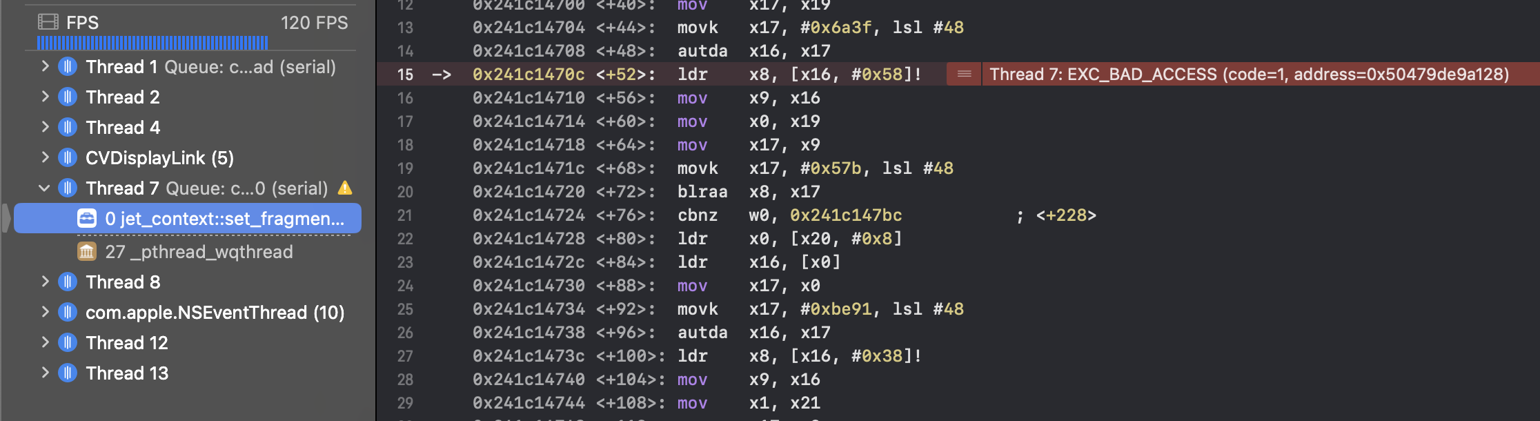

Thanks. Here's the symbolicated crash report. It seems that it is indeed caused by the overlay SpriteKit scene.

Thanks for the suggestion, but I already solved these kind of crashes a long time ago. I'm already doing scene changes on the main thread.
Thanks for the log, it looks like it is truncated, and in this case it would be helpful to see the registers at the bottom.
That's the complete contents of the .ips file I found in the Console app. I have no idea why it is truncated. How can I find out why it's truncated and how to produce a full report?
