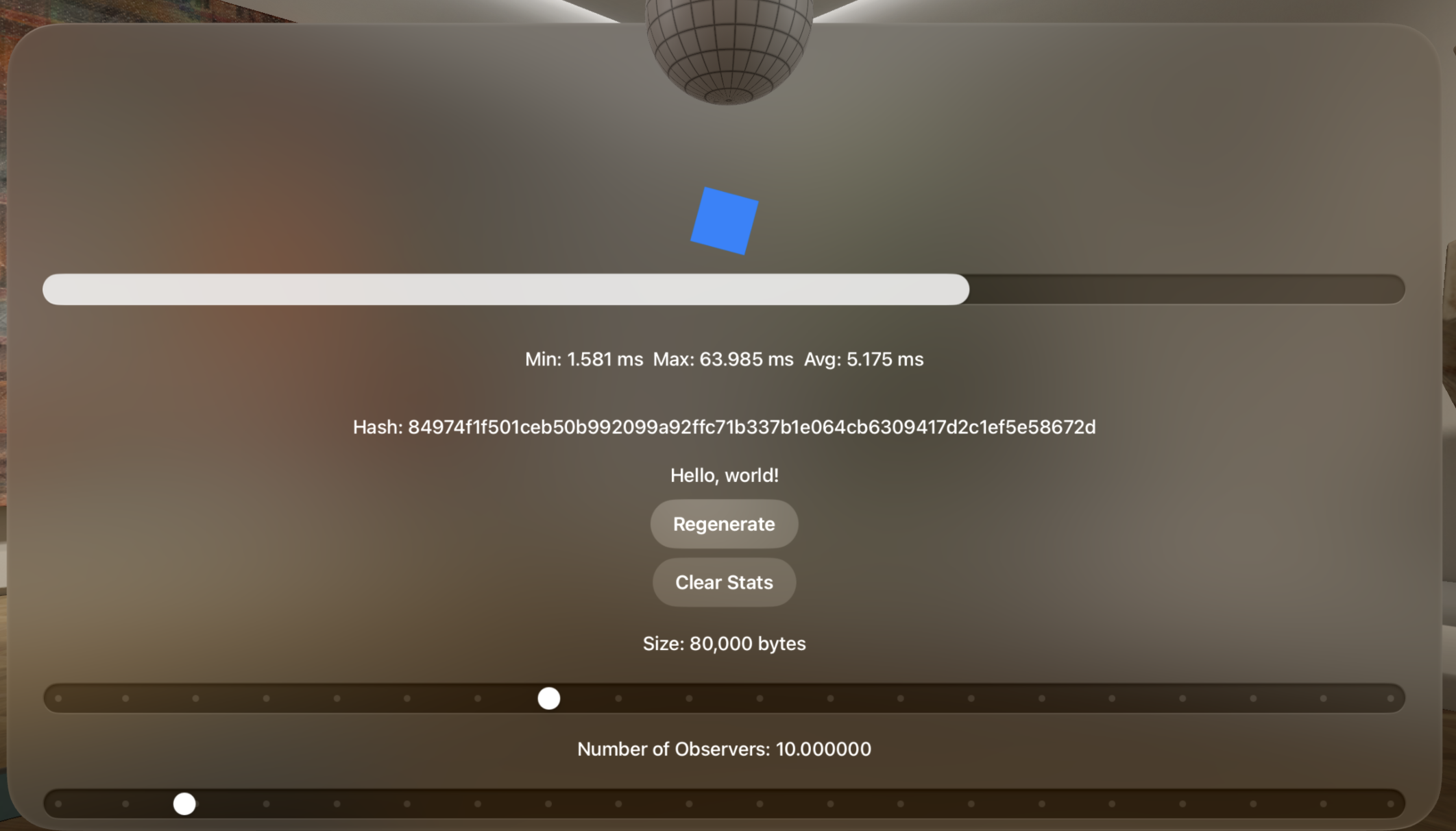

Shared a picture of the perf test app.
The 'regenerate' button rebuilds the published test structure.
And 'reset stats' clears the values.
