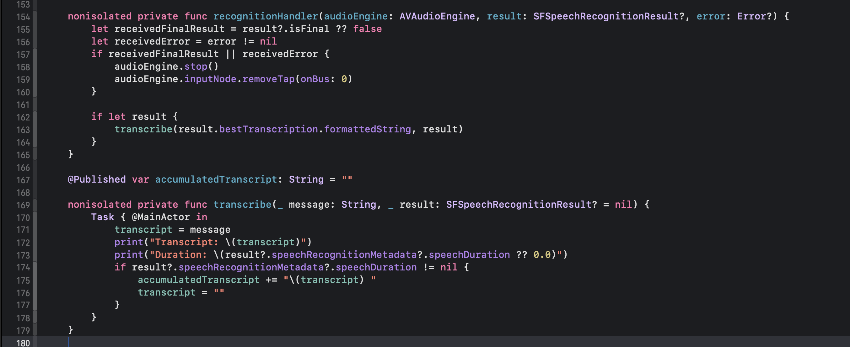

It looks like Apple has added some new API(s) to SFSpeechRecognition My app, which is currently listed on App Store does feature speech recognition. Yet, trying to use it under iOS 18.0 throws errors: -[SFSpeechRecognitionTask localSpeechRecognitionClient:speechRecordingDidFail:]_block_invoke Ignoring subsequent local speech recording error: Error Domain=kAFAssistantErrorDomain Code=1101 "(null)" What happens is that after several words are transcribed and displayed, the next sentence results in previous words disappearance. That's probably what that portion of the error text - "Ignoring subsequent local speech recording error: Error Domain=kAFAssistantErrorDomain Code=1101 "(null)" means. The problem occurs ONLY when the app is running under iOS 18.0 Even when it's compiled in Xcode 16.0 using iOS 17.5 everything works fine. Any suggestions?

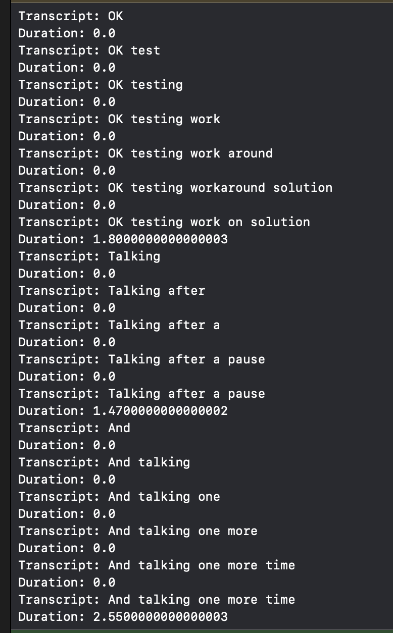

I may have come up with a solution for now. I closer into SFSpeechRecognitionResult -> SFSpeechRecognitionMetadata and saw that there was a variable 'speechDuration'.
Turns out that speechDuration will spit out how long the previous utterance was. And while speech is coming in it will default to nil. So with that, I created another published var "accumulatedTranscript" and checked to see if speechDuration != nil then append whatever the current transcript is, then reset the transcript to an empty string (to clear out the UI's text).

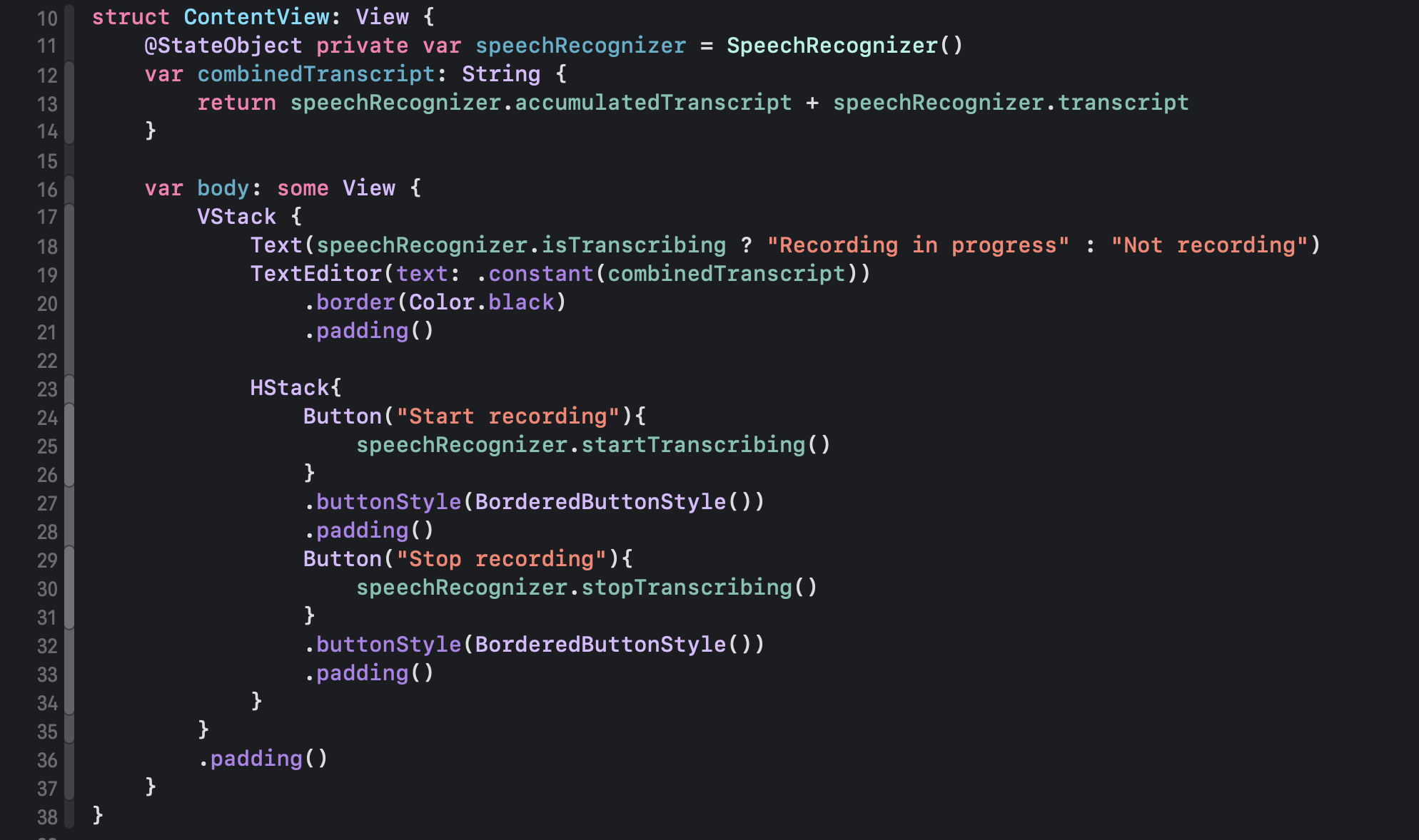

For the UI I'm using a combined var of accumulatedTranscript + transcript to give the appearance of a continuous stream of text. And from my screenshots you can see it will use the last transcript/final result that comes in after the pause
Some things worth noting:
  1. I haven't seen iOS17 display a non-nil speech duration so this solution shouldn't affect how iOS17 works but there may be some edge cases I'm not able to think of now.
  2. The new transcript appended will begin with a capital letter, you'll want to deal with this however you need to for your app (for me, I'll just make everything past the first word lowercase since the pause timer is finicky).
  3. I haven't done a robust test of this solution yet but I've tested on iOS18 simulator and physical device and iOS17 simulator only
  4. I'm not sure how this workaround will affect any changes Apple might make to address this so, you know, keep that in mind.
