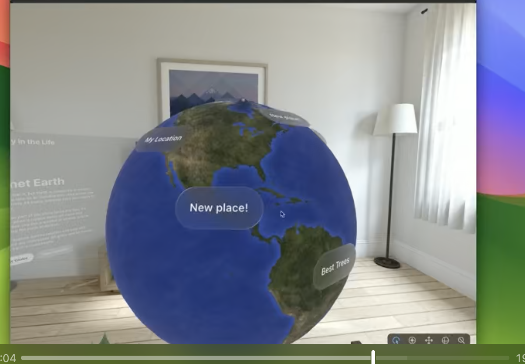

Thanks for your solution, but I need it to look like this. This is Apple's demo: 14:04

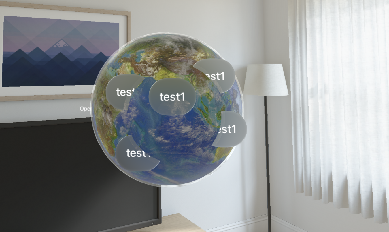

my update code: import RealityKit import SwiftUI import RealityKitContent
struct ImmersiveView: View {
@State var favoritePoint = [PointOfInterest]()
@State var earthEntity: Entity = Entity()
        RealityView { content, attachments in
            // Load the root entity from your RealityKit content bundle
            guard let rootEntity = try? await Entity(named: "Scene", in: realityKitContentBundle) else { return }
            content.add(rootEntity)
            earthEntity = rootEntity.findEntity(named: "Earth") ?? Entity()
        } update: { content, attachments in
            // Update logic if needed
            for place in favoritePoint {
                if let placeEntity = attachments.entity(for: place.id) {
                    earthEntity.addChild(placeEntity)
                    placeEntity.setPosition(place.location, relativeTo: nil)
        } attachments: {
            // Define attachments using the Attachment type
            ForEach(favoritePoint) { place in
                Attachment(id: place.id) {
                    Text(place.name)
                        .padding()
                        .glassBackgroundEffect()
                        .tag(place.id)
        .gesture(SpatialTapGesture().targetedToAnyEntity().onEnded({ value in
            let location = value.location3D
            let convertLocation = 1.1 * value.convert(location, from: .local, to: .scene)
            favoritePoint.append(PointOfInterest(name: "test1", location: convertLocation))
        .gesture(DragGesture().targetedToAnyEntity().onChanged({ value in
            value.entity.position = value.convert(value.location3D, from: .local, to: .scene)
struct PointOfInterest: Identifiable { var name: String var id: UUID = UUID() var location: SIMD3<Float> }
with result:
i deleted it
1.1 *
Hey @sevens ,
It seems like you're missing the line placeEntity.look(at: .zero, from: place.location, relativeTo: placeEntity.parent) This is what makes the attachments not collide with the earth like yours are
