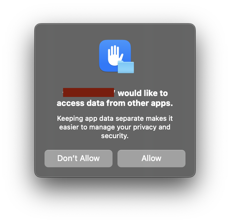

However when developing using the non-team prefixed app group name on macOS Sequioa I see the following alert every time I launch the app.
I have the App Group listed correctly in the entitlements file and if I change the app group name on macOS from group.com.example to (TEAMID).com.example then it works as expected so I think the rest of the setup is correct.
Looking at the Sequoia Beta release notes it states:
Specifically, the app must use FileManager to get the app group container path and meet one of the following requirements: the app is deployed through Mac App Store; the app group identifier is prefixed with the app’s Team ID; or the app group identifier is authorised by a provisioning profile embedded within the app.
I am using Xcode managed signing and looking at the provisioning profiles I can see that the iOS one includes the app group but the macOS one does not. I assume that if I could somehow get the app group correctly add to the macOS provisioning profile then all would be good.
But I am now stuck on how to get the app group added to the macOS provisioning profile. It seems whatever I try Xcode does not want to add it. Presumably this is because it expects you to instead use a team ID prefixed app group which would not need to be added.
Is there any magic I can do to make this work with automatic signing?
If not then how would I go about setting it up manually and is that the best solution?
