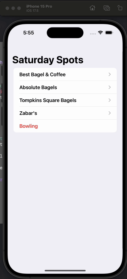

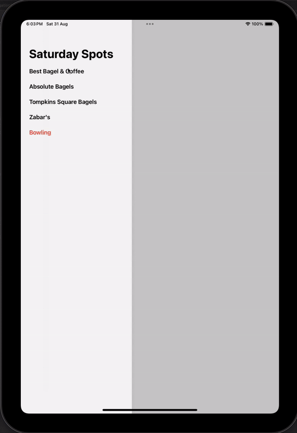

After a lot of trial and error, and gaining a deeper understanding of how NavigationSplitView, NavigationStack, and NavigationPath can work together, I came up with the following solution, that allows me to push a list onto an existing one, and use NavigationSplitView's detail: to push a detail. While this doesn't support recursive-lists (more than two levels deep), that's not a requirement for my usage.
The "trick" that I learned that allowed this to work, was to use NavigationPath within a NavigationStack in my NavigationSplitView sidebar, in order to push another list onto the detail.
In addition, the trigger of detail: in a NavigationSplitView is from the List(selection:) within the side-bar.
Because I am using the same Binding within both my List and its sub-list, the NavigationSplitView pushes the detail onto the highest stack.
Here's the final result. working on iPhone and iPad:
In order to push a LocationListView onto an existing one, I incorporated NavigationPath:
