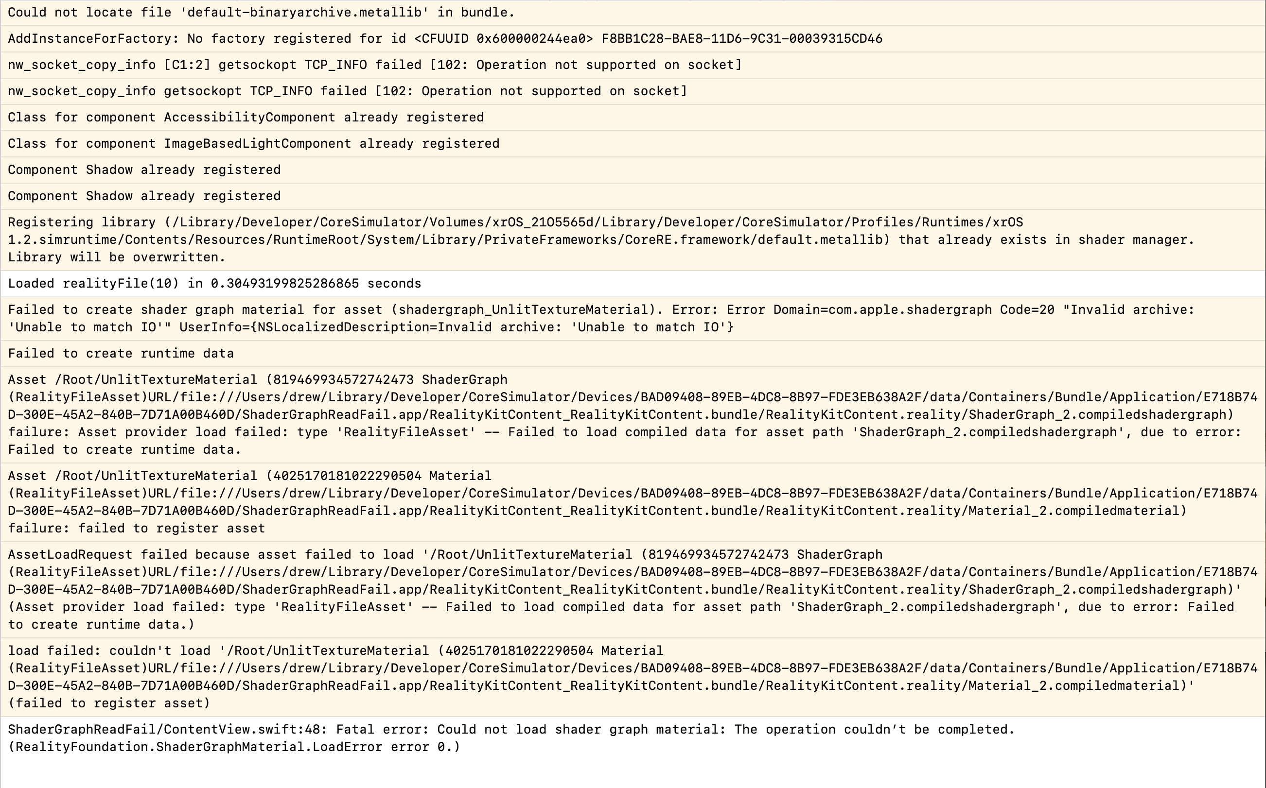

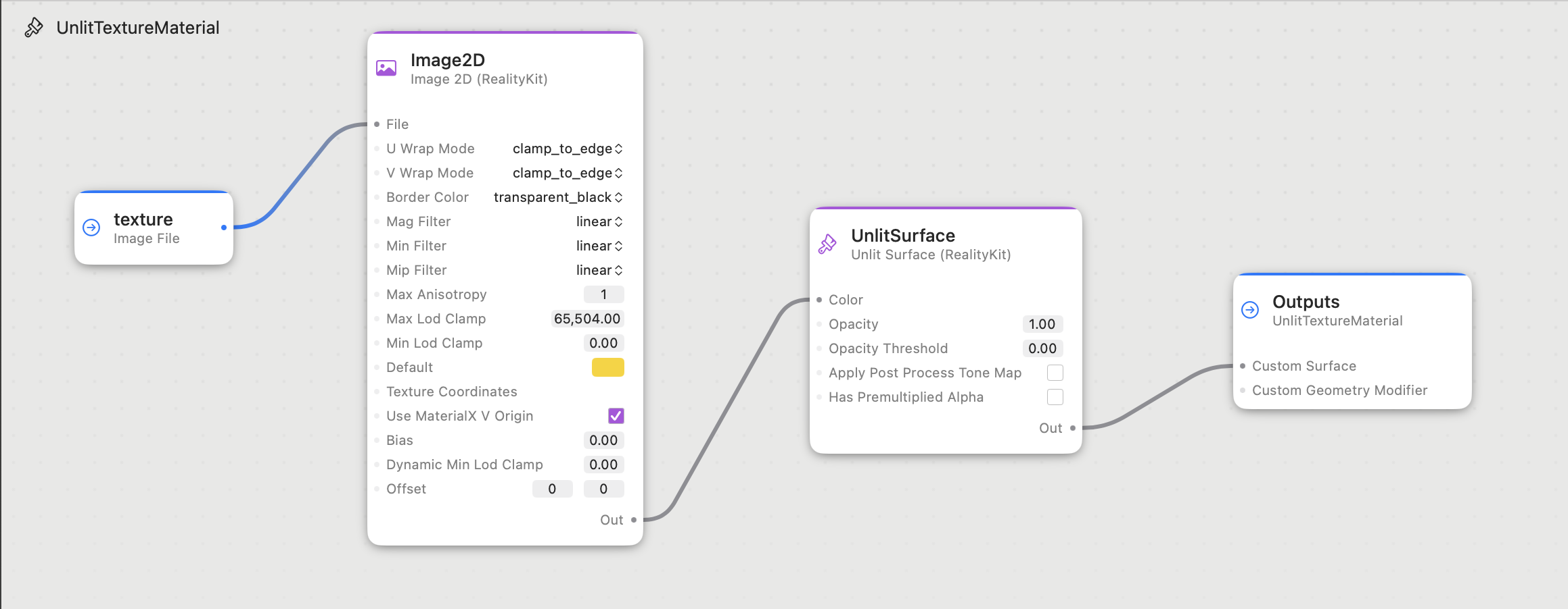

Using Reality Composer Pro 2.0, I created a simple shader graph that displays a texture on an unlit surface:
On visionOS 2 beta, I can successfully use ShaderGraphMaterial(named:from:in:) to load that shader graph material and assign it to a model entity.
However, on visionOS 1.2 and earlier, either in Simulator or on the device, ShaderGraphMaterial(named:from:in:) fails and I see the following logged to the console:
If, using Reality Composer Pro 1.0, I experimentally open the same project and delete and recreate exactly the same nodes above, then ShaderGraphMaterial(named:from:in:) works as expected on visionOS 1.2.

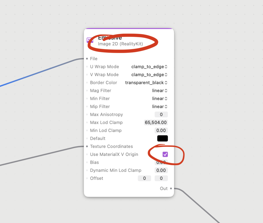

Yes indeed, using any nodes that are new in RealityKit 2.0, or using a new parameter on previously-existing nodes (like "Use MaterialX V Origin") will not be loadable on a visionOS older than 2.0.
As you've likely noticed by now, RCP currently does not alert you about this fact.
After more investigation, I think one possible cause of this issue may be the "Image 2D (RealityKit)" node type, and only if the new "Use MaterialX V Origin" parameter is enabled (or enabled and later disabled). It's possible other node types or parameters are affected as well.

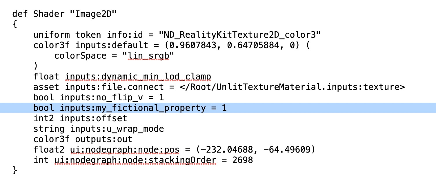

I did a test and hand-edited a USDA file to include a fictional future visionOS 3.0 shader node graph property, to see how RealityKit responds to this scenario on visionOS 2.0:
On visionOS 2.0, ShaderGraphMaterial(named:from:in:) fails with the same error that is currently returned on visionOS 1.0:
The operation couldn’t be completed. (RealityFoundation.ShaderGraphMaterial.LoadError error 1.)
(although curiously it returned error 1 that time instead of error 0)
So, it would seem that unless changes are made, we'll experience this problem again next year with Reality Composer Pro 3.0, which will blindly output shader graph nodes that can't be read by visionOS 2.0.
