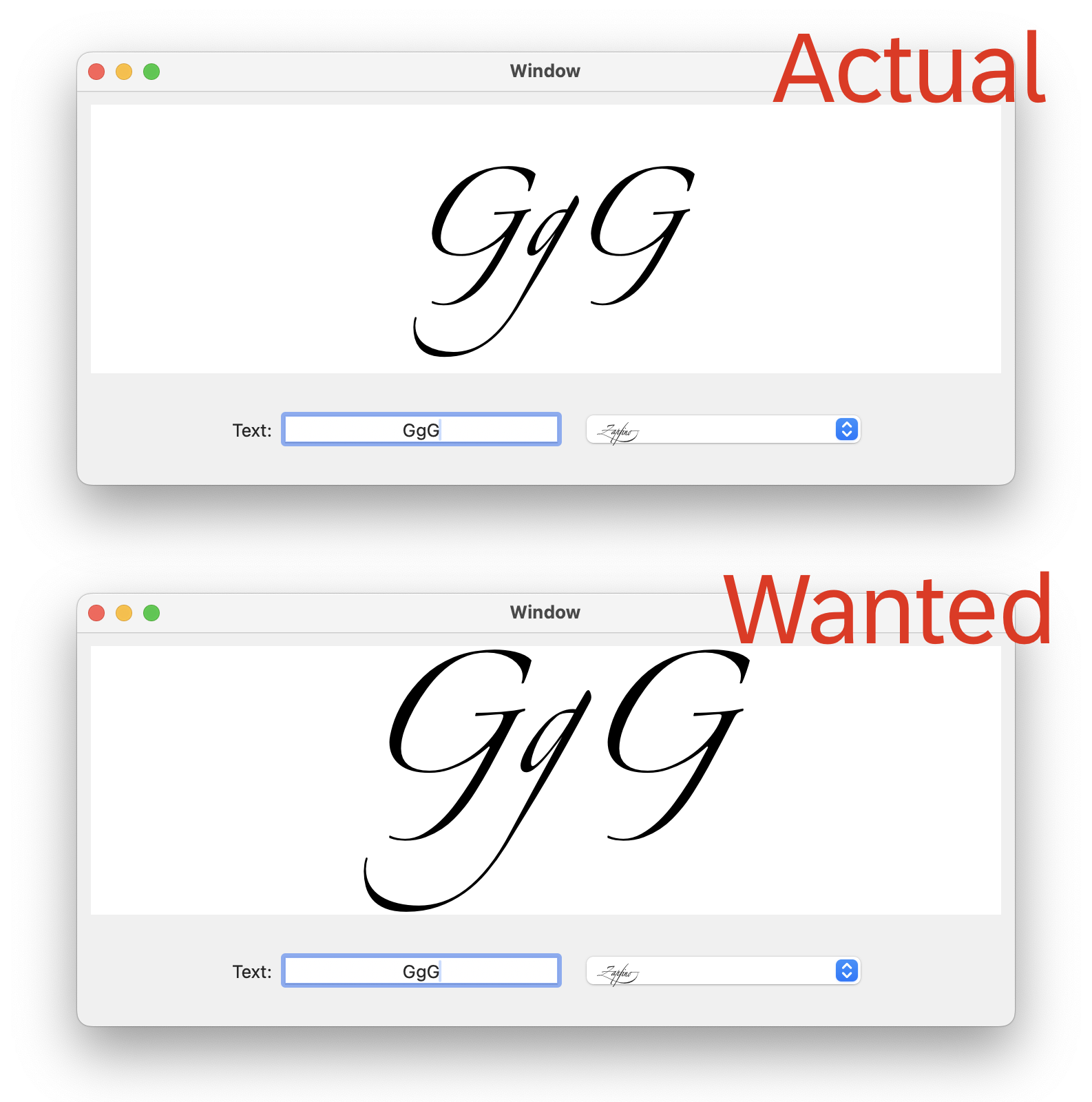

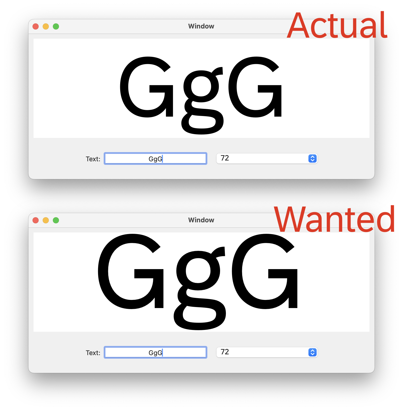

The string rect is a bit smaller than the rectangle of the view it should be drawn into. So I wonder why the string is cut off. With upper and lower case characters it looks like this:
Any idea? Thank you very much.

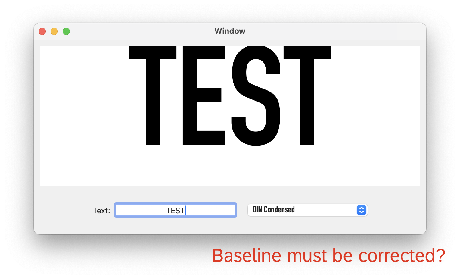

Ok. I think I also have to use Core Text for drawing the string. Right? Would be something like CGContextShowGlyphsAtPositions a good way to go?
This is what I have so far:
CTLineRef line = CTLineCreateWithAttributedString((CFAttributedStringRef)self);
if (line) {
CGContextRef context = [[NSGraphicsContext currentContext] CGContext];
CTLineDraw(line, context);
CFRelease(line);
Looks quite good…
Just have to figure out how to align it horizontally and vertically in the rect.
Ok, I figured it out. The following code gives me the correct bounds of the attributed string:
- (CGRect)typographicBounds
CGRect usedRect = CGRectZero;
if (line) {
usedRect = CTLineGetImageBounds(line, context);
CFRelease(line);
return usedRect;
and the following code draws it exactly into the view:
NSRect stringRect = [_attributedString typographicBounds];
// draw the string
CTLineRef line = CTLineCreateWithAttributedString((CFAttributedStringRef)_attributedString);
if (line) {
