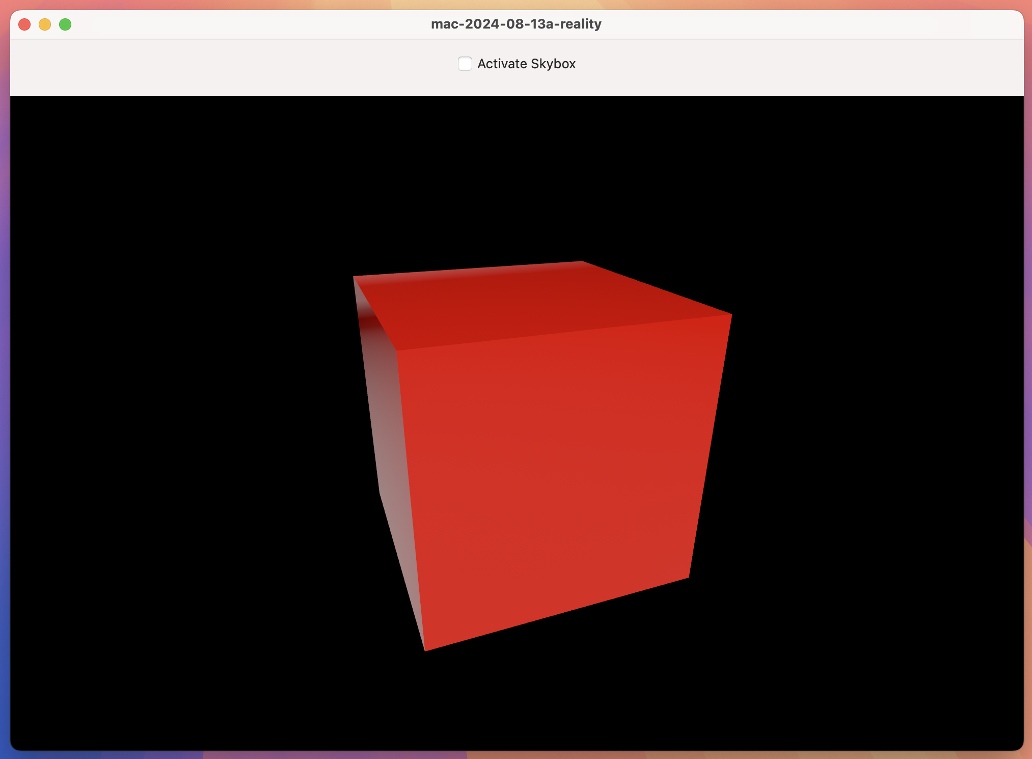

I am testing RealityView on a Mac, and I am having troubles controlling the lighting.
I initially add a red cube, and everything is fine. (see figure 1)

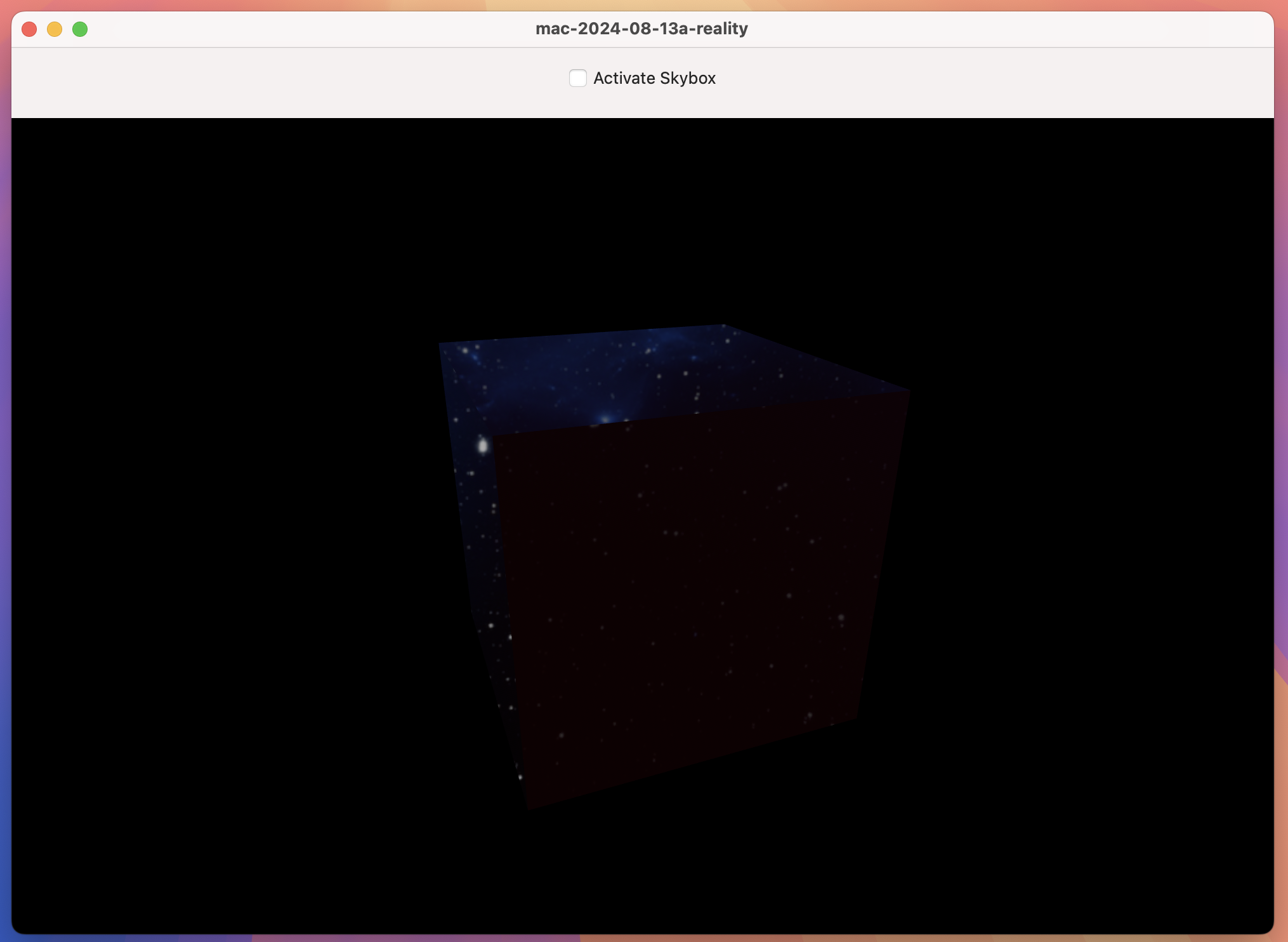

I then activate a skybox with a star field, the star field appears, and then the red cube is only lit by the star field.

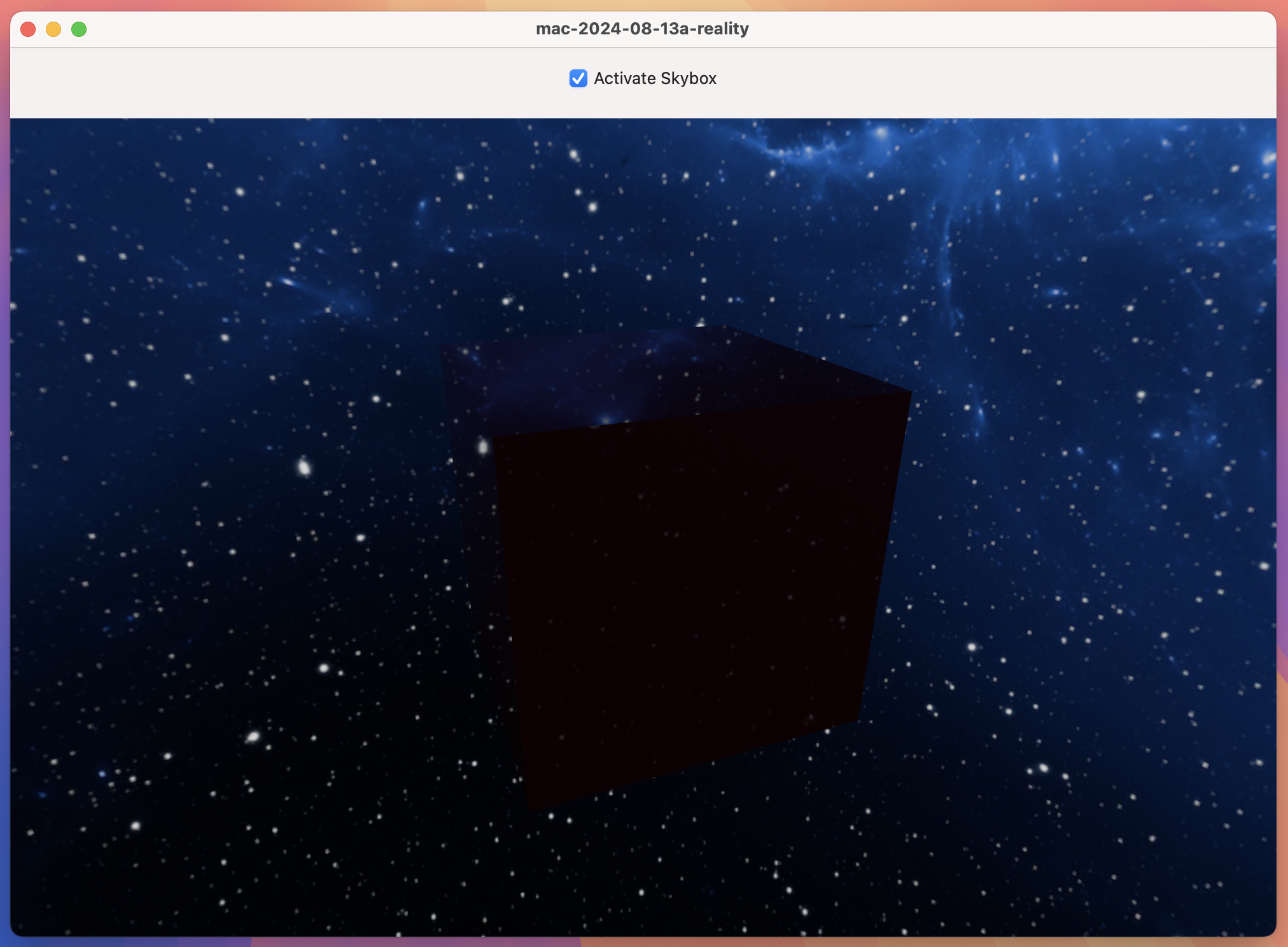

Then I deactivate the skybox expecting the original lighting to return, but the cube continues to be lit by the skybox. The background is no longer showing the skybox, but the cube is never lit like it originally was.
Is there a way to return the lighting of the model to the original lighting I had before adding the skybox?
I seem to recall ARView's environment property had both a lighting.resource and a background, but I don't see both of those properties in RealityViewCameraContent's environment.

Figure 1 (default lighting before adding the skybox):
Figure 2 (after activating skybox with star field; cube is lit by / reflects skybox):
Figure 3 (removing skybox by setting content.environment to .default, cube still reflects skybox; it is hard to see):

I have found a different approach that works for me. I have abandoned setting the content.environment property and use a sky dome model for the background and use ImageBasedLightComponent and ImageBasedLightReceiverComponent to choose the lighting for the cube.
For more information on this approach, see WWDC session Optimize your 3D assets for spatial computing, and jump to sections
  • 15:07 - Sky dome setup
  • 16:03 - Image-based lighting
I did everything programmatically (instead of using Reality Composer Pro), but it pretty much works the same.
