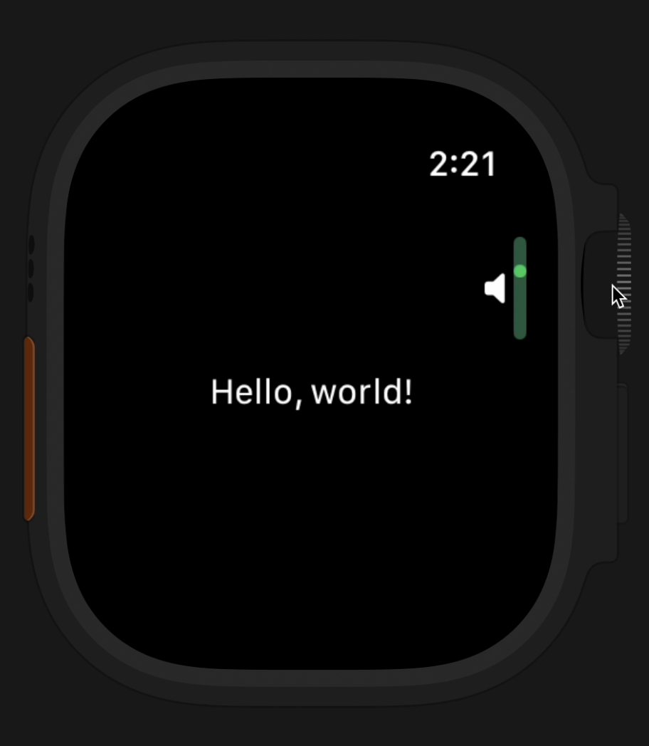

After reading the documentation on .digitalCrownAccessory, I am under the impression that the system should know to show your accessory and hide your accessory according to whether the crown is being rotated. I have noticed this is not the case. I have also tried a few work arounds with no luck. Here is a simplified version of my code. I have recorded a video of the issue I am seeing, but I can't upload it, so I have attached some screenshots instead.

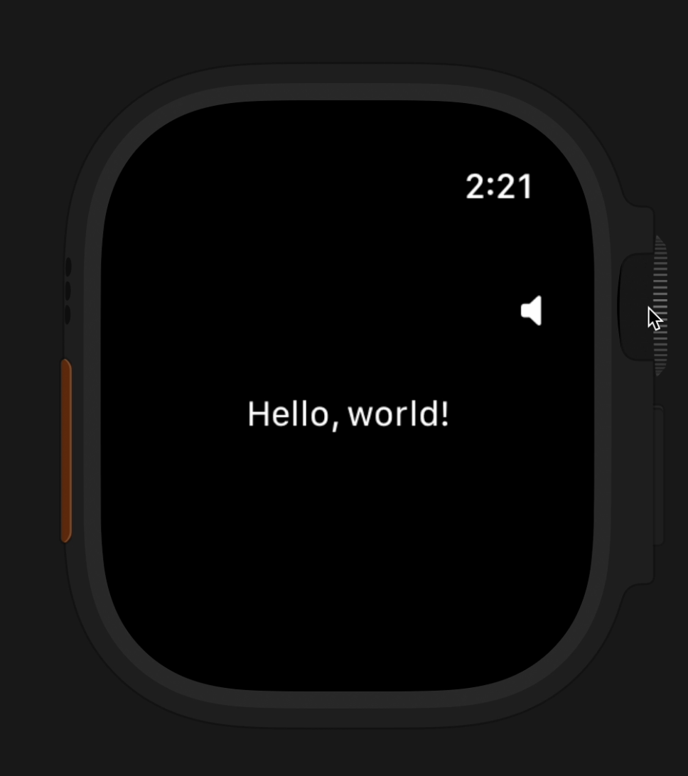

Expected result: After rotating the crown, the accessory image should disappear along with the vertical system scroll bar.
Actual result: After rotating the crown, the vertical system scroll bar disappears but the accessory image stays behind.
Versions: Sonoma 14.6.1 Xcode 16 Beta 5 (and Xcode 15.4) Apple Watch Ultra 2 watchOS 11 (device and simulator)

Images: Scrolling: Speaker wont go away:
Hi, Yeah it seems to be pretty buggy. For example, animations don’t work and .onChange does not get called. I solved it by using .overlay and manually position the view.
