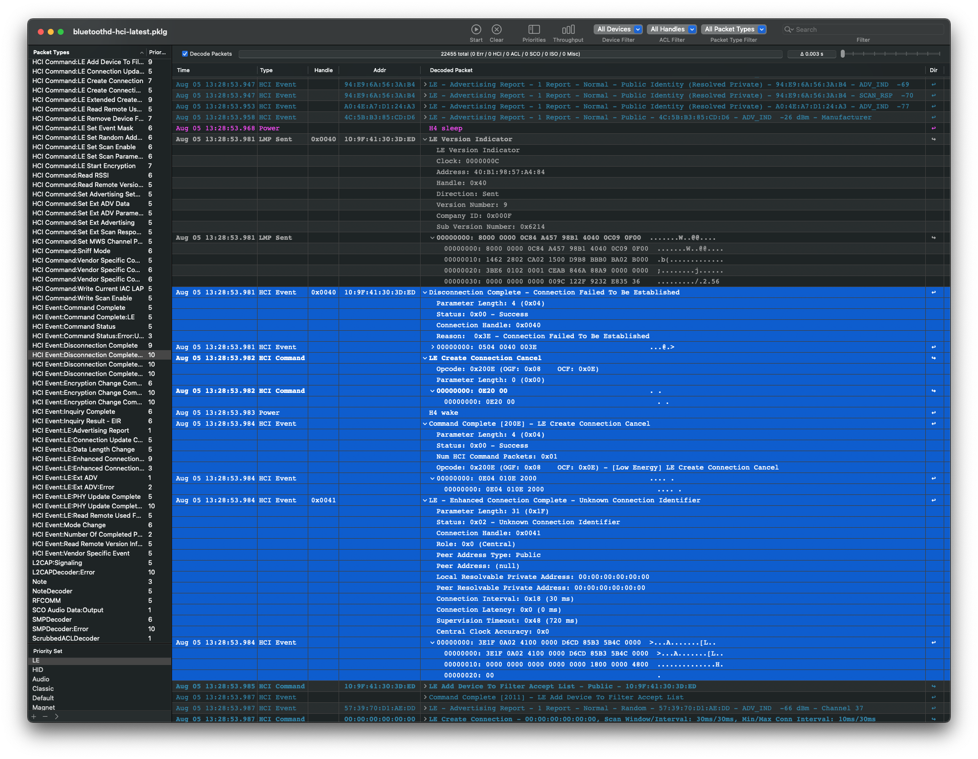

Hi Argun, thanks for your thorough answer!

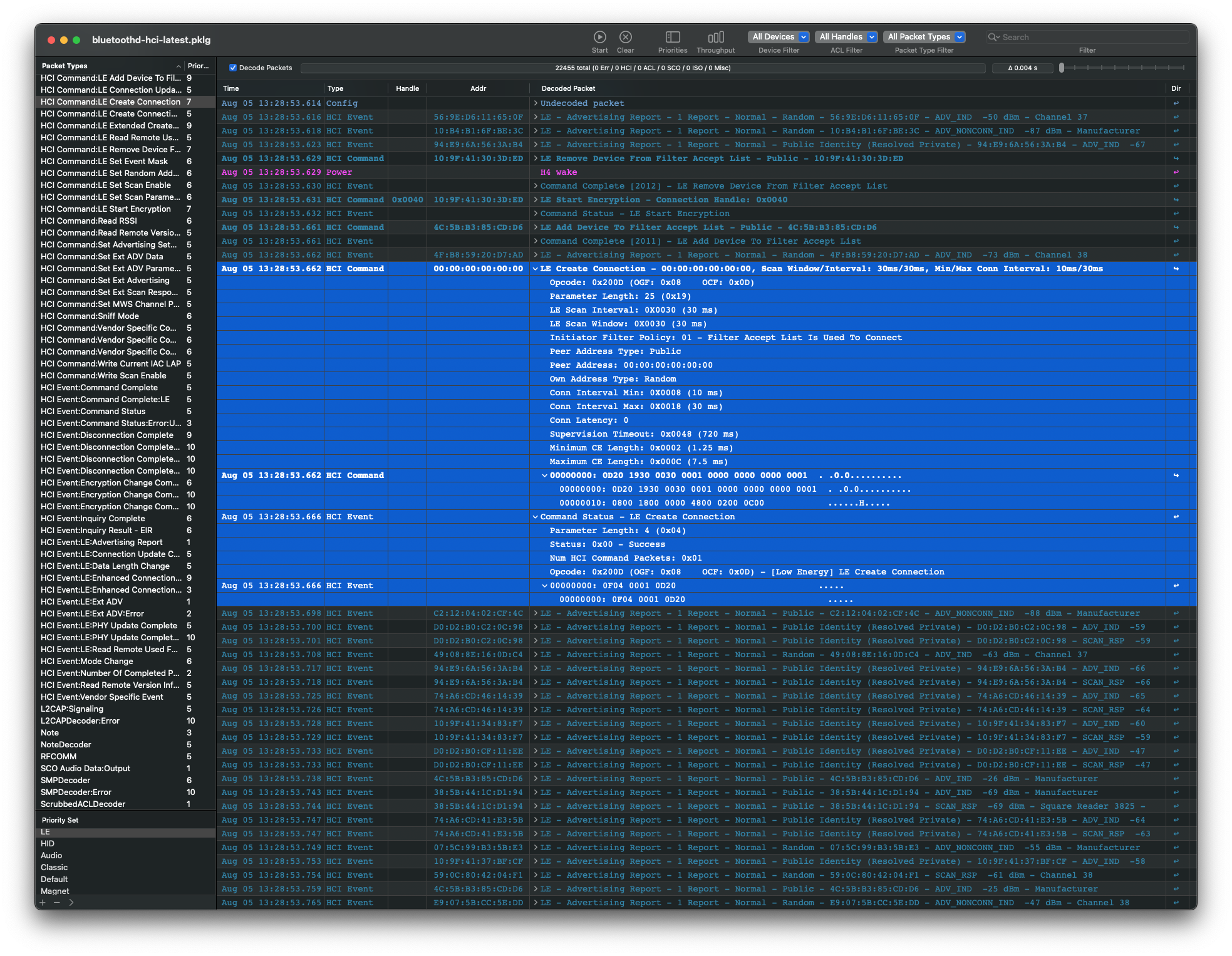

The BLE HCI logs looks like this:
The highlighted portions are the relevant logs. The connection complete event also shows Unknown Connection Identifier!
A few question:
  1. Do the parameters to the LE Create Connection command look good?
  2. Do you know why I'm seeing "Disconnect Complete - Connection failed to be Established?" The HCI logs immediately shows the disconnection after the create connection command without more context. Could an error be happening at a lower level? Is there a way I could get more detailed logs to understand this disconnect?
The LE Create Connection definitely does not look good.
For starters, the address is 00:00:00:00:00:00 which is not correct.
Then I am looking at the connection parameters, which are also incorrect.
As stated in the Accessory Design Guidelines for Apple Devices
Connection parameter requests may be rejected if they do not meet the guidelines in this section. General connection parameter request guidelines:
  • Peripheral Latency ≤ 30 connection intervals.
  • Supervision Timeout from 6 seconds to 18 seconds.
  • Interval Min ≥ 15 ms.
  • Interval Min ≤ 2 seconds.
  • Interval Min is a multiple of 15 ms.
  • One of the following:
    • Interval Max at least 15 ms greater than Interval Min.
    • Interval Max and Interval Min are both 15 ms.
  • Interval Max * (Peripheral Latency + 1) of 6 seconds or less.
  • Supervision Timeout greater than Interval Max * (Peripheral Latency + 1) * 3.
Normally iOS would respond with an alternative set of connection parameters, so there could be something fundamentally wrong with the request. Perhaps it is the address, I can't be sure.
In any case this sounds like something you need to debug and take care of at your peripheral's side.
There are no lower level logging available from the iOS side. You might be able to find some more details with a Bluetooth sniffer, but I am not sure if you actually need to go any lower than this. What we see here is enough to show the problems. Once you refer to the guidelines above and make sure the BLE protocol is also correctly implemented, things should work better.
