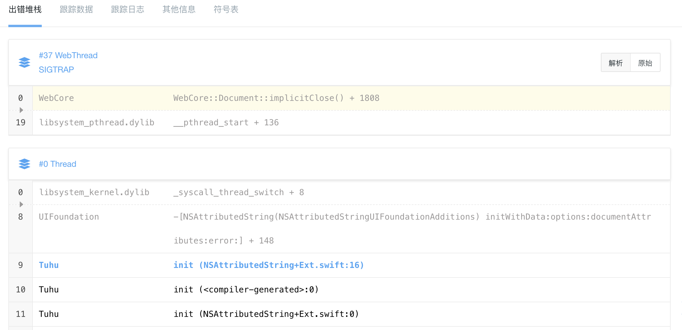

  1. try self.init(data: data, options: [.documentType: NSAttributedString.DocumentType.html], documentAttributes: nil)
html to NSAttributedString crash

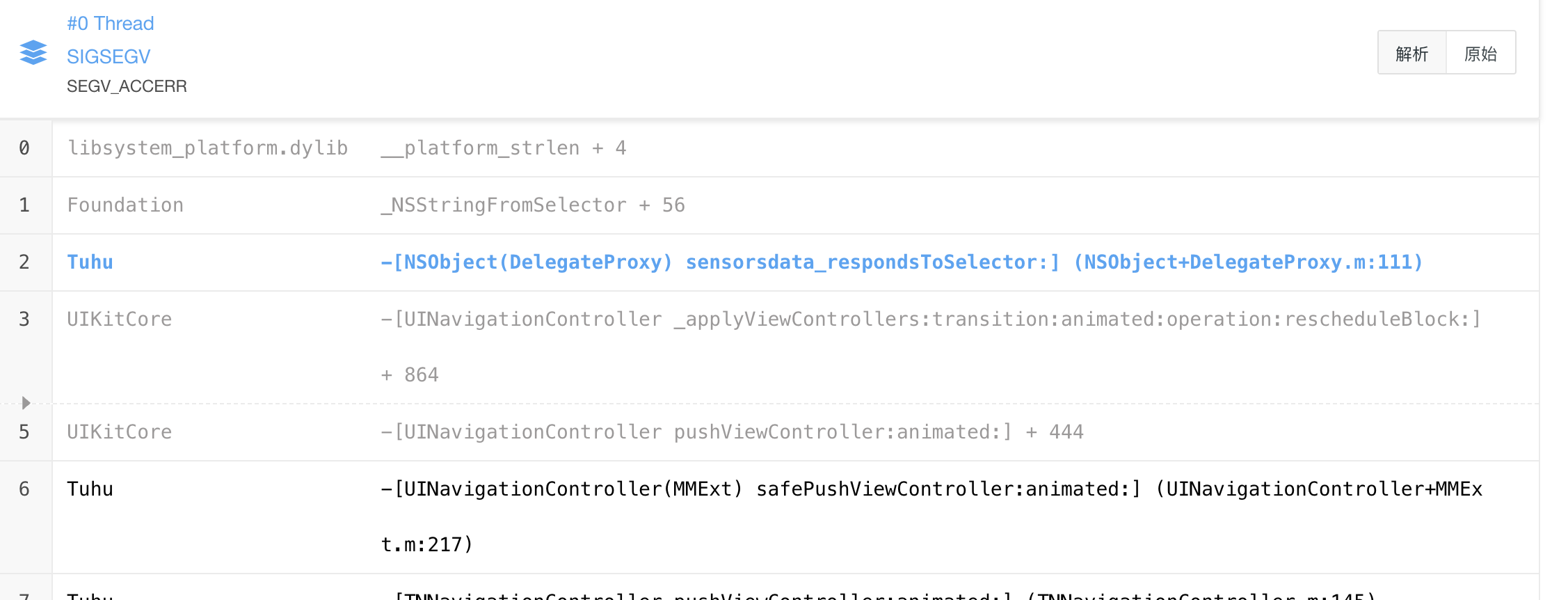

we used Bugly to find crash in our APP, we can get some crash Image or log for you,for example:
  1. html to NSAttributedString crash , 18.0 (22A5326f)
  1. UINavigationController setViewControllers:animated: , this function use ViewControllers like remove or add ,iOS18.0 (22A5326f)
  1. the same like second problem,
NSStringFromSelector find the selector is empty String, so is crash
Recently, our application has this crash too,how can i fix it
so , what can I do for our APP ?

问题二 -[NSObject(DelegateProxy) sensorsdata_respondsToSelector:] 这个是神策SDK的函数,去他们网站更新到最新SDK就能解决Crash问题了
I've had this problem too, but I've solved it. Let me help you.
Add it to the main thread, and the sample code is as follows
NSMutableAttributedString *attibuteStr = [[NSMutableAttributedString alloc] initWithString:self];
    dispatch_async(dispatch_get_main_queue(), ^{
        NSString *htmlString = [NSString stringWithFormat:@"<html><body> %@ <font size=\"%f\"> </body></html>",self,size];
        NSMutableAttributedString *attibuteStr = [[NSMutableAttributedString alloc] initWithData:[htmlString dataUsingEncoding:NSUnicodeStringEncoding] options:@{NSDocumentTypeDocumentAttribute: NSHTMLTextDocumentType} documentAttributes:nil error:nil];
        attibuteStr = attibuteStr;
    return attibuteStr;
