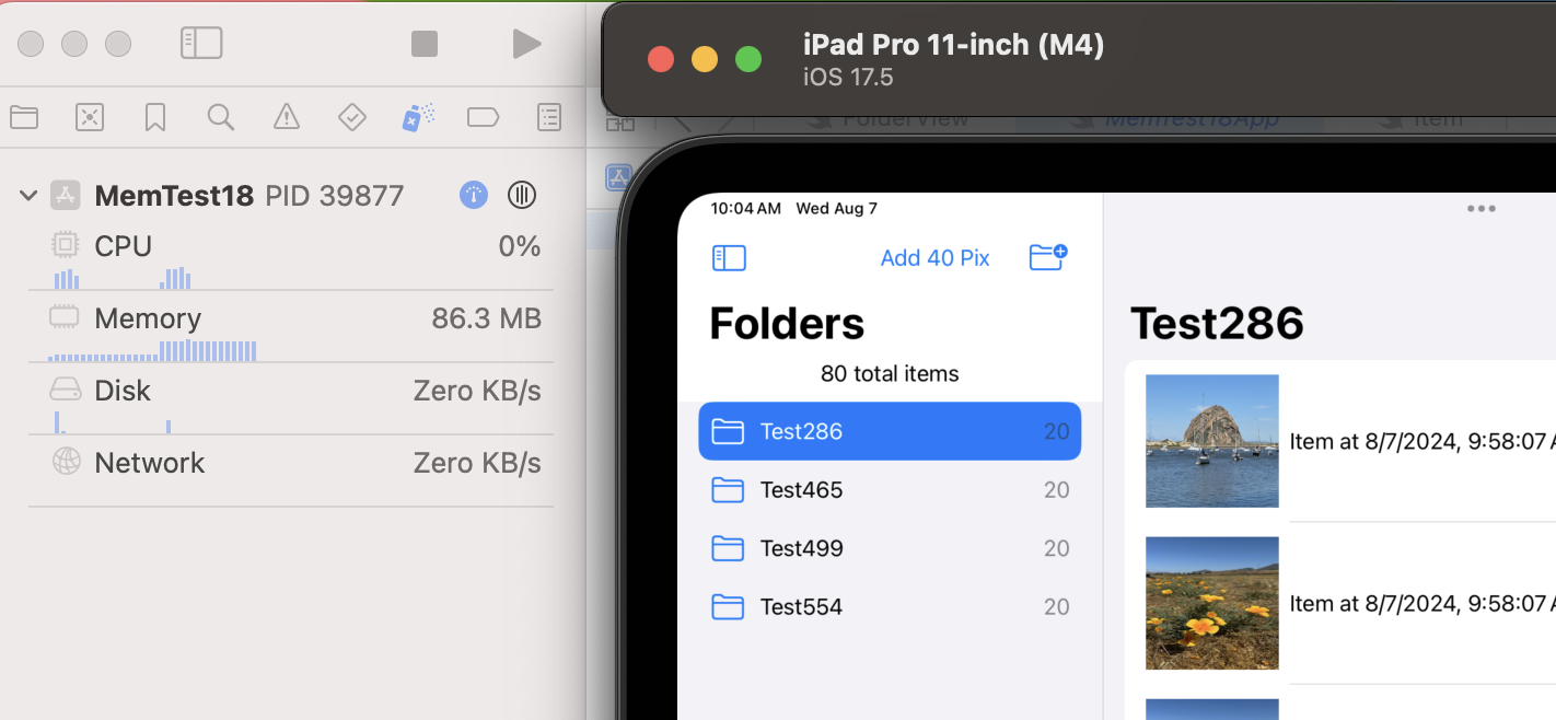

I've written a test app that demonstrates the extreme difference in memory usage between the OS Versions. It uses a typical navigation pattern, with content counts on the left-side view. Each item has one thumbnail and one large image in .externalStorge. GitHub Source

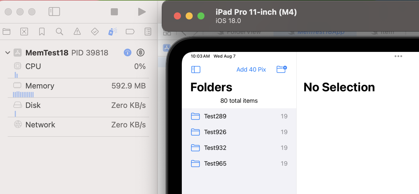

When populated with 80 items, each containing one thumbnail and one large image in .externalStorge, the app launches in 17.5 using 29mb of memory. On iOS 18, in the same conditions, 592 mb.

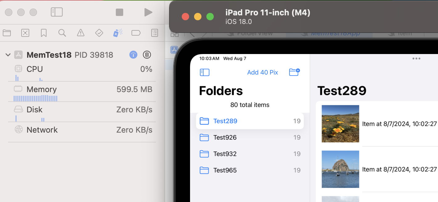

When the first folder is selected, causing a list of thumbnails to load, iOS 17 uses just 86mb. iOS 18 uses 599mb, implying that all image data has already been loaded.
