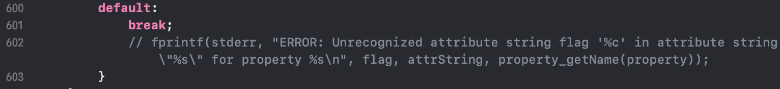

Oh, there is also an fpritntf that actually generates this output in MTLEXTRuntimeExtensions.m, starting at line 601. You can comment that out or delete it and change it to a "break;" statement, like this:
Thanks, drewster! That fixes it, both ways (in my code and/or patching it in Mantle's code). Much appreciated!
