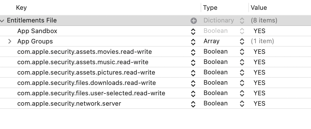

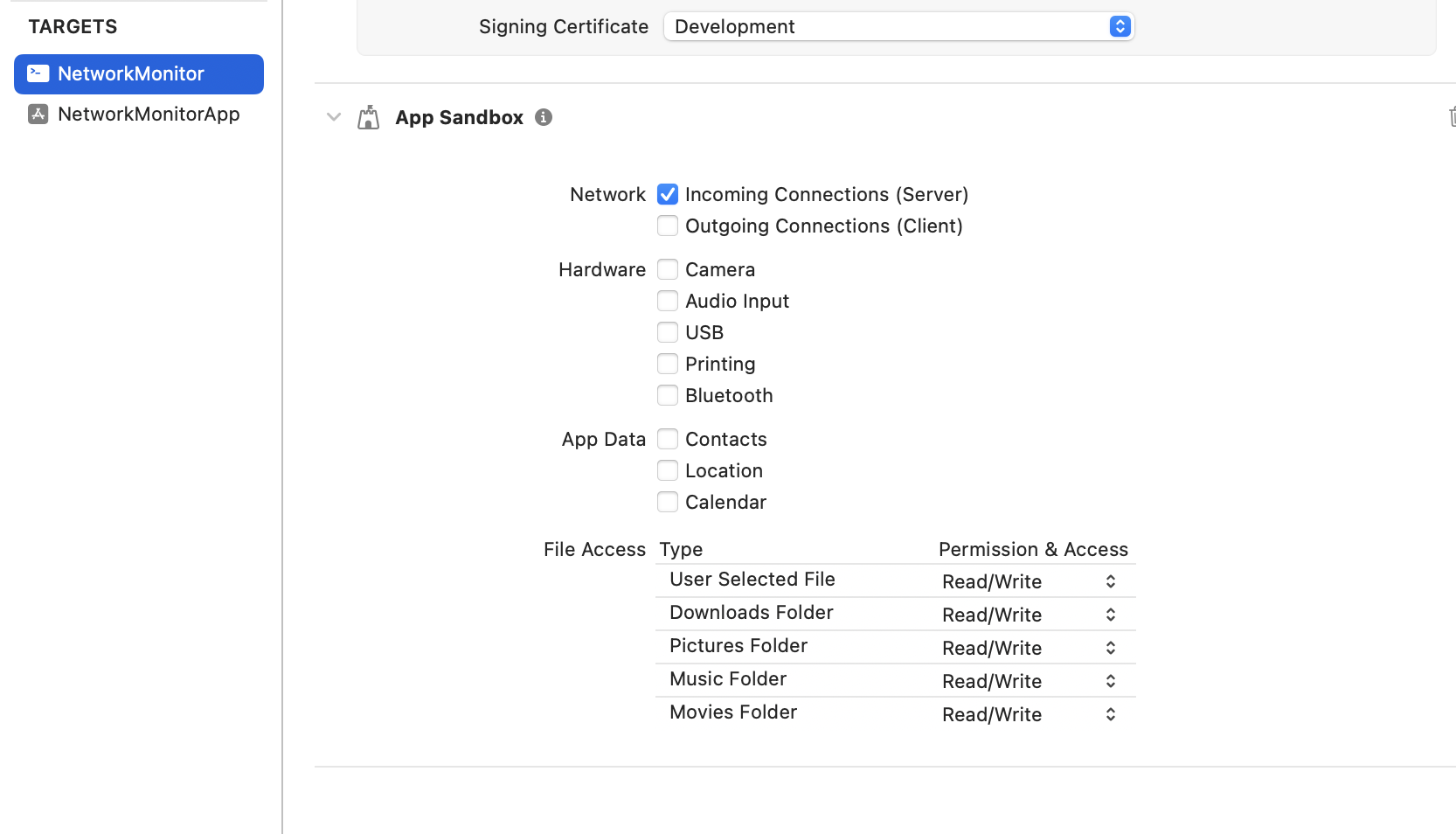

Why SMAppService.register() is not popping the request for user authorisation I sandboxed both App and daemon.
I tried both ways In a sandboxed app and daemon and once without sandboxing.
