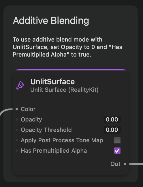

You can also use additive blending when you create a shader graph material in Reality Composer Pro. To do this, set Opacity to 0 and "Has Premultiplied Alpha" to true in your UnlitSurface node:
