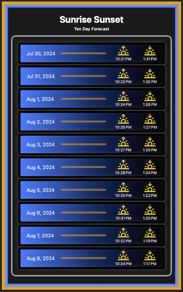

My resultant code views ::
Calgary
Paris

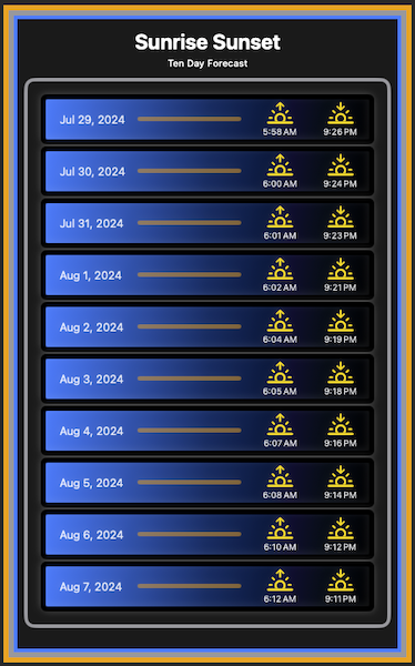

The revised Paris Sunrise and Sunset displays the correct times :

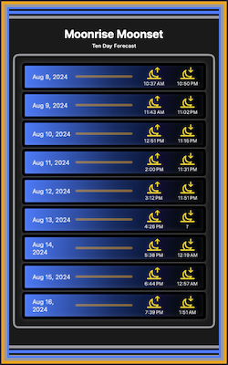

As a side note, changing the [sun.sunrise?] to [moon.moonrise?] and [sun.sunset?] to [moon.moonset?] affects the Moon Phase too ... :]
Paris Sunrise Sunset ::
Paris Moonrise Moonset ::
