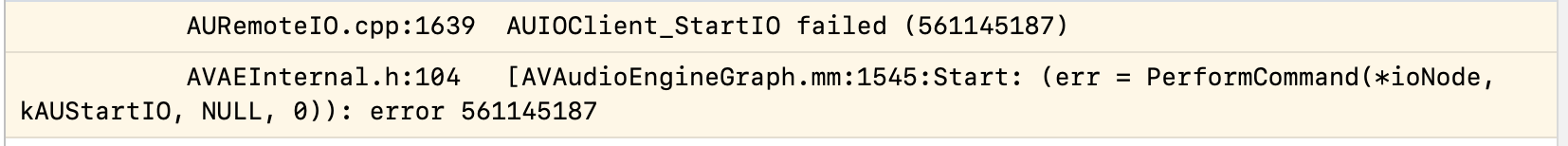

On the try audioEngine.start() call, I receive error code 561145187 in the catch block.
Logs/Error Messages:
•	Error code: 561145187
Request:
I would appreciate any guidance or solutions to ensure the app can resume recording after interruptions and background transitions without requiring a restart.
Thank you for your assistance.

Error code 561145187 (!rec) corresponds to AVAudioSession.ErrorCode.cannotStartRecording. It usually happens when trying to start a recording while the app is in the background. If the error is being produced while the app is in the foreground, there could be something else going on.
If your app received a mediaServicesWereResetNotification, for example, you need to:
Respond to these events by reinitializing your app’s audio objects (such as players, recorders, converters, or audio queues) and resetting your audio session’s category, options, and mode configuration.
It is also important to register for the AVAudioEngineConfigurationChange notification. Although your app might not need to reallocate its audio engine, it will likely need to reestablish any node connections if the formats have changed.
I have the same issue. I'm recording using AVAudioEngine, I listen for interruptions. If a call come in and its answered, then hangs up, I can't restart the recording. I think the audio input changes to the phone app and I can't seem to get it back when returning to my app. I would rather not have to recreate the whole engine if possible.
