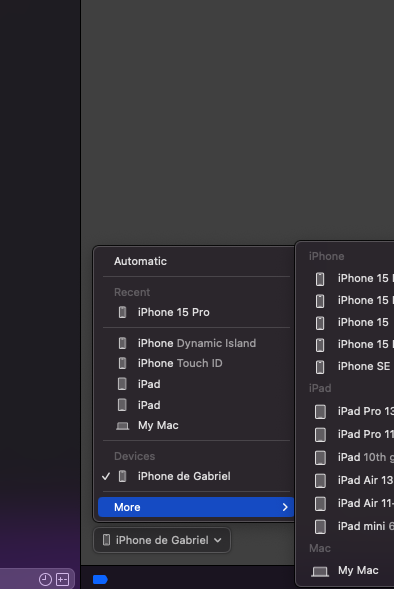

Hi, I'm sorry if my question is Hello, I apologize if my question seems worthless to you.
I'm just starting out, it's my first day as an apprentice learning this programming language, and I don't have any community or mentor to help me.
I searched for my answer in the Forum but couldn't find a solution, so I'm asking my question here.
How can I, at the start of a project, choose an emulator device that includes other iPhones besides the 15 and 13? I'm looking for the iPhone 14.
I'm currently using Xcode version 15.4.
Thank you for your attention to my question. Have a great day.
Answered by DTS Engineer in 799369022
You can add additional simulator destinations — see Configure the list of simulated devices in the documentation. Once you create an additional simulator destination, it will appear in the More menu you show in your screenshot.
